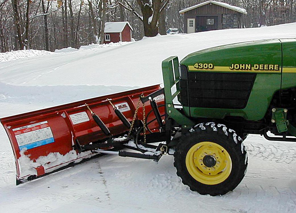

I don't like looking back while pushing a rear blade, or driving over snow to pull a rear blade. I put this Western plow on my 4300 and it works GREAT! Not as cheap, but many times better. It quickly detaches if I want or need to put on the FEL. Pic shows the plow and the quicktach that I designed and had fabricated. The quicktach stays with the plow, hooks onto the MMM plates, pivoting up to take two bolts through the weight bracket on the front. So other than the hose connections, it is just two bolts to deal with.

That looks great! It looks a bit bigger than the 12" high one Deere sells?
Thanks....
Bob

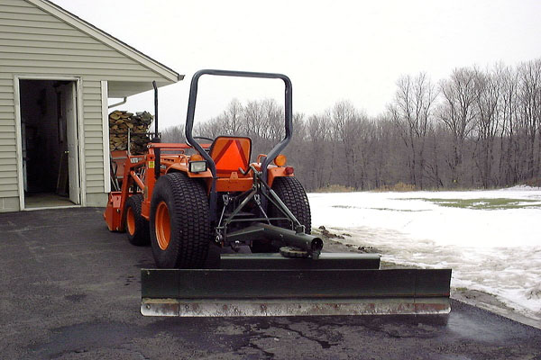

   / Rear vrs. front blades #6
Hi Bob,
I'm in Fairport, NY so I can tell you what has worked for me. In the past I have used an 8 ft. rear blade to clear my driveway and an almost full size ice rink. This year when I got my new to me tractor it came with a 5ft. rear snow blower, but as you know I haven't had a chance to try the snow blower yet! I have used the rear blade for lots of grading jobs and it makes one hell of a counter-weight for the FEL. Here is photo of the beast! It is an old one but I couldn't bend it if I tried. I plow the snow going backwards, and pull it to do the grading.
Thanks, Von..
That looks like a solid blade alright!
Don't you have a sore neck after plowing an entire skating rink going backwards??
Bob
   / Rear vrs. front blades #8
That's what mirrors are for. Just kidding. About the only thing I do with my mirrors is wash the mud and other stuff off them and push them back out into positiin after limbs shove them over the doors. We had snow for a couple days and traffic slowed a mite but it is 99% gone now as it has been above freezing for a few nights and mid 60's during the day.
I too have never had a back blade (not counting box blade) but will get one soon. They are really cheap compared to the fancy one on the front of the picture of the JD a coupe posts back. If I Ihad to plow all that snow and didn't comit suicide I would want a front blade for sure.
Patrick
   / Rear vrs. front blades #9
Bob,
It goes pretty fast with such a wide blade and I don't have to look back that much, as I sit sideways in the seat as much as I can.
