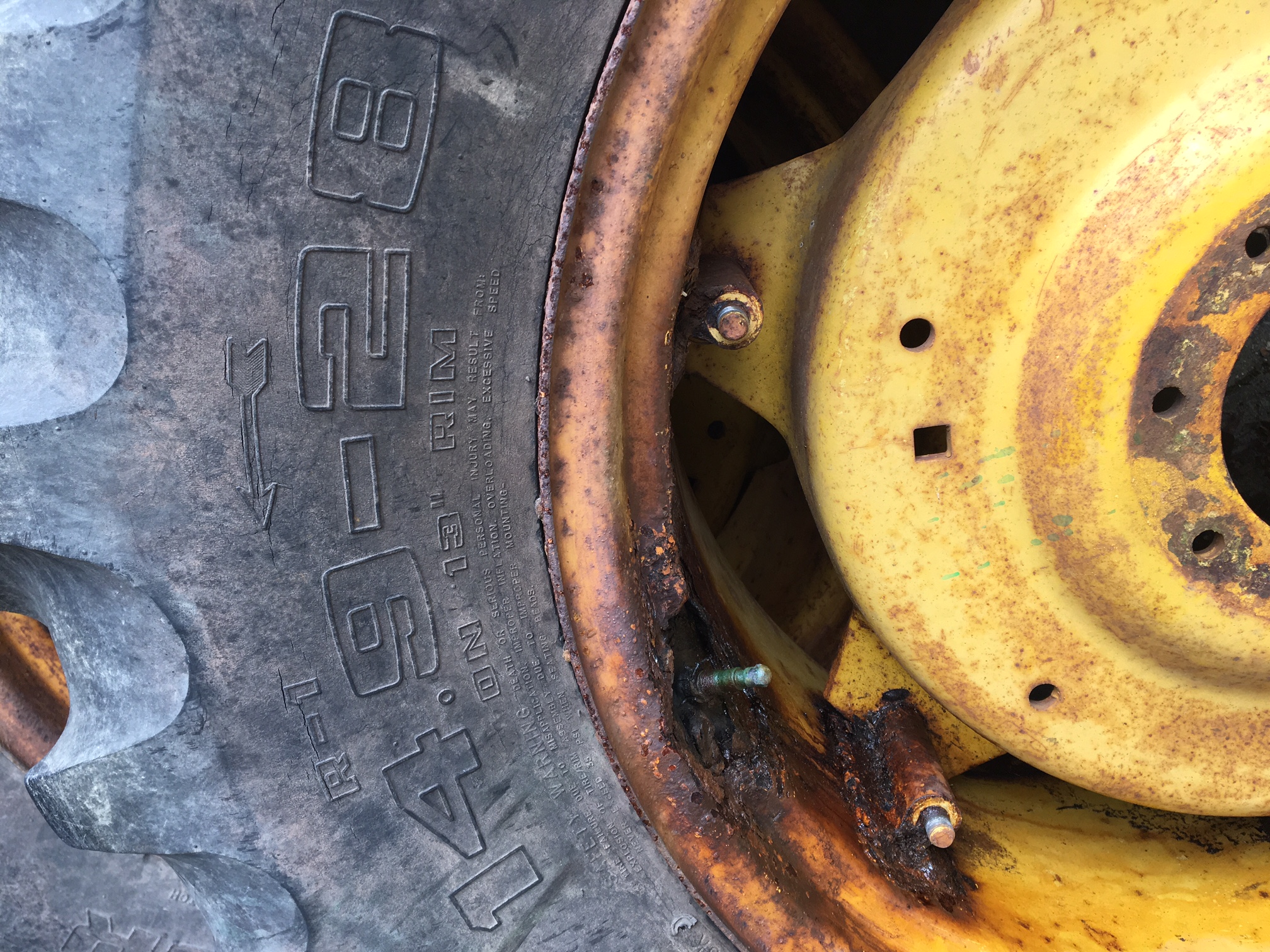

The wheels on my 2040 are it fairly rough shape and now starting to leak. They are filled and both very rusty around the valve stems. Tires are in decent shape. I use the tractor for hobby stuff. Right now that's just loader work...and a fun father-son project to fix up. The current tires are 14.9 - 28. Wheels are 6 loop and I'm guessing 13". I was hoping to track down some used wheels and save the trouble of patching the old ones. While I want to improve my welding skills, there are probably better projects to focus on.

Wasn't able to go pick up those used tires and wheels before they were sold to someone else. I think I was measuring the rims wrong and believe I have 12", not 13". The part that confuses me is that my tires are printed with "14.9 x 28 on 13" rims". Am I correct that 14.9x28 could be mounted to a 12" rim?
On a different point, I can't get the center off the old rim. These things are packed with rust. I've whacked them pretty well with a hammer and they won't budge. Where am I going wrong?

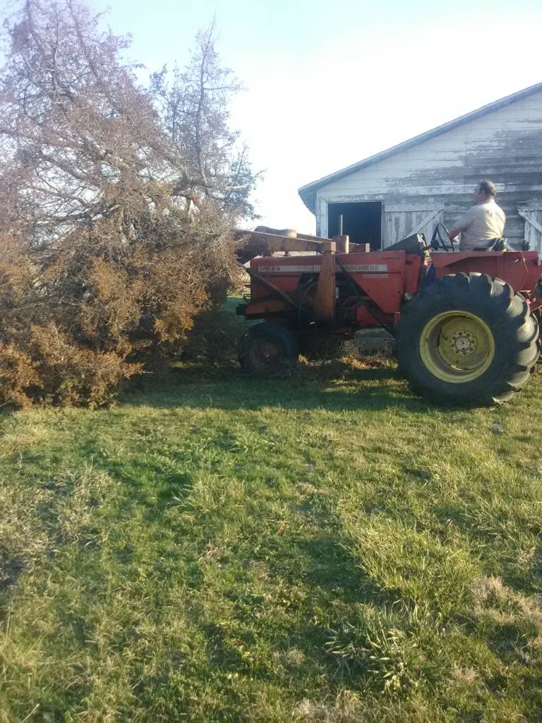

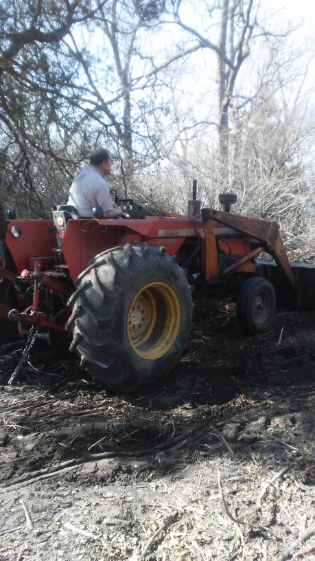

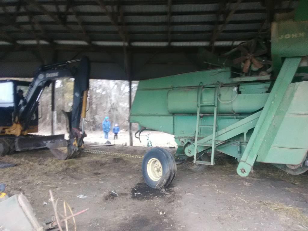

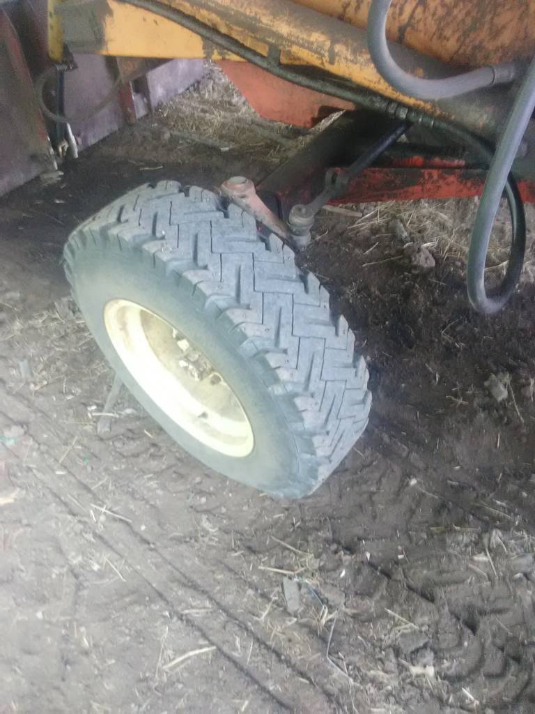

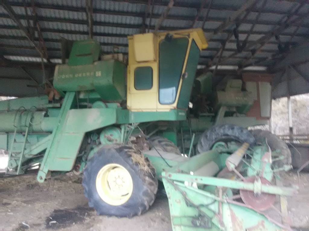

You might check with the ag salvage yards. Just google ag salvage yards on the internet. There is a good probability that john deer 55 combine wheels might fit it. Also, old allis chalmers wheels my fit. Here is my allis with john deere wheels:IMG_20180516_113424.jpgIMG_20180516_113407.jpgIMG_20180405_183923.jpg20180330_154713.jpgIMG_20180405_183923.jpgIMG_20180320_174359.jpgIMG_20180320_174351.jpg

As far as separating the centers from the a good dose of penetrating oil on the bolts and eyes, then put the nuts back on and start driving them back and forth with a big hammer and continually keep adding penetrating oil. Good luck with the wheel search lots of places to check for them.
