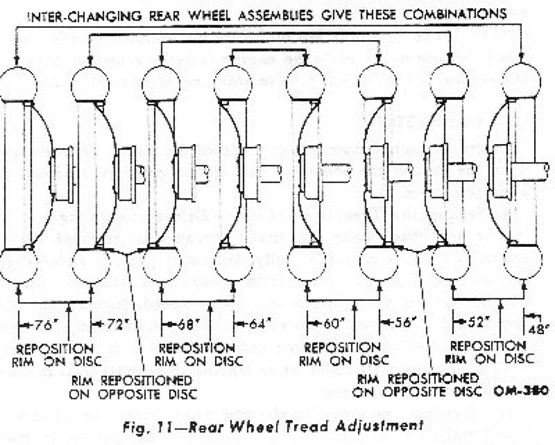

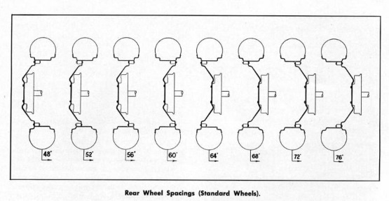

Found this on an image search, don't know what tractor, but it will give you an idea if your wheels are made the same way.

   / rear wheel spacing #9
You may need to order a manual for the tractor.
ATTACH=CONFIG]504005[/ATTACH]
That's the Ford setup......that which I attempted to remember....didn't do too bad. Covers the 100 and 1000 series tractors.
