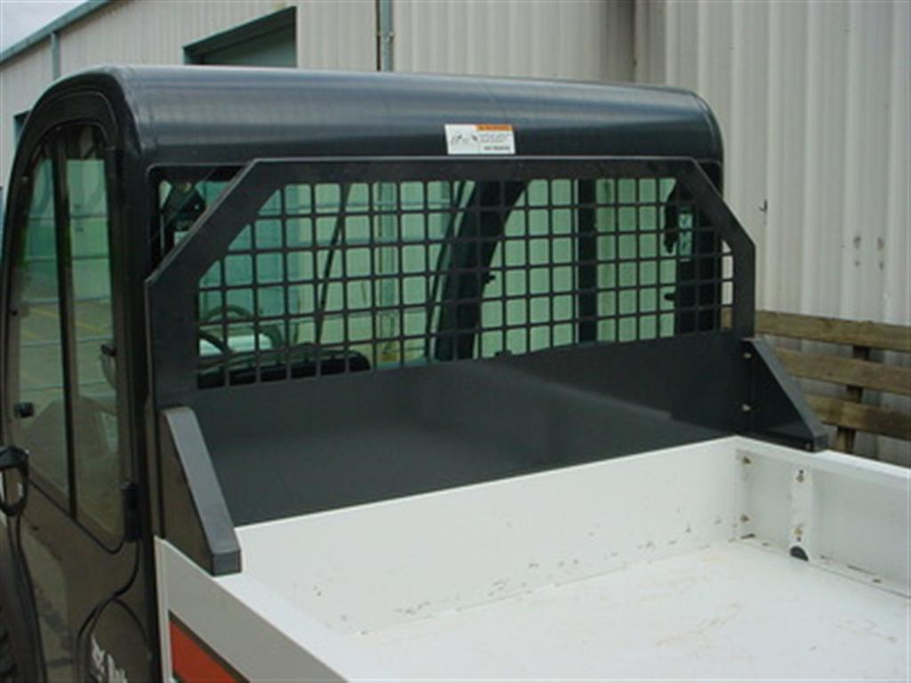

This might be your next project:
Or you can order it from Bobcat.
   / Rear windshield replacement #7
I recently sold my 2004 Toolcat to a friend and a few days later he called to tell me the rear window had fallen off! Fortunately, it did not break as it just dropped down onto the rubber seal where the front end of the rear bed meets the back of the cab. There is a homemade window protector made from hog fencing mounted on the bed so the window couldn't fall into the bed.
Apparently the metal under the paint at the top and sides of window seal had rusted and the weight of the window pulled the seal and paint off.
My friend had the window reinstalled by a local auto glass company, so it wasn't as bad as it could have been. It would be wise for owners of older Toolcats to check the paint for telltale bubbles that indicate water has penetrated the area and hidden rust may be weakening the window seal.
