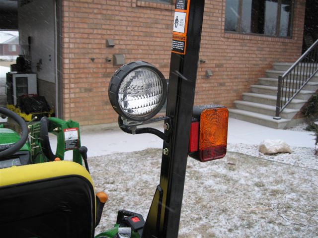

I mounted the rear work light using the bolts that hold the Tail light.

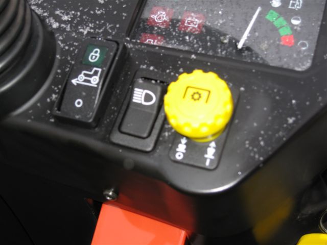

I run this light with an Aux power wire that I had the dealer install for use with my electric JD sprayer.
It is useful for alot of things. The power switch is on the dash next to the Cruise Control and PTO switch. When I use the sprayer I have to unplug the light temporarily.

Is that at JD light switch and if so, what model #? I went to my dealer today looking for that switch, but it turned into a goose chase and was unable to find it.
   / Rear Work Light #4
The switch is used on the Gators,headlight off/on .The p/n is AM117324 it cost me $7.28 back in 2/7/05

The price for the JD Gator switch is now $10.75 in the DFW, Texas area. I paid $9.00 for mine in Oct 2005. At a boat supply place you can get a switch for around $6.00 if your JD dealer can't locate one. It is just as good if not better and will be rated for outdoor use. I bought the Gator switch because I wanted my tractor to be "all John Deere".
