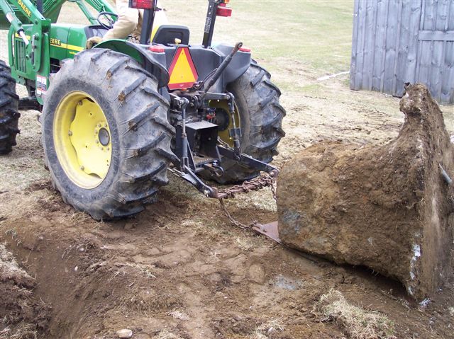

Question 4 & 5, I would be thinking about a stone boat for large rock transfer. You have the 522 loader probablly not much different than Neils' 521 and I believe that bucket could be damaged trying to move or lift some huge bones IMHO. The hydraulics on that tractor are unbelievably powerful, kinda dont know its own strength type of thing ! Get yourself some 1/4" steel plate. Three feet by five or six feet and torch cut some pull slots for your chain hookup and pull them with your 3PT.

Stone boat sounds like a good idea. Would I then just push the rocks onto it, still using the FEL to push? Also, any idea why Neil connects the boat to the 3ph arms instead of to the drawbar?
Also, FYI for anyone about to mention it, my rear tires are filled (rimguard) and I usually have an implement hanging off the back as well. Ballast weight should be a nonissue for anything I can lift. So far I have lifted lots of stuff and have never once felt the rear end get light (nor felt the FEL strain!).

I believe the use of the 3 pt in this case is he is able to just slightly raise the front end of the stone boat to prevent it from digging into the soil. We dragged that big block of concrete from my Uncle Daves place to my house, almost a mile away, OK 3/4 mile :) no problems.
Also I bought a 330 gal propane tank from Neil that was better than half full and wrapped chains around both ends to lift it with his FEL to put onto a trailer to tow to my place. His tires are filled and the rear got real light doing that job ;)
Use the FEL to manuever the rocks onto the stone boat and go from there. To try and push 36" rocks any distance is non productive IMO.
