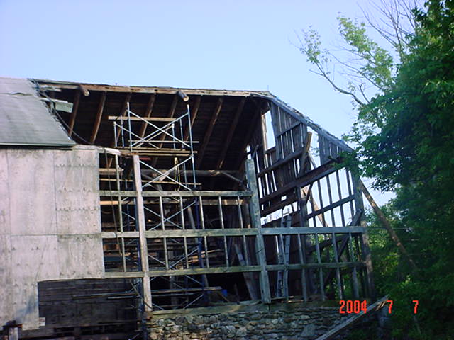

Here is the first shot of the rebuild. I will post more as we progress on it. In the last two days we removed the rafters and all but the first bay center floor. The real fun starts with the side wall removal without taking out the front wall. That wall will be braced well before we knock out the side wall. This barn has been under rebuild since 1983. It has had most of the walls underneath rebuilt by myself, one of my brothers and my father in law when he was alive. We lifted this barn 13 inches in the center. The center was also pulled over 9 inches to straighten the side walls. I should have listened to my father in law in 83 and tore it down. I would have a nice steel building now with no maintenance. The wife wanted it restored instead. My daughter will be moving into the old farmhouse (circa 1735) in a year or two.

This will be my only barn poject if I can help it. I still have the house to restore after the barn is done. A few years ago I did the entire roof on the house including installing new rafters. My next project is getting a well sunk and putting in a septic system for the farmhouse. I still need to do the siding, rewire the old place and insulate the walls to cut down on the heating bill. I've done the plumbing and installed a new boiler at the farm.

We have a 20'x40' barn built in ? (it has wooden pegs holding the frame together and used to have a slate roof until it was replaced with tin about 10 years ago). Had to jack up the front of the barn up about a foot, used concrete blocks to keep the front from sinking, added a number of 6"x6" for bracing so that it won't twist itself apart. Next we have to replace the tin roof then reside then replace the flooring on the 2nd story then rebuild the lean-to that was added on then pour concrete floors on the first floor. Gotta love the older buildings - but they do have character.

You need to remember that this has been an ongoing project for me for 21 years. The rest of the barn is now sound. This is the last corner to do and the worst. I have replaced all the sills and roof sills plates on this barn already. This project has been very trying and tiring. I can't wait till it is over with. I think we may use tin on the roof also. It will hold up much better during the winter months here. This barn is 36'x60' 2 1/2 stories.
