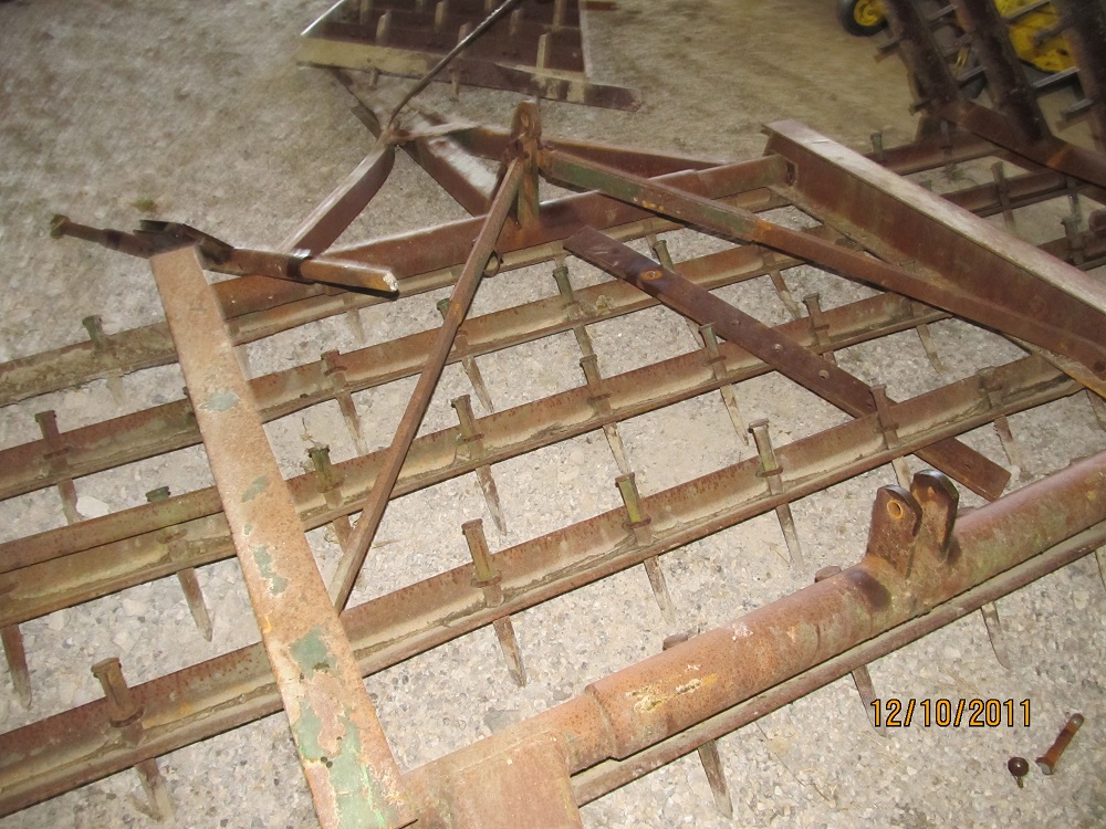

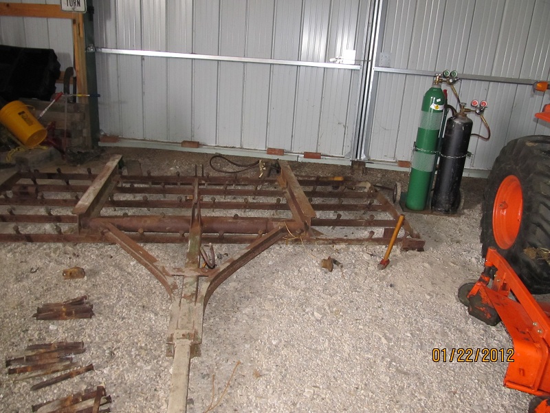

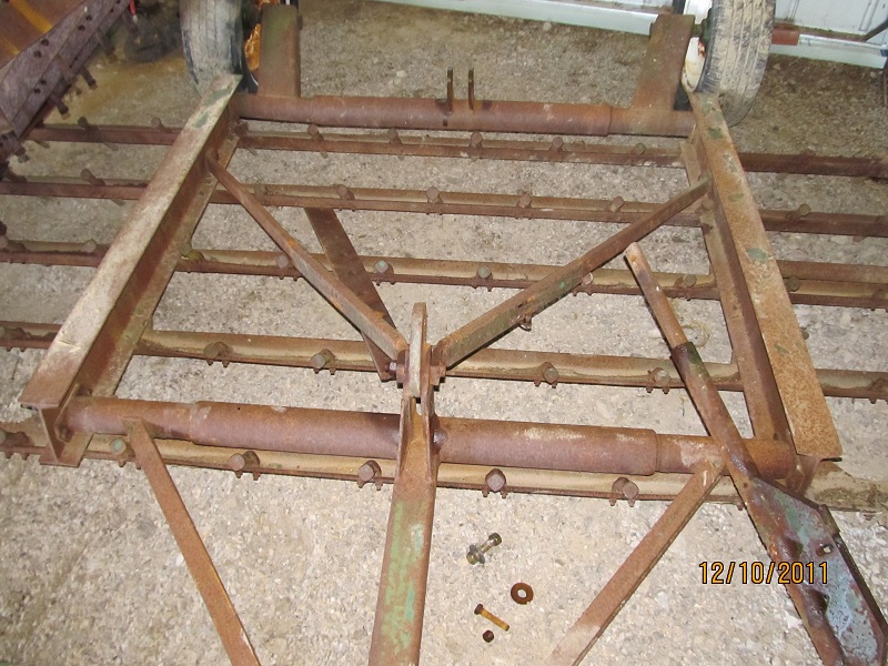

Cabin fever and kind of a slow time of year so I started to rebuld a set of harrows I bought. After taking some photos for myself I thought maybe I should post it here in hopes someone had an interest. It's not a difficult project but rewarding since I need the item when I'm done and it is an easy job. It will probably take six weeks to finish because I need warm weather to paint outside. These are usually called "harragators" but sometimes drag or spike harrows. I found this at an auction and didn't pay much since it wasn't worth much but it is very rebuildable and maybe worth $850 when done. This is an Unverferth (brand) and considered well-engineered and properly built. Made 1983 and I bought from original owner.
It was semi-frozen in the mud when I picked it up it had maybe 500 lbs of mud frozen to it, making it hard to load. It sayed semi-frozen and the mud just flaked off when I got it home. I left it in the rain for a day and then started disassembly. As with all of this stuff, it's always worse than you think and buyer's remorse only natural. Oh, well.
These first photos are in the barn after I unloaded it and stared to dissemble. Turns out many of the spikes were bent and would need to be straightened. Also, it was twisted here and there but nothing too bad. More on that after I post these pictures. Here's in the barn....

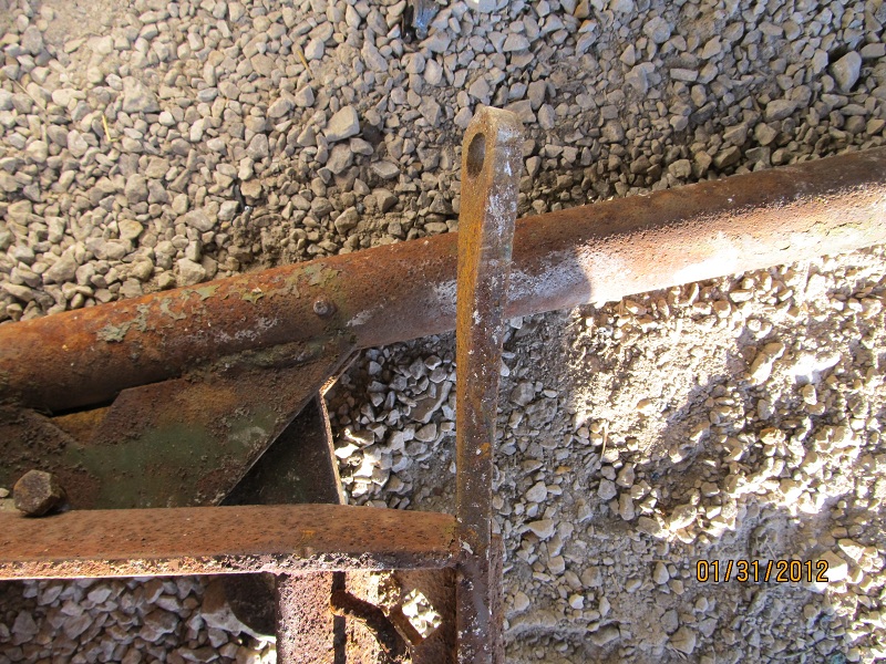

My first dilemma was the bent spikes and the need to straighten them. Here's a photo of a mildly bent spike but most were way worse than this. The solution was to heat the spike at the bend with an oxy/acy torch and then hammer it straight. Maybe 50 out of 100 but it went quick since I am still enthusiastic because this will look great when done.
The other photos show the bent "ears" on the side extensions and the racking of them plus a small bend in the wheel. I'm mildly thinking maybe I shouldn't have bought this turkey. ..

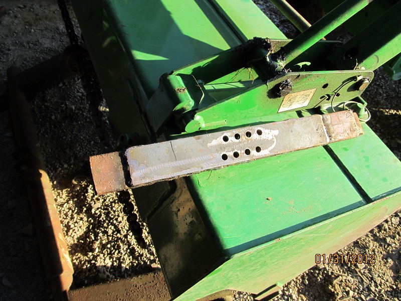

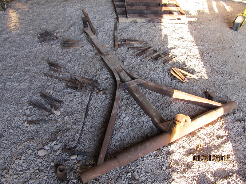

Moving right along, and feeling better, there are sliding arms that allow the harrow to flex to a degree and stay level from side to side. It has arms with adjustable holes that you insert a pin and it limits travel of the arm. I'm not exactly sure how this works but the arms with the holes where the pin goes were all screwed up and torn so I made a replica pattern in steel, drilled some holes and slab welded to the sides. Here's a photo leaning on the bucket of my JD790..

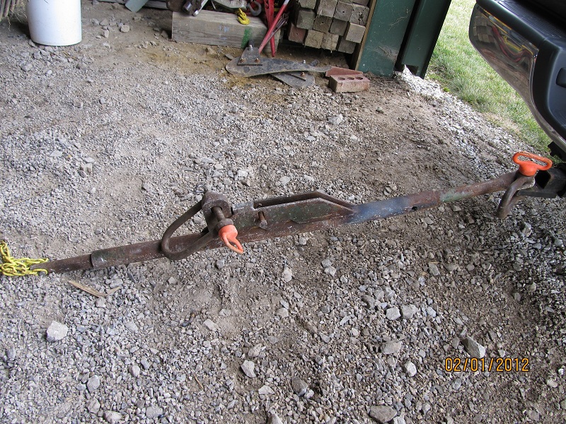

Another big problem is the tubular piece shown in the next photo. A solid round bar of steel slides inside another tubular bar and needs to be straightened. This allows the wheeks to pivot to raise the spikes and frame for transport Trouble is, the round tubular bar was bent with the solid bar extended so how do I bend the tubular bar so the solid bar will still slide in?
I'm thinking oxy/acy, a big hammer and hoping I get lucky. I figured to heat the tubing red hot, bend it and lightly hammer the solid bar in a liitle at a time to sort-of die sink it in. Did I mention I had a big hammer since that's where I went wrong. It worked 98% of the way and then the solid tube got stuck inside the round hollow tube and wouldn't budge. Now what?
That's in the next post..

What a dummy I was to overpound the solid bar into the tubular bar and now I am shucks out of luck and I knew better going in. Why, oh why did I use the big hammer? Normally, you can press things together with no problem but pulling them apart with nothing to grip to is another matter.
I didn't want to embarras myself with a Rube Goldberg thing but I had no choice. I figured to hook one end (no easy task) to my JD790 and the other to the pickup and that should do it. No dice as I easily pulled the 790 forward. When the outer tubing cooled it shrunk tighter so I needed to re-heat under tension. In two photos you see the item hooked to my 8000 lb JD5520 on one end and the pickup on the other end. Told wife to idle in neutral and then put in drive when I say so with no gas added. "Do I really have to?', she asked. "It's in the marriage vows", I said, "you can look it up later".
It took 15 minutes of heat and a wife itching to hit the gas, but that puppy finally let go. Note to self, don't do that again but I think I said that once before. It was really stuck hard. Here's a photo of it apart and I am really glad that disaster had a happy ending.

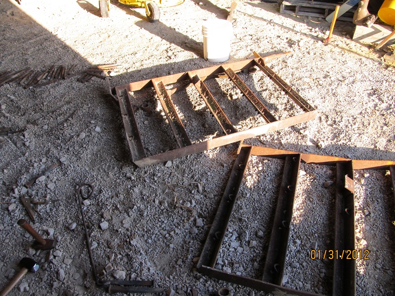

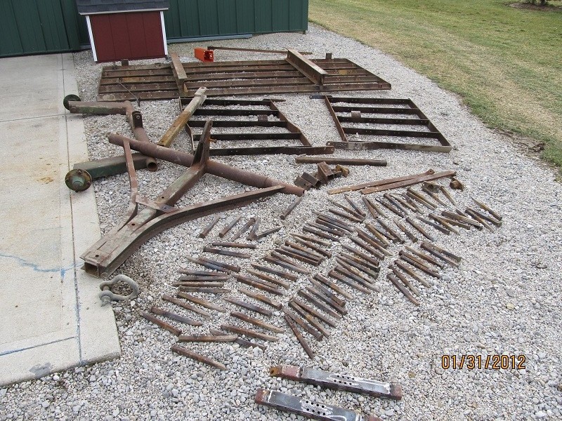

Then I started to drag the stuff out ino the yard. There is rust, yes but also some flaky paint and stuff, plus dirt that the rain and maybe snow will wash off in the rain and or maybe snow. It could still snow, right? . My JD790 is a TLB and the bucket lifts less weight than without a backhoe but it lifted everything with no problem. Here is lifting the rear frame/hubs and the front end in wait.
Also, the wheels are serviceable but I have no idea what size tire to use since too small will gouge the road and too big will not clear the ground when in the lift position. I have some 24 inch diameter tires and wheels on a cultivator--see photo--that I will try before I put a tire combo together later on. I'm feeling better now, maybe even optimistic.

OK, I got everything outside and spread out--see impressive photo-- so the weather can work it's magic and loosen any scale. Then I will come along with a scrub brush, some Joy dishwahing detergent and scrub it up. I'll prime the top first, then flip and prime the bottom. Then I'll paint the bottom and flip over to finish paint the top. I'll paint things apart and then assemble. The primer I use is Rusteoluem Rusty Metal Primer and I really thin it to maybe 50-50 with acetone. This allows the primer to flow into all the nooks and crannies and give a better finsih. I mean, it's not going in a museum but I want it to look farm-quality perfect.
The darker green paint color is not easily available--but Oliver Green is close--so do I go with a lesser quality alkyd enamel from a TSC that will fade or do I go with the lighter shaded but higher quakity acrylic enamel in JD Green that I already have? Probably Oliver Green since I have two new Unverferth decals coming in and it would look better to not cheat on the wrong color paint, even though I want to.
I can't find a good picture of what one of these looks like. Most are way bigger-- and smaller 16 ft (10' center and 3' wings) ones like mine are hard to find. That's why I wanted this one and why it's probably worth the effort to rebuild it.
The plan is to pull this with the wings up on fairly firm and level lawn-prep ground iwth my Kubota L4300DT with ag tires. If the spikes are left long in the ground on level ground I'll bet I can even pull it with the wings down. I can easily pull a 13 ft slighty different harrow now so I think--er hope--so. We'll see.
