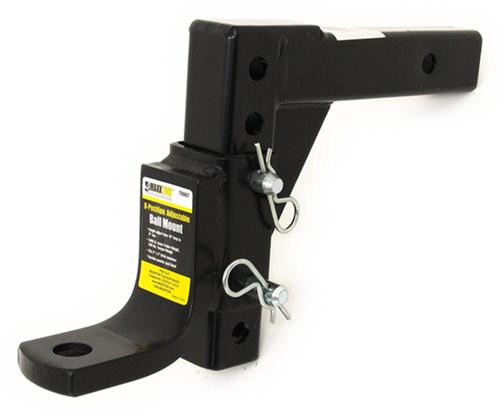

You might look at a place like etrailer.com for adjustable drawbars.
   / Receiver drop calculation #8
$60
on the plus side if you have different trailers you can adjust the height for them, and pulll the 2 pins and pull the ball off while keeping the shank in the reciver if you like something back there for people to run into instead of your plastic bumper.
