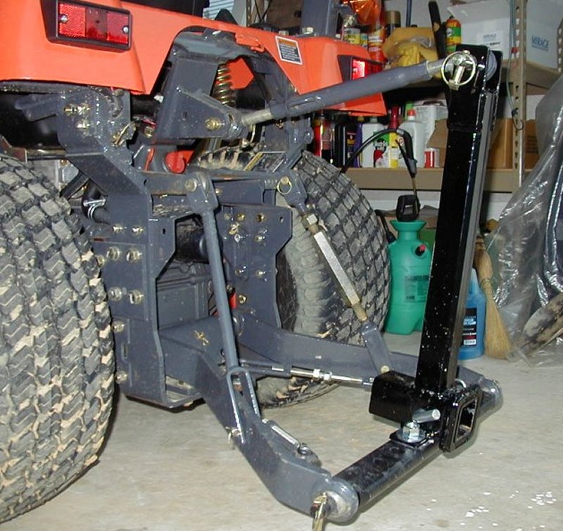

Here is my version of a reciever hitch for a bx2200. It has a 6" receiver tube purchased from a hitch shop, 18" of 2"x 1/4" tube, and 12" of 2"x 1/4" bar I picked up from a scrap steel dealer. It weighs about 20 lbs and bolts onto a cat 1 drawbar.
I slide a cargo carrier purchased for $60 from Walmart into the receiver and it becomes my carry all. I put 3 80lb bags of sackcret on the carrier for ballast when lifting heavy loads w/ the fel.
If I did it again I'd make the vertical tube shorter and the horizonal/verticle bar parts longer. As it is, the toplink will dent the sheet metal just a bit on the bx (see photo-oops) and bend the toplink where it attaches to the verticle post.

Your receiver hitch looks great. /w3tcompact/icons/smile.gif
I built one very similar to yours for my 2910.
Using the 3PH draw bar makes the project easy.
I haven’t painted mine yet. When I do I’ll post a picture.

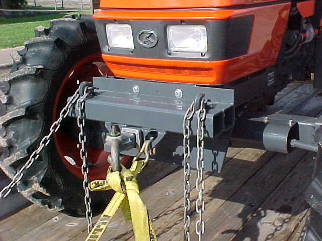

Hey, can I see some pics of the front mounted receiver hitch? I've been wanting to build one for some time and your pics will help.
   / Reciever hitch #5
Now that's the best idea I've seen yet - makes the most of the drawbar and is flexible .... I like flexible ... ie: take it off when you dun't want it and use the drawbar for something else.
mike
   / Reciever hitch #6
Here is a pic of a front receiver. The best use I have for it for one of those extension shelf things people put behind their car for ice chests and stuff. I have one on the front of my M6800 for tools and herbicide jugs and exery thing else. It is a ten square foot shelf! Works so good I only take it off when I have to.
