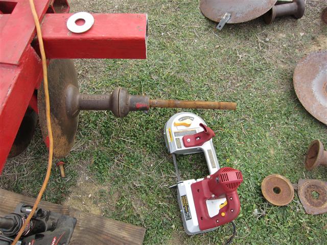

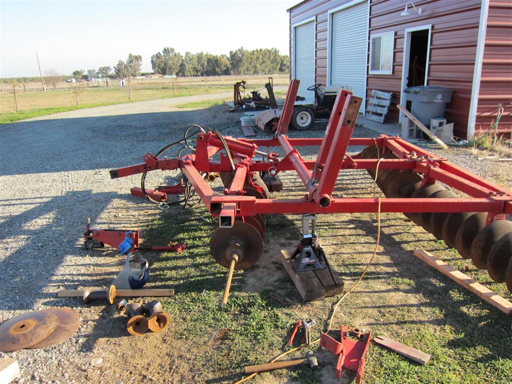

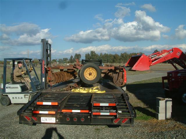

I cut down a 13 ft Krause wheel disc to about 8 ft so I could handle it in soft soil with my 2008 MF5525.
Wheel disc delivery-2.JPGWheel disc mod-1 (1).JPGWheel disc modify-2.JPGWheel disc modify-3.JPGWheel disc-3.JPG
I moved the wheels inboard (originally they were outboard of the main frame).
