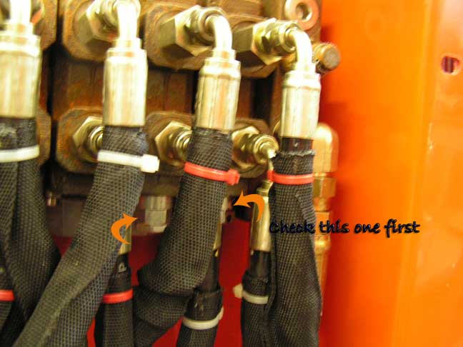

I am wondering how much of a problem Kioti is having with the 2375 valve assembly. Mine was replaced in the first week because it leaked to the ground in about 30 minutes. The new one seemed to work better for a couple of months (6-8 hours) but now leaks to the gound in 60-75 minutes.
I was told it is about an $1800 valve. Not sure if that would include labor. I hope it I never have to replace one after the warranty runs out. From what I read there seems to be several who may be having the same problem.
   / REF: headachers Kioti warranty issue #2
Invoice I have list $1747.20 for Bc01-0100-p control valve asm. + labor. I have ask several times what is normal leak off ,still don't know . good luck jim

As far as the price for the control valve assy it lists for $1911.00. As you all know nobody pays list.
Here we typically charge slightly more than our cost on parts that expensive.
Kioti didn't pay the dealer 1747.20 either, it was probably much less.
Also just a note for the future. There are 3 possible valve bodies for the KB2375 & K2376 backhoes.
Nimco #BC01-0100-P
Dinoil #BC03-0000-P Hose Kit BR02-0100
Hanil #BCR04-0000-P
(shhh~use the Hanil)
check the picture attached as to where to check for a possible leak, occasionally the teflon washer and o-ring don't seat right.

Hi,
As Becky has mentioned, there are 3 valves in use by Kioti. No one of the suppliers could supply kKioti with the numbers that they required.
All three valves are able to be repaired with a only a few seals, as she has also mentioned. It is unusual that the valve would need replacing because the only thing you can't fix is the machining. During warranty Kioti will sometimes just switch out the part because they can save on labor.
Besides the 2 seals mentioned by Becky I have found that when driving around without the BOOM PIN in place the seal in the Boom cylinder can be folded over from bouncing and will allow oil by the seal causing it to leak down. This also has a repair kit available.
It is a pain, but it is also very important to eliminate the bouncing weight on this system by resting the boom onto the PIN at the base of the BOOM.
Any backhoes I have ever worked on have some leak down when not locked. As long as it does not effect performance you should be OK.
KiotiDave
