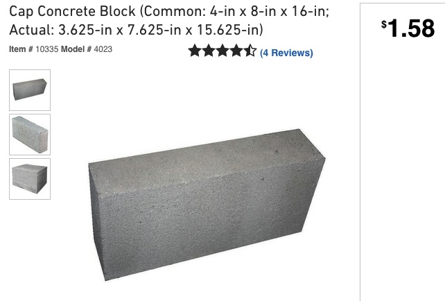

Question: Do I need footers under those legs? They are 4x6 posts.
   / Refurbished Diesel Farm Tank - Questions #9
I would put 4 of these under the legs.
