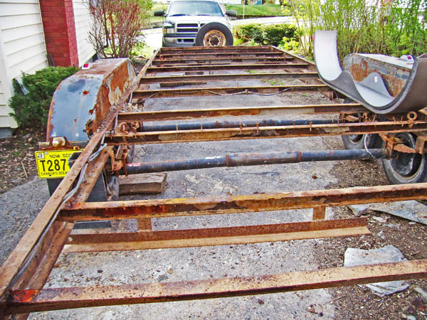

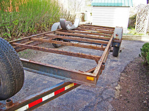

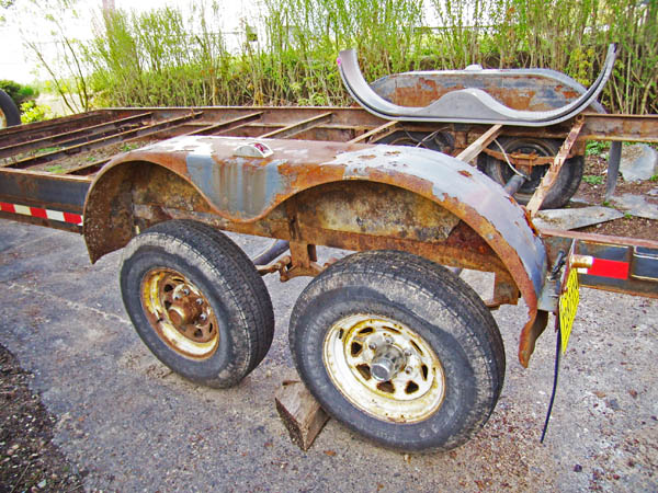

Folks; my trailer is need of some refurbishment. The ugly heavy box is gone, the rotted floorboards have been removed and now it sits awaiting the installation of new fenders, floorboards, ramp holders and paint.
several questions:
1: Should I use self tapping screws or bolts to attach the floorboards?
2: How should I go about cleaning it up for painting?
3: What type of paint should be used?
4:What should I use for undercoating?
5: What type of small box would be desirable for holding tools and fuel? This would only be a small one probably on the front.

I refurbished two trailers in the past two years:
On the first one, i replaced so many rotten steel in the process, that in hindsight i could build a brand new one in less time, ending up with a whole lot less of annoying wire brushing, cutting and aligning.
From here, the crossbars look pretty rusted. You're going to wish you never started it when you try to wire brush them all, in the inside of the C channels too.
If you have access to a commercial sand blasting outfit, just sand blast it. If not, buy new steel.
It looks like the axles are widened, judging from the pipe and welds in the middle. This trailer doesnt wear its tires uneven ?
Be sure of what you're getting into !

I agree with Renze that you need to sandblast first to get rid of the rust so you can see what you have left to work with. Then replace any bad steel needed.
For decking I prefer carriage bolts for easier future replacement. My current trailer has the self tappers but I'll replace with carriage bolts when needed.
For paint I pick a standard color equipment type industrial enamel paint most automotive stores carry. In my part of the country there is a lot of salt used in winter so repainting every 2 or 3 years is about normal.
My trailer came undercoated but I re-spray with rattle can undercoat same as re-painting or every 2-3 years.
I use a diamond plate aluminum box on the tongue I bought from Tractor Supply. You have your spare on the tongue which can be relocated to the side with a spare tire bracket that tractor Supply also sells.

Listen to what the others are saying. When its time to redo my trailer I will have it sandblasted, primed, then Rhino Lined. You know, the stuff they spray truck beds with. I will do all this then bring it home, wire it, and then install the boards.
