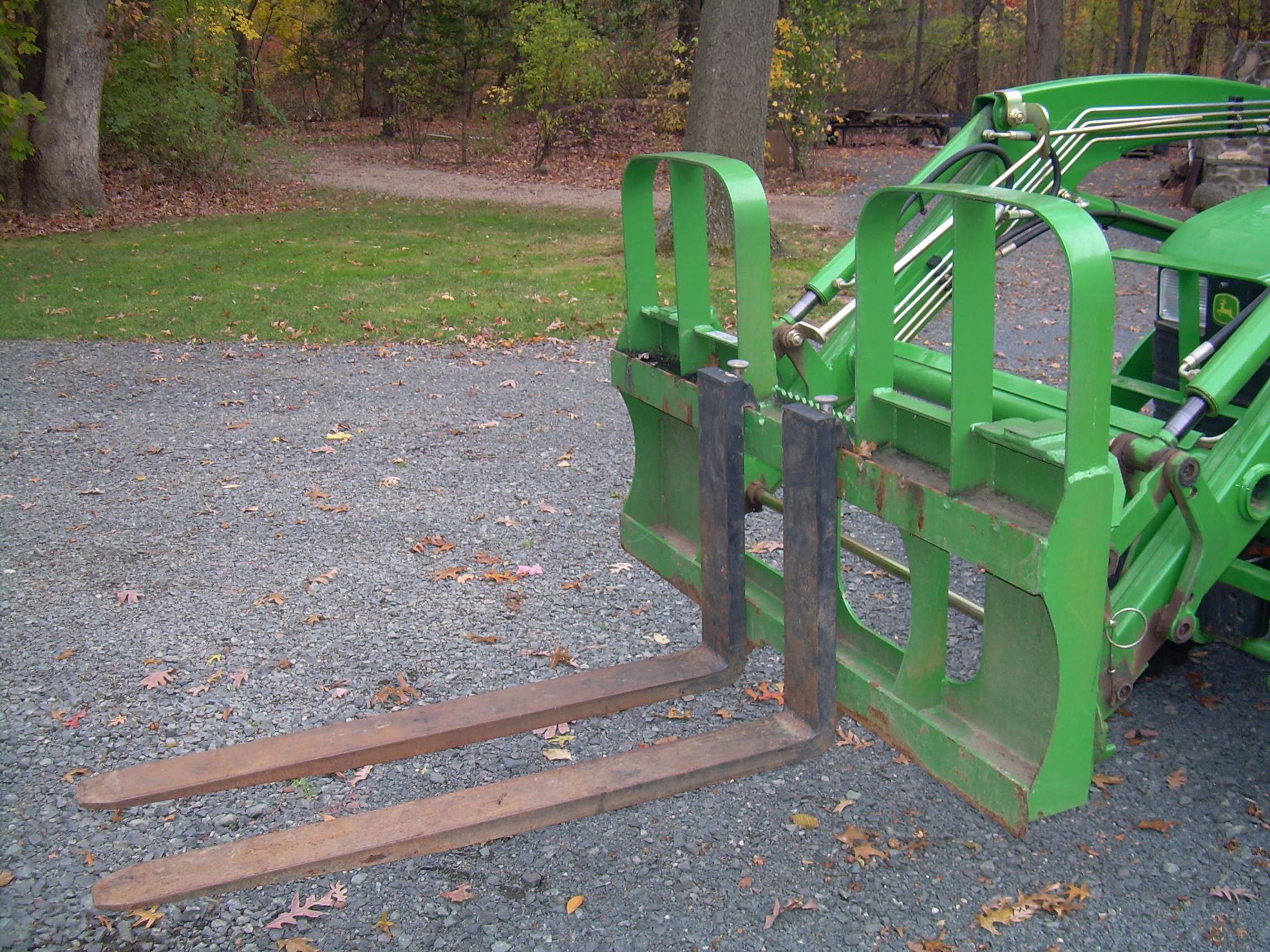

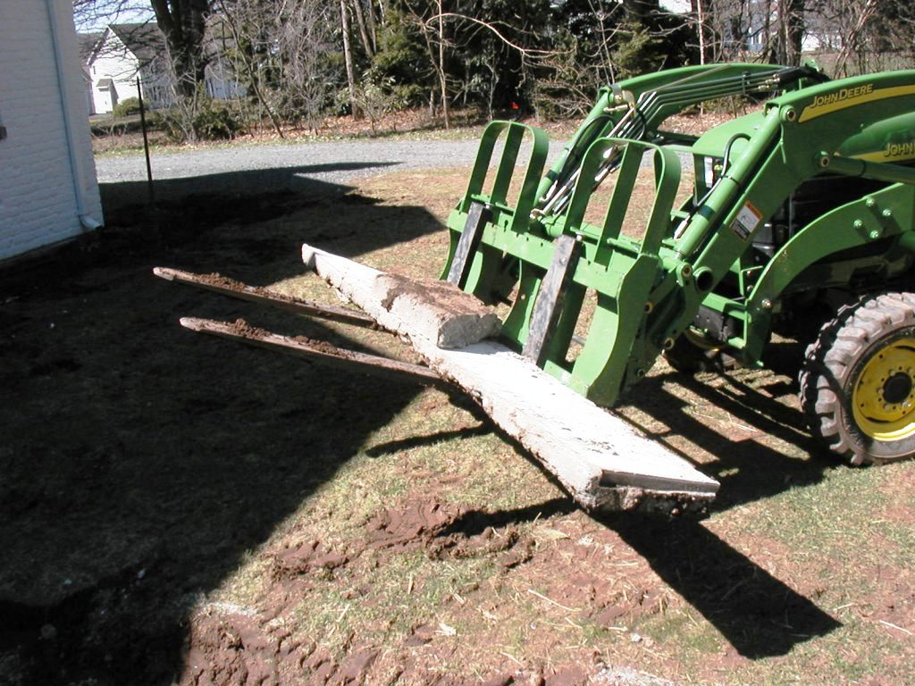

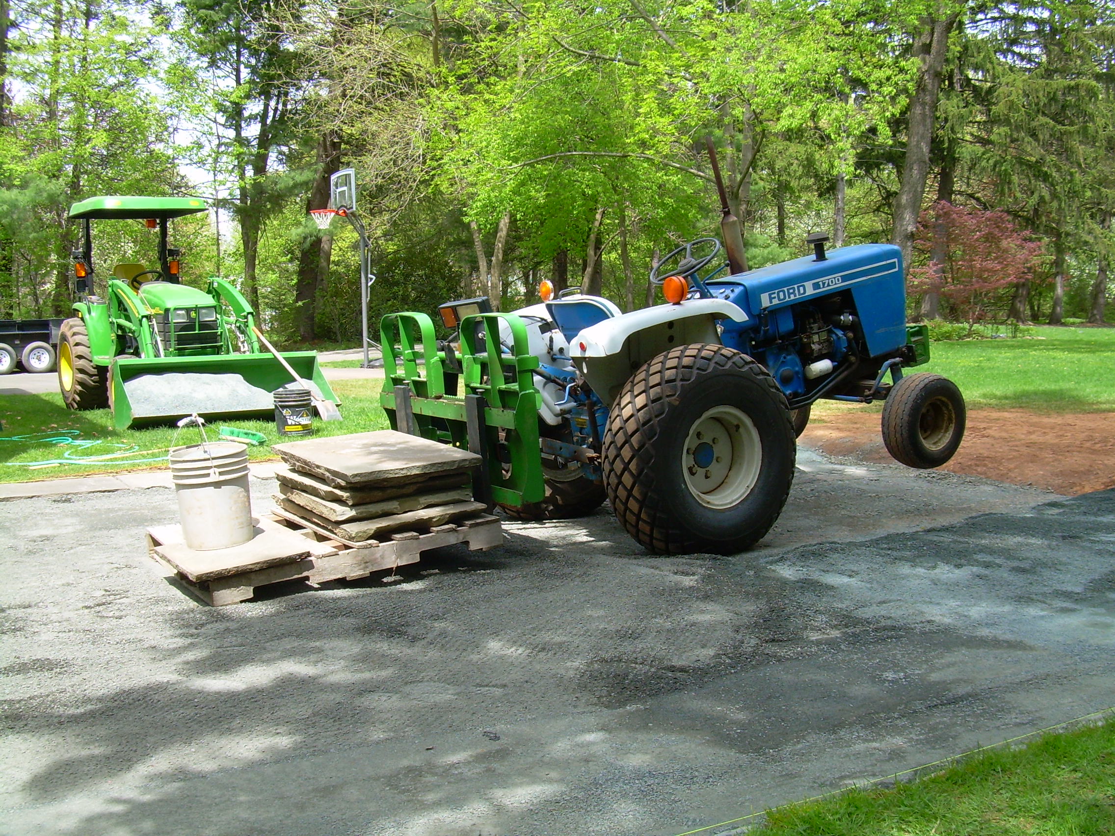

I have a 3720 and want either 2000# rated or a 3500# rated fork setup. Will a 2000# set bend and twist with a 3720 where a 3500# might not. I will lift heavy stuff and poke and dig and whatever with the forks. I won't baby it, I am sure. I know a heavier set will be stronger but would a 2000# work with a tractor of this caliber:confused::confused::confused3::confused3:?
I have 300CX and I think lift capacity is ~1500 LBS, That's on a 4310.
If yours is the same then 3500 is way over kill.
I have the Horst set, can't remember off the top of my head But I think they are ~ 2000 capacity. I do not baby mine and use them for far more than moving pallets.
Don' think you will bend or twist 2000LB forks with the 300 loaders capacity, How many HP with 3720?.
JB.
