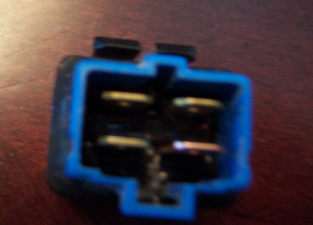

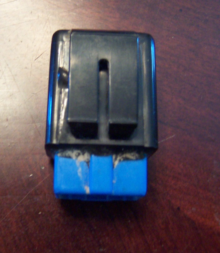

It turns out that I need the blue relay for my 3820i. I'll bet it's the same switch as yours. Did you find where to buy one? My local dealer has had one on order for weeks. Nothing.

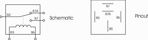

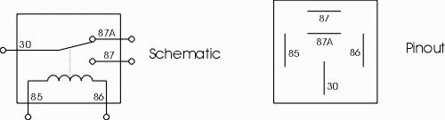

As long as you can determine which two contacts energize the electromagnet, and which two contacts are the switch.... you can wire in a universal relay to get things going again.
