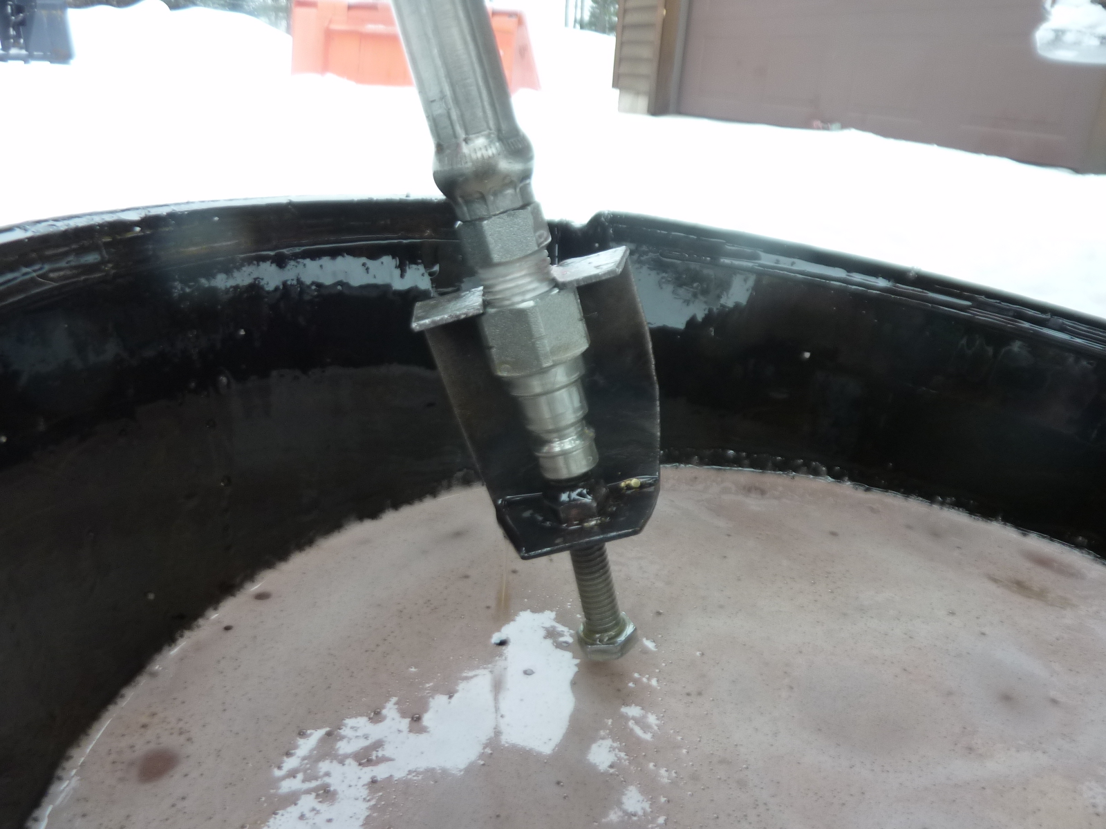

Sometimes I have zero problems, other times it is almost impossible to hook up. I know how to release the female side but the only way I know for the male end is to unscrew the cylinder coupler and let out a bit of fluid. There has to be an easier way.

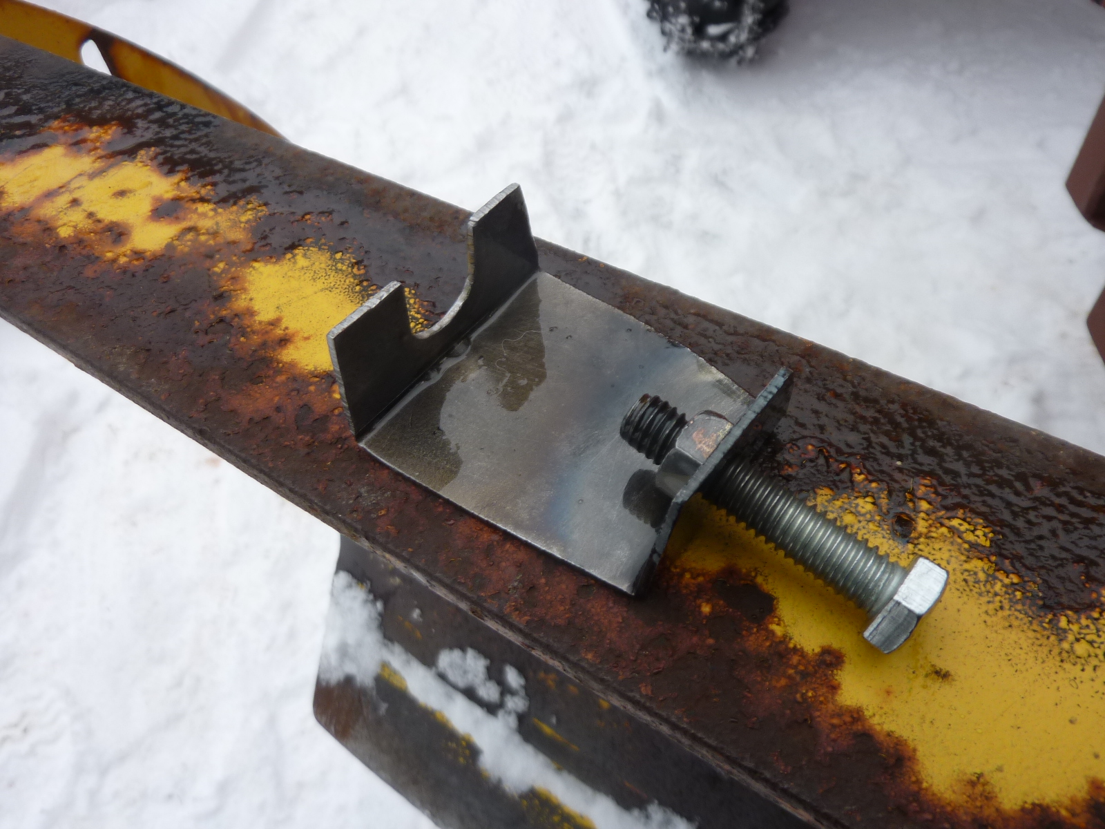

Usually pushing on something hard like Coby said works but I made a little clamp to hold it open that would work if you couldn't release the pressure by pushing.

Check your local supply house if you'd like to use a brass or nylon tipped set screw in a tool like Gordon made.
Braze or weld an Allen wrench into the hex for a handle, and or a nut at top for a wrench to fit.
