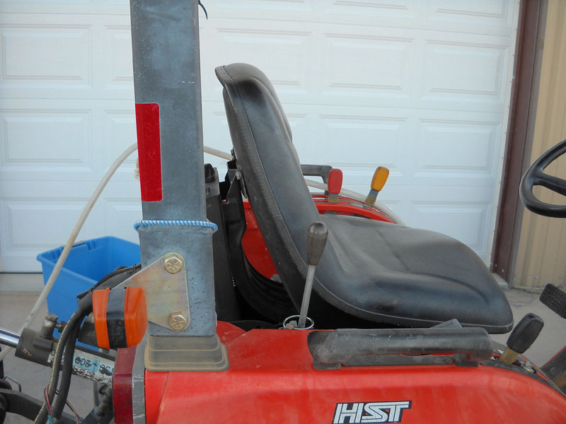

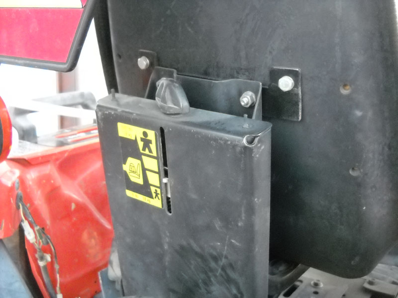

I too found the factory seat on my 7800 uncomfortable and too far forward. About a year and a half ago I bought an economy model suspension seat to ease the ride and improve the forward slant situation. It worked well, gave me some additional knee room, but the low quality vinyl did not hold up.
I still had the original seat so I adapted it to the suspension frame. I moved the seat as far back as practical and changed the forward slope to what was good for me with some custom brackets.
This works well for me.

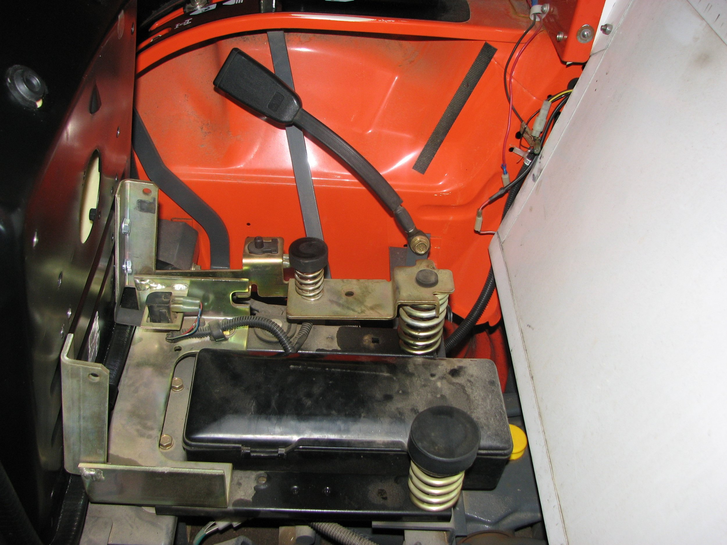

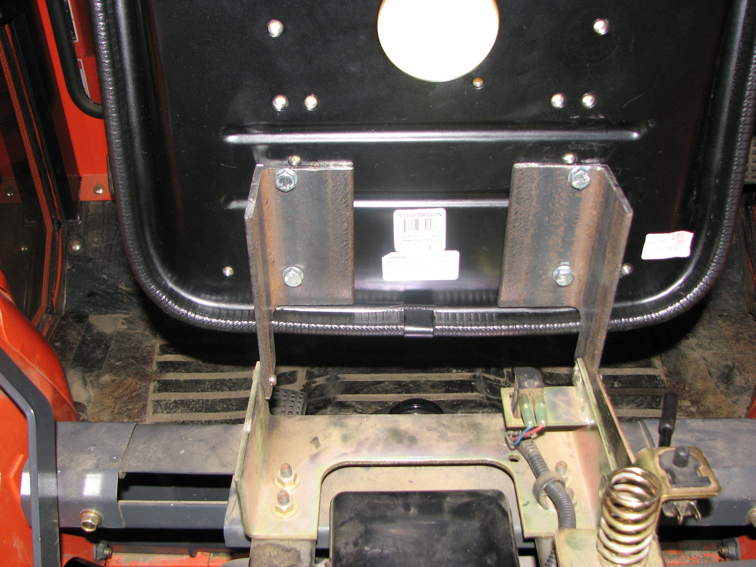

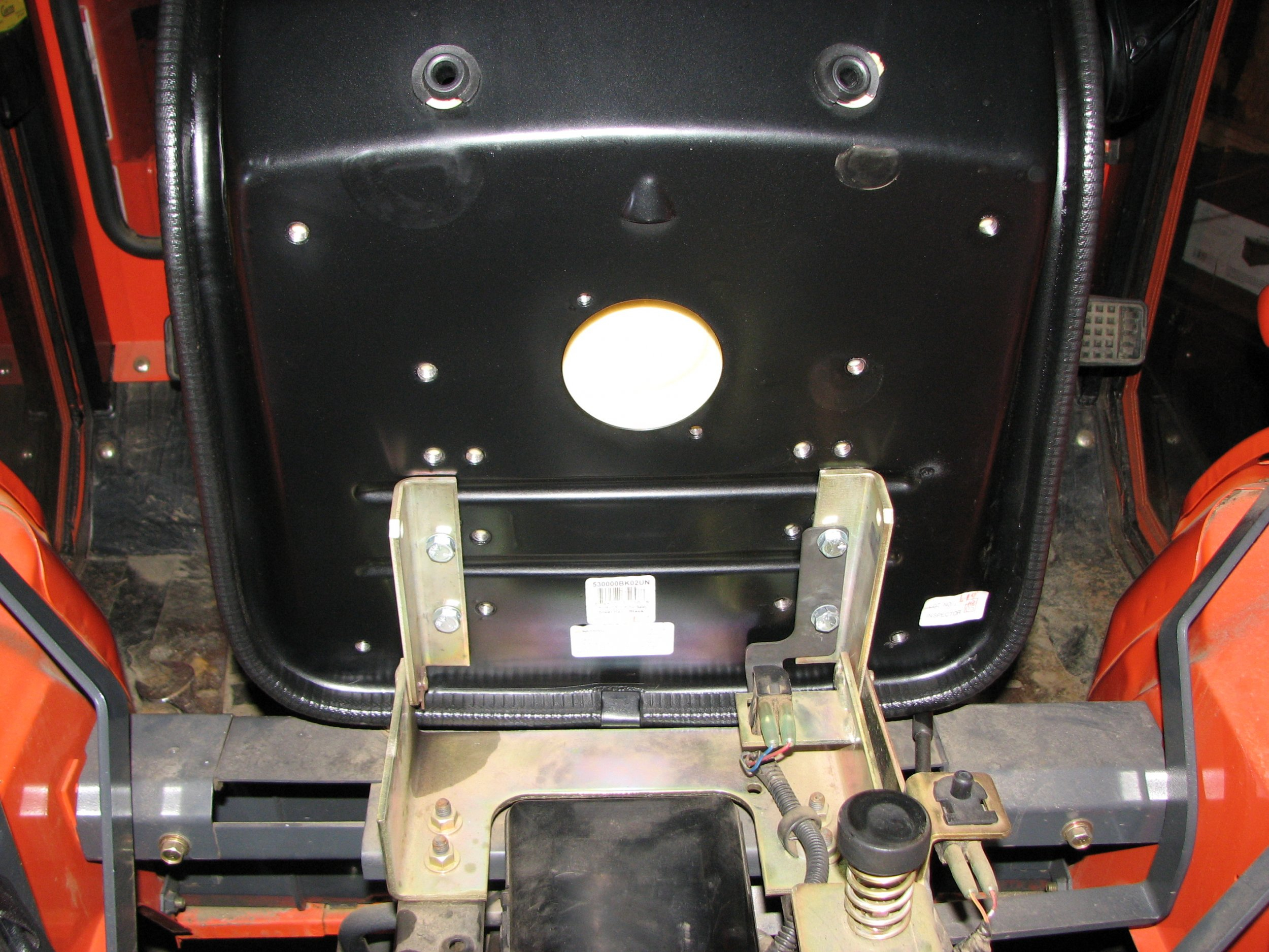

I realize this thread is about 10 years old, but thought I'd add the recent seat location modification I did on my B7800.
A wihile back I replaced my original B7800 seat with a seat from Tractor Supply, A Country Line 530000BK-CNL
for Kubota tractors. The seat is okay but would be better for me if it was mounted higher and farther back to give me more leg room.
There are two small angle iron brackets that are bolted to the bottom of the seat. I replace those smaller angle iron brackets with two modified
2-1/2" x 2-1/2" x1/8" angle iron bracket.
After installing the larger modified angle iron, I jumpered the safety switch because the higher mounted seat would not depress the switch.
I think I can attach a space filler to the bottom of the seat that'll depress the switch. Still a work in progress modification,
This mod. kicked the seat back a little over 2" and raised the height about 1-1/2". My cab limited how much father back I could move the seat.
That small seat relocation gave me the needed leg room I'd been searching for.
