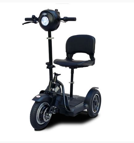

Get her one of those armchairs that lift her electrically to her feet - take the strain off of her hips. Have a walker, canes handy for stability. Dry floors, no scatter rugs that can slide. no sills to step over. Chairs that don't require her to lower herself into them. Comfortable office chairs with high seat work well. Solid edges that she can guide her self along (counters.tables,chairs). A hospital type bed that folds to accommodate different sleeping angles will help ensure that she gets her rest. Design things so that a compact mobility scooter can get around. - Independence and if the wheels are large enough. can handle lawn and gravel drives. A folding one is great for car transportation.
I like this one! - snr-stand-n-ride-pre-mobility-electric-scooter-500-watt-20-amp-batteries-new-model-coming-soon-3.jpg
EV Rider Stand-N-Ride Mobility Electric Powered Scooter - 2017 Model
