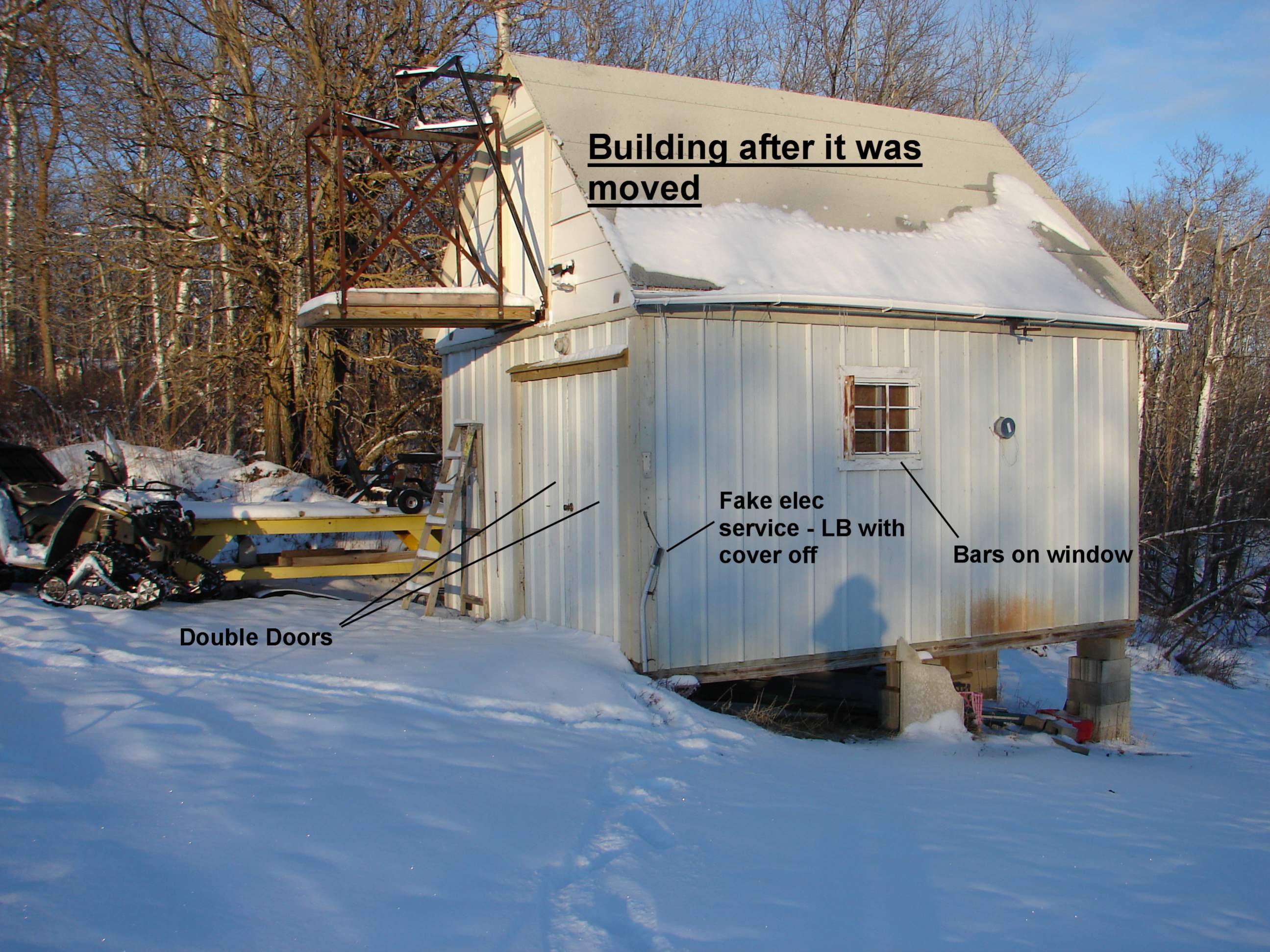

Thieves in the area were using chain saws to bypass doors on wooden buildings and tools to take metal siding off metal ones. So we glued steel siding to the OSB sheathing as well as the screws. We put bars on the windows and blocked looking in with plywood on the inside. See picture.

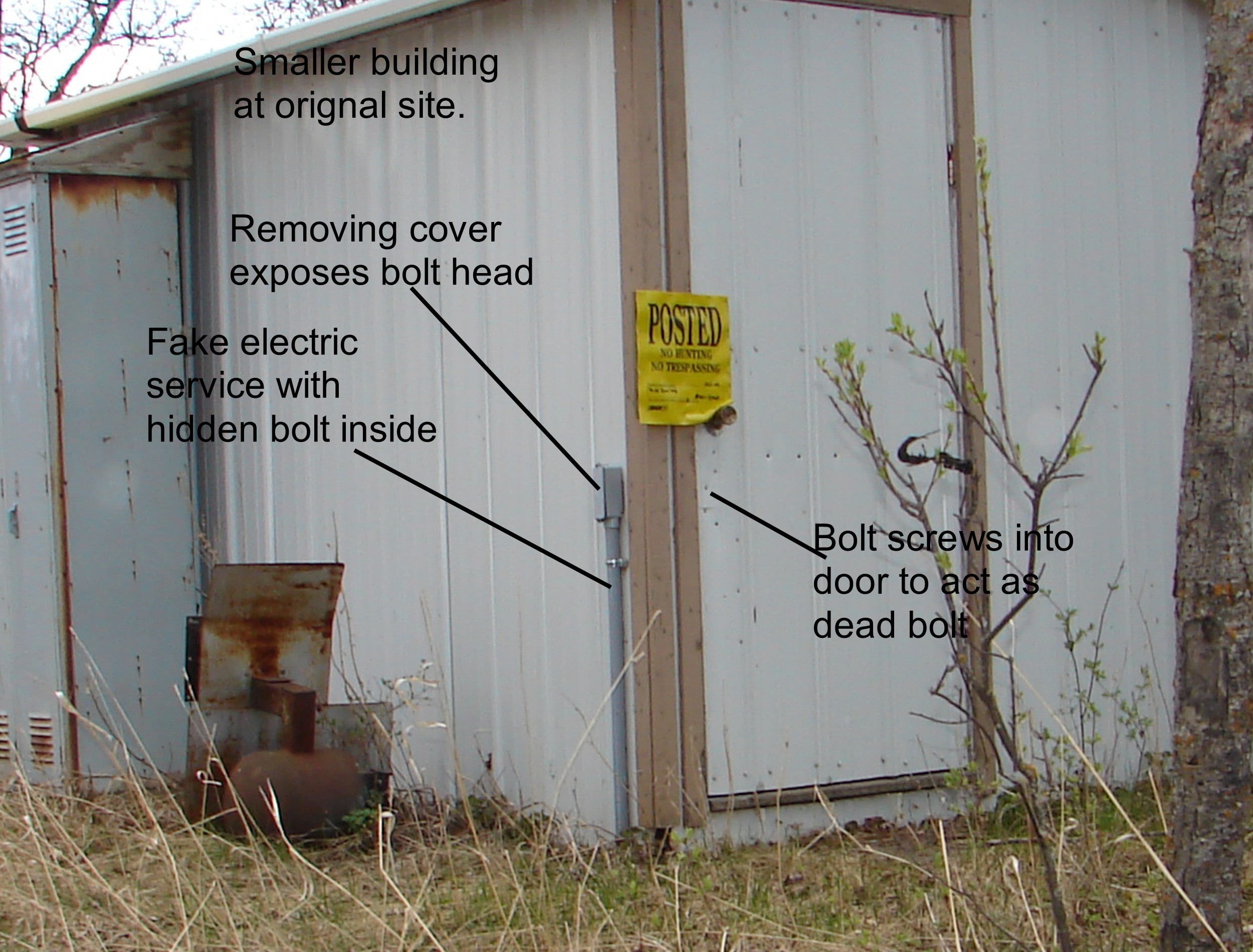

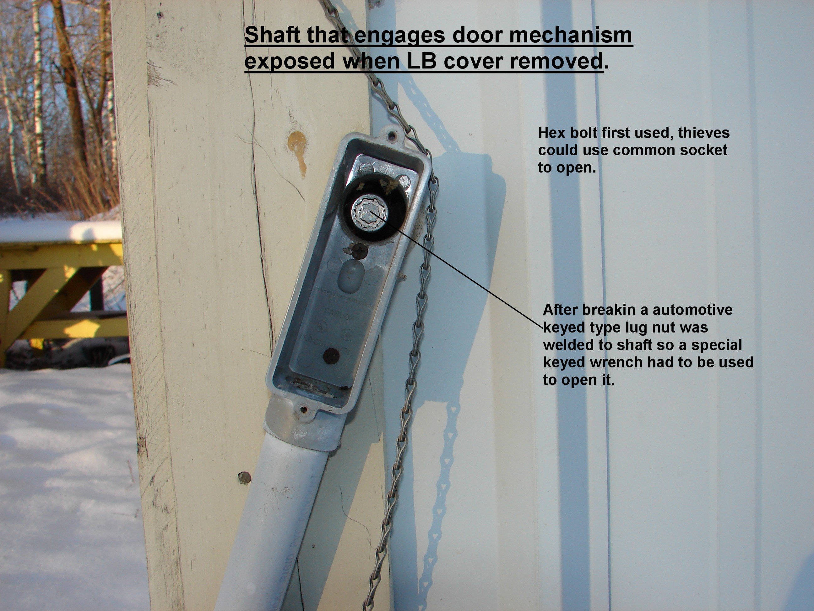

Both buildings had doors close to a corner. At this corner I came up from the ground with plastic conduit glued to a LB type junction box. The other end of the LB was pointed to the door. Now to the average person this was nothing more than a simple electric service, but in fact no wires were in there. Removal of the LB cover exposed the head of a bolt.
On one building this was a bolt that screwed into the door and served as a hidden dead bolt. Backing the bolt out about 20 turns allowed this door to open. See pic.

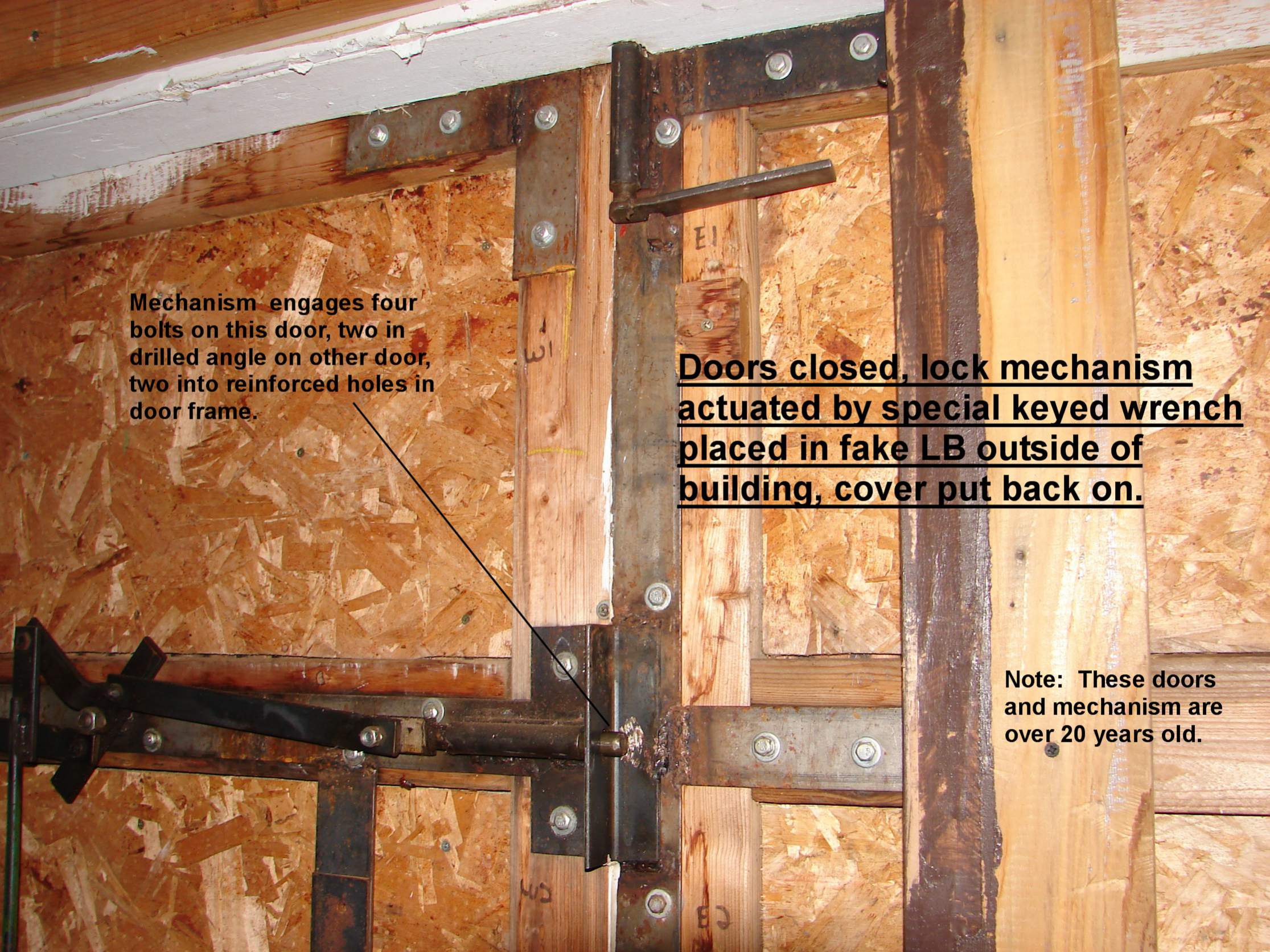

The other building is the one first pictured; it had double doors with a very complicated hidden lock.
Removing the LB cover exposed the end of a shaft that actuated the more complicated mechanism. See pic.
This picture shows the other end of that shaft, and the shaft in the door in engages to actuate the mechanism.

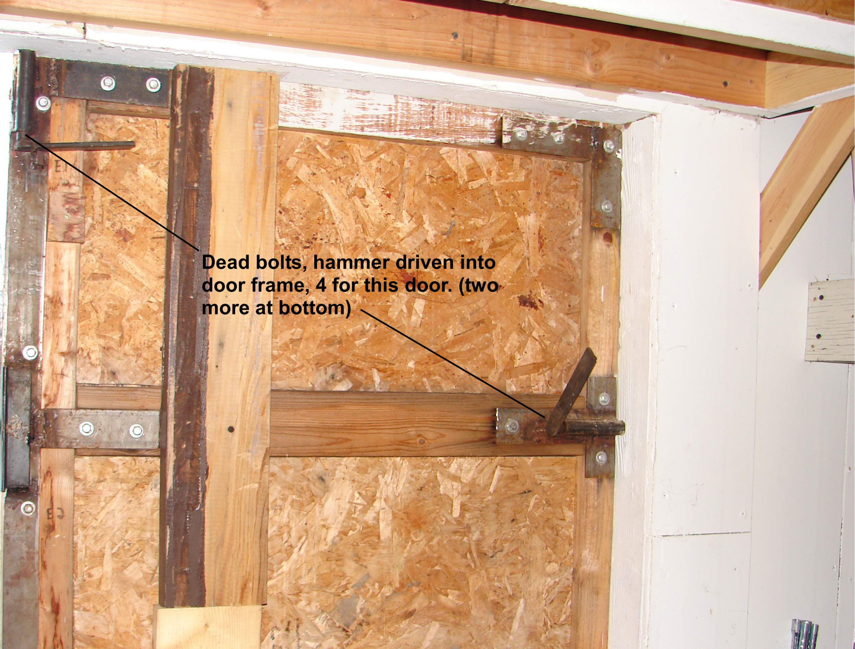

The other door locked with four hammer driven dead bolts that hold the reinforced door solid to the frame. See pic

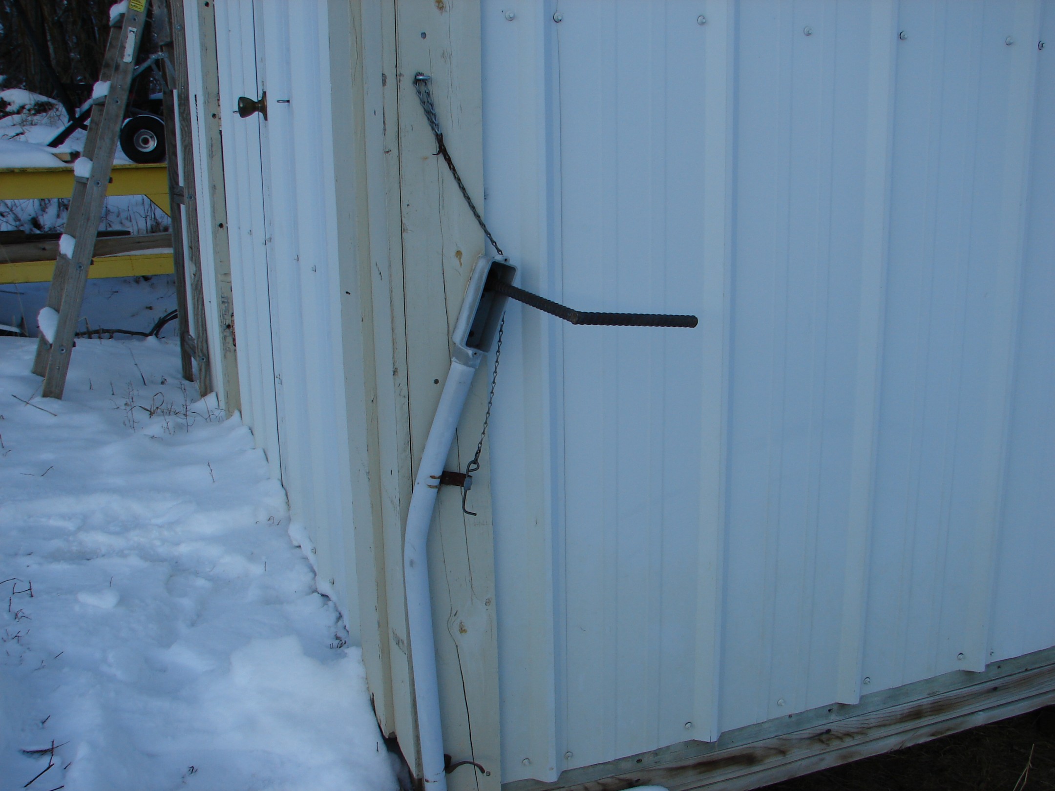

When both doors are closed, a special keyed wrench is inserted into the LB, engages the shaft, and a quarter turn locks the second door to the door frame and other door. See two pics.

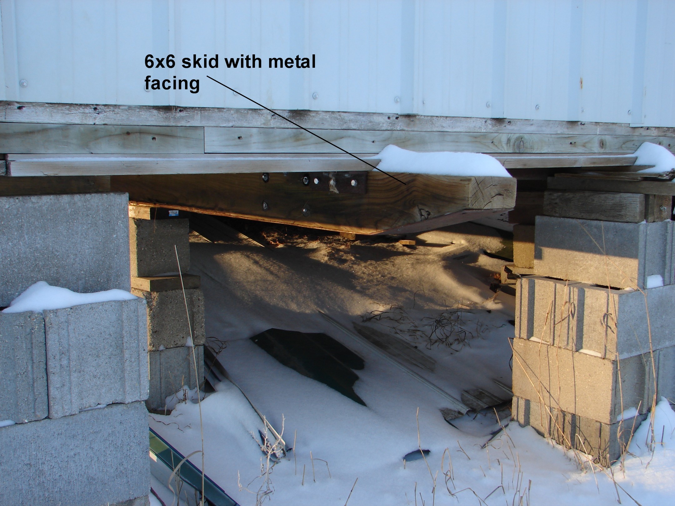

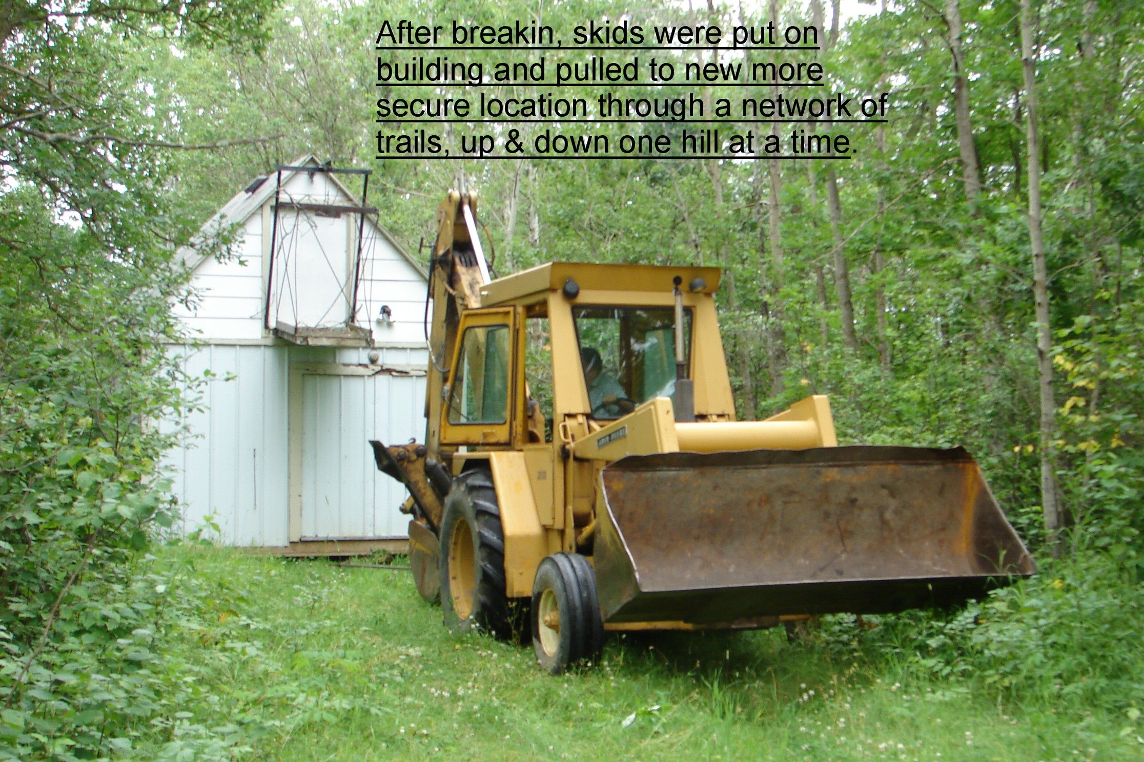

In 2005 thieves bypassed both gates through neighbors property, pried the small buildings door bit by bit until the bolt was discovered, then used a wrench in the LB's to easily open doors of both buildings, stealing over $5000 worth of stuff. Afterwards hex heads were replaced with special automotive-keyed lug nuts, in 2010 skids were put on and moved. See two pics.

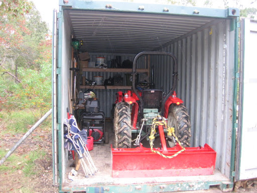

I had all my stuff in a 20ft shipping container. This worked very well and its secure. I paid $1350 for the container including delivery and you can't build a secure shed for that money.
Now I have a metal building with security and cameras.
