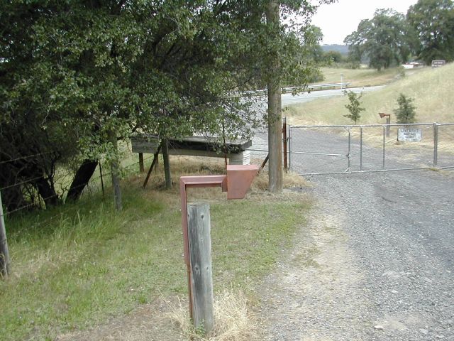

i want to install a remote control gate, using a garage opener, since i have 2 that i am not using. i have electricty available, but haven't come up with a good way to hook the thing to a gate?? years ago, some farm magazine had a drawing on how to do this, but i haven't been able to locate that drawing.
any suggestions??

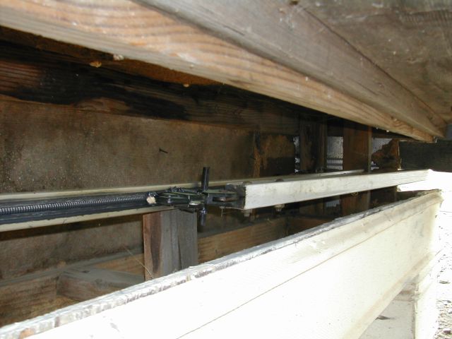

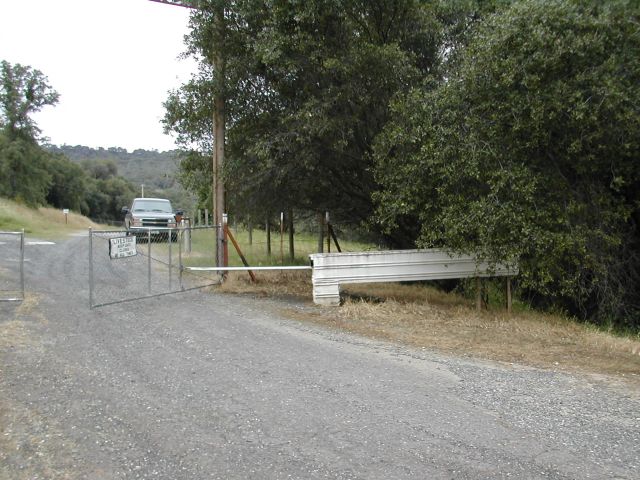

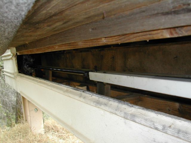

Our highway gate is opened by a garage door opener, and has been for decades. It is a screw-type opener, as it would be harder to design using a chain drive opener. Our design was copied from another's that is about 10 miles from us.
If you want to PM or email me, I'd be glad to clear up any questions you have on the design. I have a digital camera and can take photos too.

a couple pictures would help..mainly how its attached to the gate.
thanks
