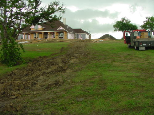

Here's what we did today.

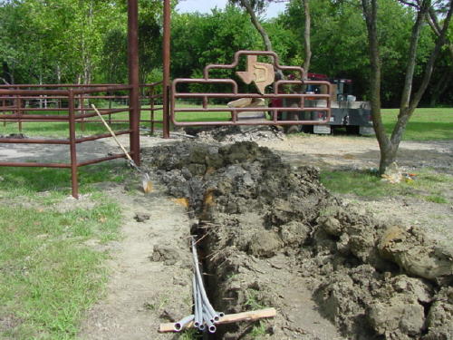

Saturday morning I cut the drive, placed a shishkeepotfull of pvc conduit and backfilled. A couple of hours later two inches of rain fell in about forty five minutes.
nice /forums/images/graemlins/frown.gif

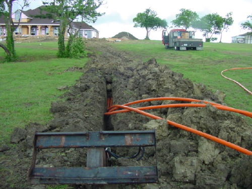

   / Remote electrical--communications cabinet

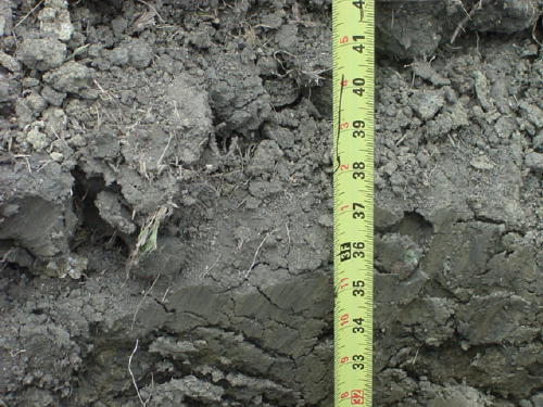

Saturday I'd also gotten about forty feet of trench done at the house end before the rain hit.
So this morning I started off with a trench full of water. This is severe clay. Notice the size of the clumps from the bucket.

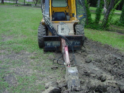

I'm using my home made back hoe attachment. The bucket is about ten inches. So immediately of course the clay makes a home in the bucket. And from then on it's like I'm digging with a flat pointed shovel. /forums/images/graemlins/smirk.gif

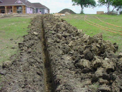

I wanted at least thirty six inch cover for the conduit.

The rain that might hit somewhere in the metroplex decided Wylie would be a nice place to visit. So I had to put the conduit in where I could and then backfill in a hurry.
