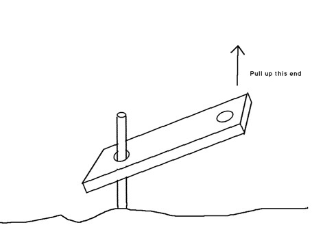

Perhaps I should explain my method more clearly: The steel rods were about 5/16" in diameter, and only about 4" above ground level. I used a length of 1/2" steel pipe to bend the exposed part of the rod at a 90 degree angle. If I used the chain link on the angle and stood by the seat to use the FEL, the rod would simply spin around and release the chain. If I stood on the steel pipe slipped over the bent part of the rod, raising the FEL a foot with the PVC pipe would yank the rod out far enough for me to bend it further so the chain link would not slip off, and I could walk back and use the FEL in the normal manner.
   / Remote FEL joystick operation #9
Piece of scrap metal and two holes:
If you don't have a thick piece, several thin ones stacked will work, too.
Bruce
