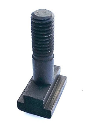

Correct, with nothing attached. I was thinking about just putting some tbolts in the lever slots with some blue locktite, still seems like there should be a better way.
