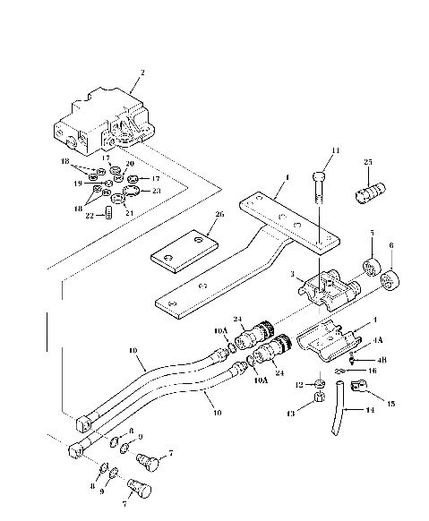

Here's are parts photo of the hyd remotes on a 4630
