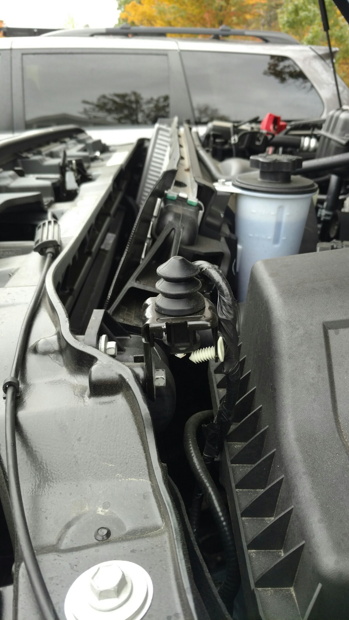

   / Remote start for Ford trucks? #5
To verify if your Super Duty came equipped with the required hood switch, open your hood and look in the driver's side inner fender near the headlamp. You will be looking for a "plunger" style switch that is encased in a black rubber boot that would make contact with your hood when closed.
It is there as a safety feature to prevent the truck from being auto-started with the hood up.
Great! Thanks!
This looks like the switch...
