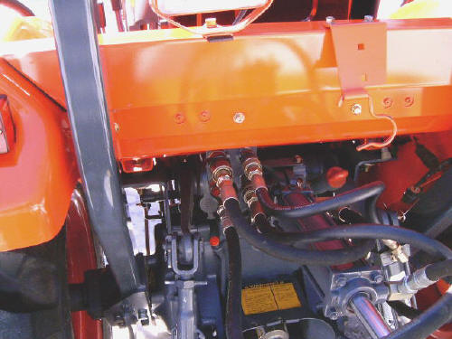

I have a few photos on the rear remotes on a DK 35 to give new buyers an idea how they can be usefull and why I recommend them when buying.
This is the controls for the remote valves.( The small control levers just in front of the position and draft control levers)

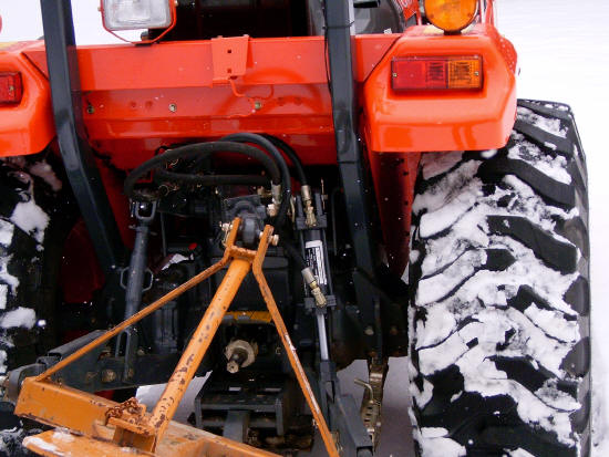

   / Remotes and top/tilt
#2
This is the remotes couplers at the rear of the machine.

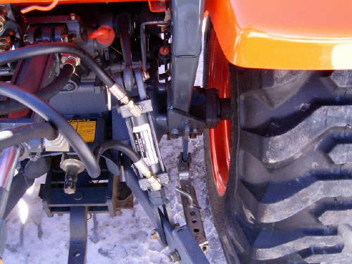

Another from the rear.
I use the remotes mainly for my top and tilt cylinders.

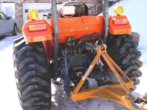

This one is for new Kioti owner/member Jim in Omaha who is considering adding a tilt cylinder.
   / Remotes and top/tilt #5
Vince, I always enjoy your posts...and pictures of the tractor. Your installation looks professional. The location of the control levers looks like a factory job...I am assuming there was nothing there before and you made the slots, etc to mount the controls? Where did you buy the components for this and what specific components did you have to buy to make this all work?
sassafraspete
   / Remotes and top/tilt #6
Vince,
Thanks. My 3054's top connection on the lift link does not have a clevise that goes around the lift arm. The is a large pin that sticks out and then a swivel end on the lift link. I know that Tractor Supply has swivel ends that you can weld on, so I might get to use my plasma cutter on this one /forums/images/graemlins/laugh.gif
Heres the links to the hydraulic stuff you mentioned:
http://www.princedirect.com/
and another I found
http://www.baileynet.com
thx
Jim
Pete,
The slots for control valve handles are already there, the controls, valves and quick couplers I used to the rear of the tractor are factory.
The remotes were availible as a kit thruogh Kioti for around $200 per set (tax Included).
The dealer installed the first set, I later installed the second set.

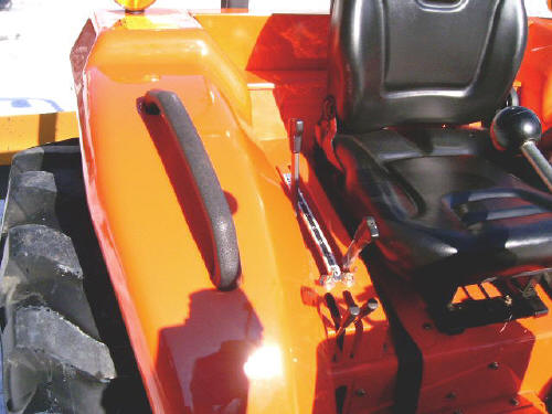

The only problem that I see here is that you can't reach through to the levers from the ground behind the tractor when hooking up an implement because of the sheet metal, etc going across. Instead of using that type control on my MF they used a "joy-stick" that is mounted behind my seat in a corner near the ROPS. I can reach it easily from the seat to make adjustments or from behind the tractor.
