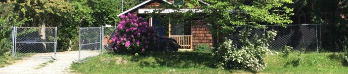

I'm getting tired of looking at this fence. My Ma-in-Law's lives there. Want to remove the chainlink because it looks like a parking lot, and replace it with a split-rail type zigzag fence. Mostly because I have huge numbers of 4-5 inch Douglas Fir trees that need to be thinned (cut out). I will have loads of fence material. The trees are 80 years old, super tight grain so I hope they will last awhile.
Here it is. Looks like a parking lot

Chain link removed, laying out the logs to see how this will go...
Thinking of screwing the rails to the steel posts.
468031d1462849310-remove-chainlink-fence-replace-zigzag-chainlinkfence-jpg

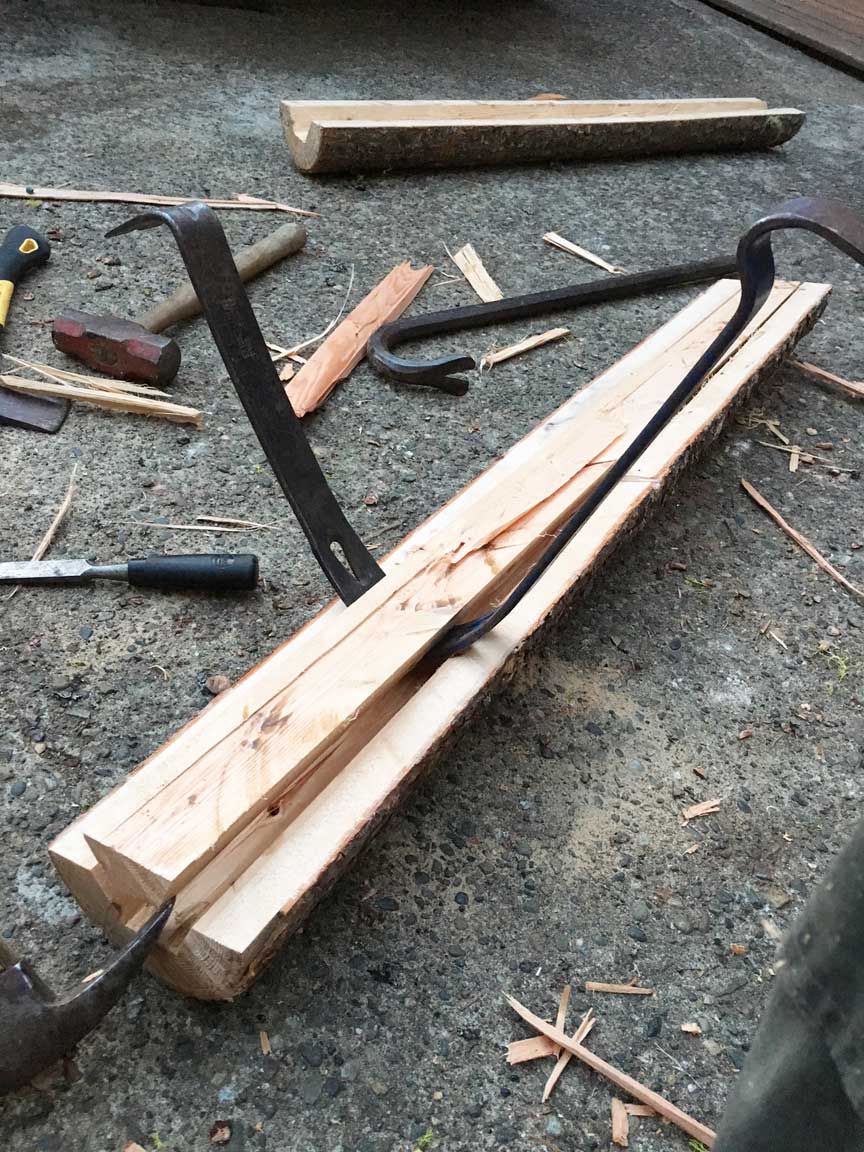

After seeing it, the steel posts were disappointing. Though about paint but covering them is a much better idea.
These posts are 6" diameter, so split them with the tablesaw, and cut at 30*.
468080d1462894052-remove-chainlink-fence-replace-zigzag-zigzagfencepost_1-jpg
Digging the core out.
468081d1462894052-remove-chainlink-fence-replace-zigzag-zigzagfencepost_1-jpg
Not so hard because there are not many branches in these logs.
468082d1462894052-remove-chainlink-fence-replace-zigzag-zigzagfencepost_1-jpg
468083d1462894052-remove-chainlink-fence-replace-zigzag-zigzagfencepost_1-jpg
Ultrarunner that split rail cedar fence in the background has 5/8 re-bar thru drilled holes. My brother and I built that fence 16 years ago from split cedar telephone poles (with no tar).
468084d1462894052-remove-chainlink-fence-replace-zigzag-zigzagfencepost_1-jpg
468085d1462894052-remove-chainlink-fence-replace-zigzag-zigzagfencepost_1-jpg
This is gonna go quick now, just the way I like it. I'll just screw the two halves back together, then screw the logs to the posts. Then sawzall the tops off. Any ideas for a 'cap' to hide the pipe inside?
