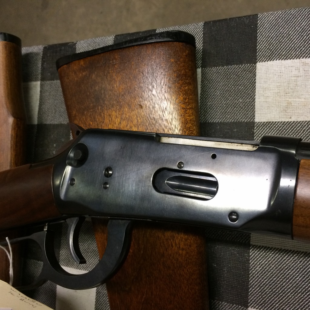

Looked at an otherwise gorgeous Winchester 94AE today in .44 mag. I can maybe get a decent price on it at auction because it has a slight scratch all along the right side of the receiver. Anyone know of a good method to "buff this out"? It is so slight as to be tempting to just leave alone vs maybe messing things up with a bluing pen or something.

I would thoroughly degrease it, hit it with a fine tip bluing pen and wipe it quickly with something stiff like a paper towel. You're trying to keep the bluing in the scratch and not on the surface of the receiver. Wipe in an up and down motion to match the current finish on the receiver. Do that multiple times until the scratch is minimized then hit it with gun oil and buff it firmly with a soft cloth. Your Plan B of leaving it alone is also a good route if you can get it at a great price. Good luck it does look like a nice piece.

Just talked to him. I forgot to write down the details but he said if it is original finish (i.e. not refinished before), you lose 25% of the value on old Winchesters if you touch them. Leave it alone. Meeting him for dinner in a few minutes and will relay the specifics on the gun. He will most likely know what it is worth but just out of curiosity, what is the current price? And just a guess...that scratch might be from a saddle mounted scabbard?

Got it. Took $675 to giterdone. So I sure hope it shoots as nice as it looks. With the little 16" barrel it sure will handle nicely in the woods. From poking around some on gunbroker.com, that seemed like a decent price. I won't worry too much about its collector value, and may try some very slight blue pen work, but I'll just try some good gun oil and buffing first.
