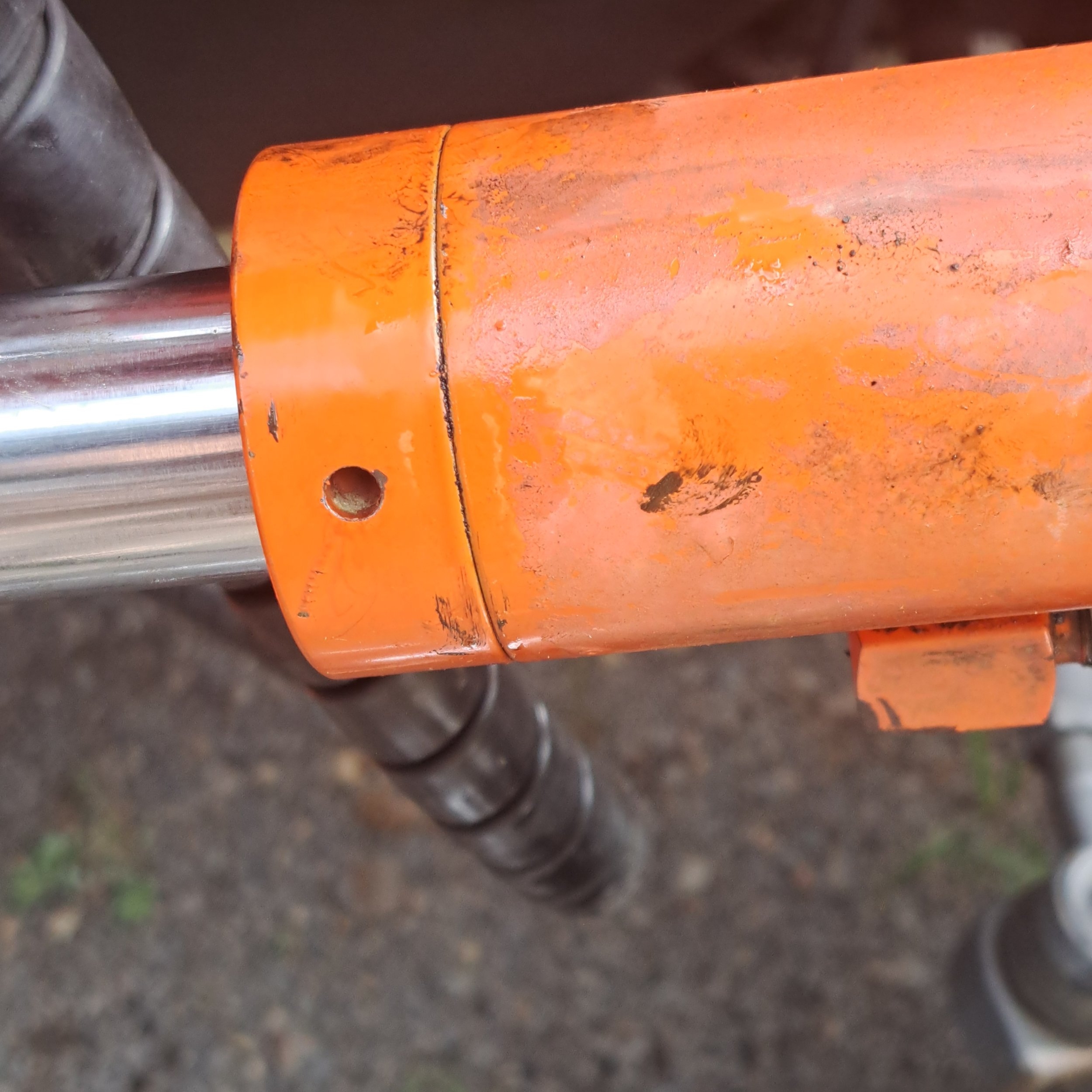

Need to find a good relatively cheap tool to help remove a cylinder end cap, with "radial" holes, picture attached. I have tools to remove the ones with holes "on top".
Bought a "gear wrench" set on Amazon, which had a video of a guy wailing away on it. Me? broke the pin off first try. And I am no King Kong. Eh, they do provide 4 or 5 sizes in the set and I needed to use the smallest on. So, guess there is that.
Regardless, I need to reseal these cylinders on a Kubota B21 bucket (TL421). The holes are 5mm max, OD is about 2 to 2.5 inches.
Don't want to take these to a shop, have seals and tools, and have done all the others myself.

When I encounter one like yours and don't have the proper-sized wrench, I insert a small steel dowel into the hole, and use it to keep the tool I spin it with from slipping. To get a good fit, I have cut old drill bits just long enough to stick out of the hole 1/4-3/16". Messed up holes can also be drilled bigger.
If the gland is already bunged up, I use a pipe wrench. For unscratched glands, I first try a very large channel-lock pliers with a rag to keep it from scratching. You can also use vise-grips that feature a leaf chain. The dowel keeps the tool from spinning on the gland.

I do have a vise grip "chain" grip around here. Somewhere. And the used drill bit is genie . . genu. . . uh, a pretty slick idea. That leads to all sorts new ways to bust my knuckles and end up on my ass when it lets loose.
Decided to try aftermarket for these. Just about half price. Always been OEM till now.

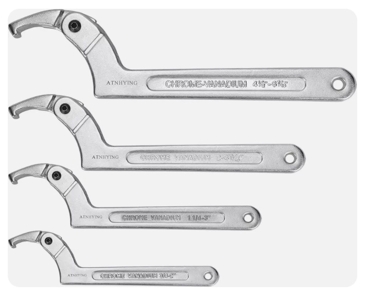

You need a spanner wrench. Just search ebay or amazon.
I think the set above was $62 on ebay.
Place it on the gland nut and smack the handle with a hammer. Tighten the same way.

That looks like the set I tried. Has interchangeable heads, pin and flat like that shown.
However I found the smallest pin, does not correctly fit the three larger tools. The cylinders are 2 and 2.5, so marginal I guess.

Yeah, those spanner wrenches Alan posted are the correct tools, but they don't always work for me. I think I only have 2 sizes, if I can find them.
If I were in the business, I would definitely have a set. But if I can improvise and not have to buy a special tool, I prefer that. It has been years since I had a B21 and a B20. Neither gave me much trouble getting the cylinders apart.
Now the Special Tool to get the rod seal inside the gland: THAT one I bought.

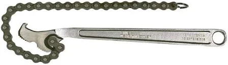

I like the idea of a semi precision fit pin (cut off drill bit) in hole of gland nut, and would be tempted to use a wrench like below with "jaw" teeth against the pin and try not to scar up gland nut as little as possible, besides it's about the only wrench I have that would possible work other than big pipe wrench.. And the floor jack handle makes really good cheater (4 foot long) ..... Might file "notch" a little deeper to get good bite on "pin".... Plus the wrench may have other uses around the property....
Bigger heavier duty version....
