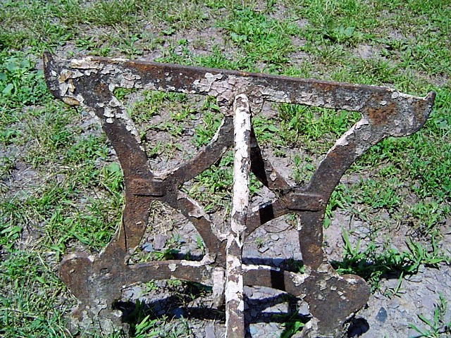

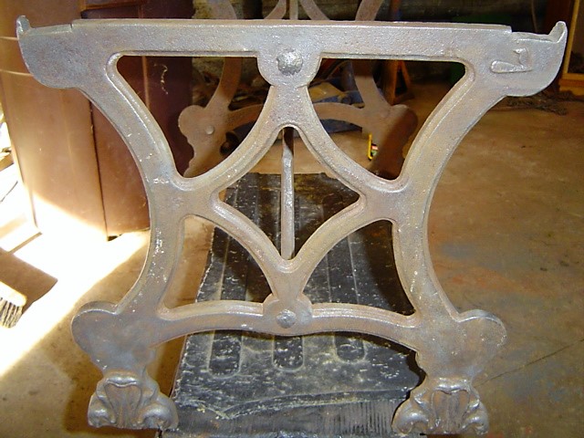

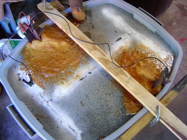

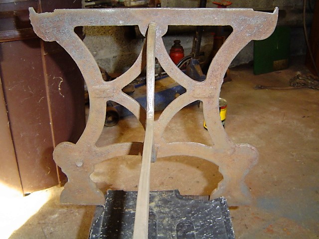

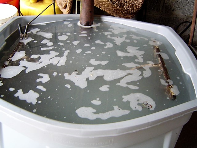

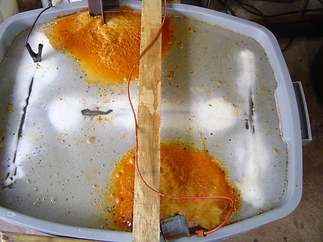

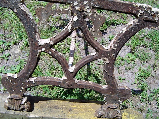

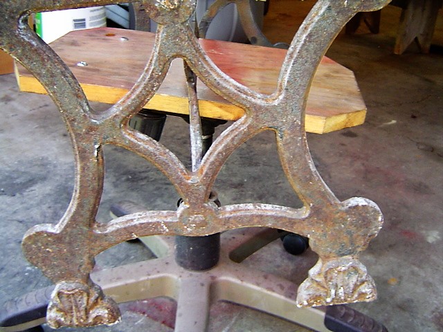

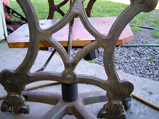

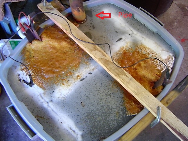

Everybody I know, who has a tractor or machinery has encountered RUST. But what I'm thinking about, are those pieces, which are frozen together or pretty nasty for refinishing. This weekend, I decided to try "electrolysis" for removing rust. You can find YouTube videos on the process. It's cheap, not much labor and effective. For my experiment, I selected a small cast iron table base, which was pretty nasty, but cleaned up good. The process, involves water, washing soda, an anode rod (or 2) and a battery charger. This particular item and condition took about 24 hours of "cooking". I pulled the piece after about 18 hours, but put it back in the bath for about another 4 hours. I cleaned off the anode rods for the 2nd bath.

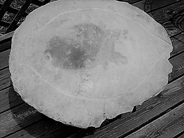

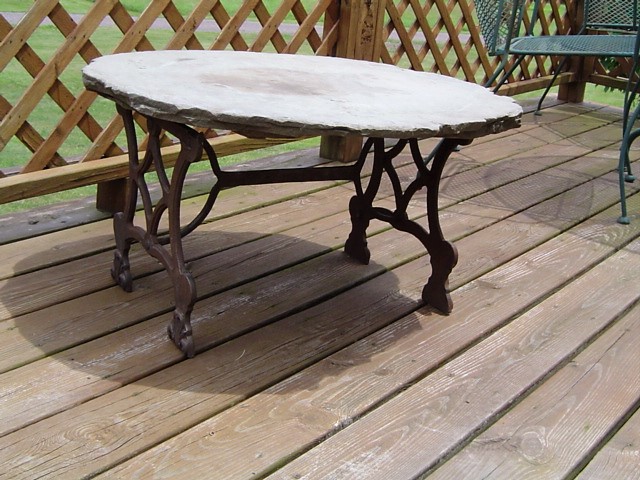

I'm not really sure, what to do with the table base. I thought, maybe, I'd place my "lye stone" on it. But, I certainly don't want to have to move it very often ... it's not like slinging an aluminum lawn chair around!

I've watched some of those videos and it's interesting. Your cast iron table base would be a great use for this process. I guess if you wanted to restore other metal objects such as weather vanes or old collectible toys it would be practical but I doubt I could find a vat large enough for my truck. :laughing: maybe put it in a swimming pool. Good job on the table base.

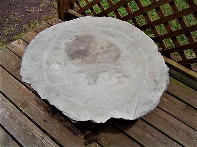

Don't see a lot of Lye Stones anymore. In the pictures the drain groove is visible are there any smaller grooves in the center or have they gone away. Is yours granite.
   / Removing Rust
Thanks, yeah, it turned out good. No "small grooves". It's not granite, ... I'm guessing, just a piece of grey stone found locally.
   / Removing Rust #5
Definitely a piece of history. I just read the link you posted and enjoyed my history lesson for the day. I know your post was about "electrolysis" but the Lye Stone stole the show. Thanks for posting it.

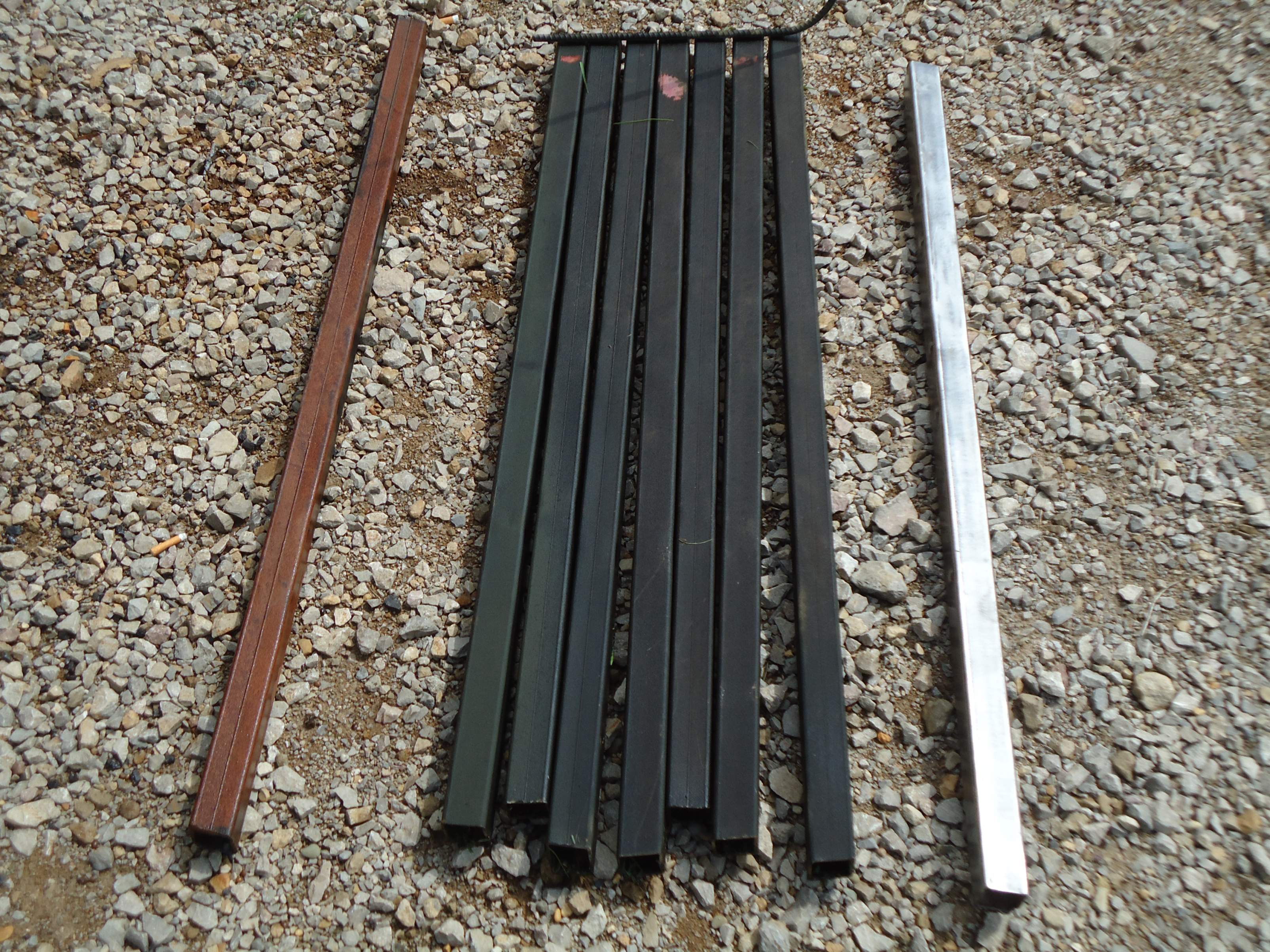

I use electrolysis a lot. I've cleaned anything from metal tubing, to garden tractor attachments. For me, it's the best way to do it.
And as for a large enough vat for your pickup, I've seen pictures, and videos of guys who have done complete care frames. They build a frame out of wood, then line with black plastic, and fill with water. I've got a large 100 gallon water trough I use for most of my projects. And one of those video's may have been mine, while cleaning some of the tubing.

I've read along the way, that water temp should be 50コ, or warmer for best results. And, DO NOT do this inside, as the process emits Hydrogen gas. Think Hindenburg... And, do not use stainless steel as the anode, as it also produces a nasty gas.
The last couple of times, I've used my old cheapie Century AC/DC welder on the lowest setting. Only because I didn't want to take a chance on ruining my good battery charger, as the old one I used, finally bit the dust. Being the lowest setting is 20 amps, it does some serious bubbling. Also read anything above 3-5 amps, is a waste of heat & energy. So be it, it works great...
Here is a short video of me doing some tubing in my old water trough. Tough to see the bubbles, until I zoom in. Rust removal 001 - YouTube
And, a picture of before, after treatment, and after polishing off with a cup brush, some light steel tubing I did. The great thing, unlike chemicals (vinegar, etc.) that will eat metal, this only affects the rust.
