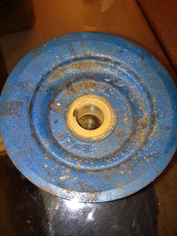

That cost got me really thinking about just how bad the pulley is. Here is a picture of it - what do you think?
The center ring is from where the washer was. Apparently it was loose for some time. I was thinking maybe I could just add another washer and replace the bad shear key to tighten it up.

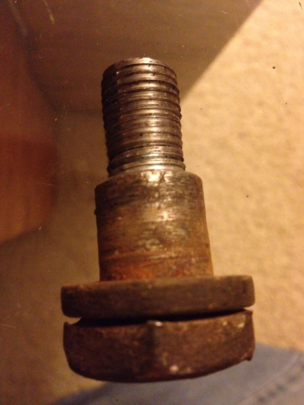

While I am taking pictures, the second one is of the blade bolts - the threads are obviously bad, but do you think the shaft these go into is just as bad, or is it usually one or the other that goes bad like this? Maybe I could just run a tap in to clean it up?

Pulley looks okay from the picture. Replace the washer and key. I can't tell from the picture what kind of shape the keyway is in and I don't know what the shaft looks like, but if there is some side-to-side in the key slot and you don't want to replace the damaged parts, install the key with JB Weld, put the pulley on and go. You will play h*ll getting back off if you ever have to work on it, but it is a 'cheap fix'.
Replace the blade bolt! It would be wise to get a metric tap for the spindle threads and clean up as much as possible so as not to mess up a new bolt. The spindle is $160., worth salvaging. The blade bolt only $17. The spindle threads might be boogered up as well, but a new bolt will at least provide some bite of the existing threads.

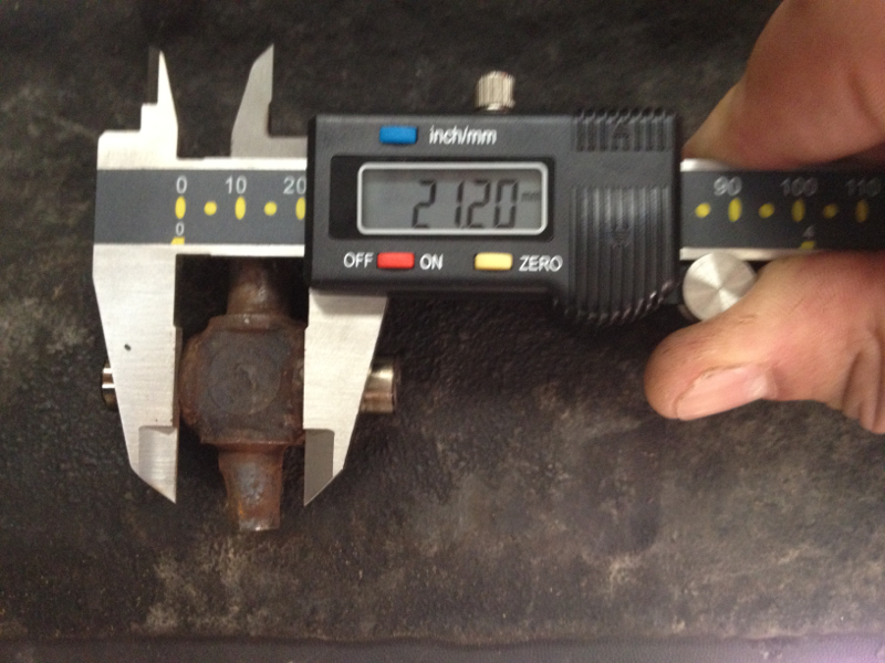

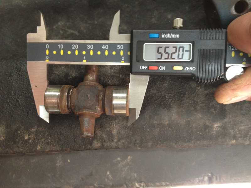

Ok, the caps are 20.02mm in diameter and from outside to outside of them is 55.2mm. The distance from the collars is 21.2mm. I attached some pics to make sure I have the correct dimensions. Thanks for the help.
