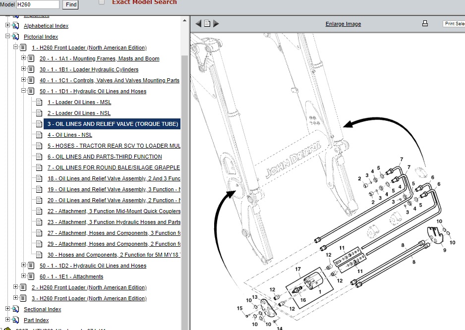

I am looking for a repair manual for a JD H260 FEL. NOT an operators manual or parts catalog.
I have a hydraulic leak in the main structural cross/connecting tube and upon opening the covers, there is an extremely poorly designed (IMO) morass of tubing and I believe a diverter valve, etc. "I do have a 3rd function integrated into the bucket, but it has its own set of E/H valves on the tractor." I have no idea what it is 'diverting' unless it is just to insure both cylinders are getting equal flow to keep the lift even.
Anyway, I have a lead from the bucket curl line. I took it in to the dealer, and they said "This is going to take a long time to do." and I needed it back for work this week, so nothing happened. I'm in fear of 'a long time' as it is hourly and I don't know what it will likely end up costing. It seems, if I have a repair manual, that I could take it apart and do it myself. I suspect it is simply a loose connection or an O-ring.
But taking things out is NOT very straight forward. The design is a major PITA, as it appears.
Any thoughts? I'm going to also post this in Hydraulics forum.
PS: I went to the dealer and spoke with them, they said it is a major PITA to deal with. They suspect it will be 4-5hrs total work + whatever parts are needed. So, likely $4-600 at $80/hr. Its likely some **** O-ring and loose connection, but it is like changing a sparkplug on a BMW.

Do you have MSL, or NSL loader? Are your third function lines factory (inside the loader)? I assume they would be.
Inside is a relief valve for the bucket cylinders, not a diverter valve.
If your third function lines are in the loader (inside) there will be 6 lines going through the torque tube. Two for the third function, two for the boom cylinders (left side), two for the bucket cylinders, left side.
Since you say the leak is inside the torque tube, and for the bucket cylinders, it has to be either a connection at the relief valve (4), or the connection where the hoses comes in the right side to the torque tube (2). Since you also say the leak is for curl, that cuts the possibility from 6 to 3 places that could be leaking, UNLESS you have a tube that has hole worn in it, which I doubt.
From looking at the parts catalog, my GUESS is you have to disconnect the two lines from the right side of the relief valve and then it pulls out the left side to access the left side lines.

For starters, you can view the schematics per the attached example in jdparts.
John Deere - Parts Catalog
Then I'd pick some parts in doubt and have your Deere dealer order them for a look-see.. to determine what you will be faced with.
Then start removing parts until you find what may be leaking.. doesn't look too daunting as I see it..
There is a seal kit (key # 17) AW36024 that may be your culprit..
