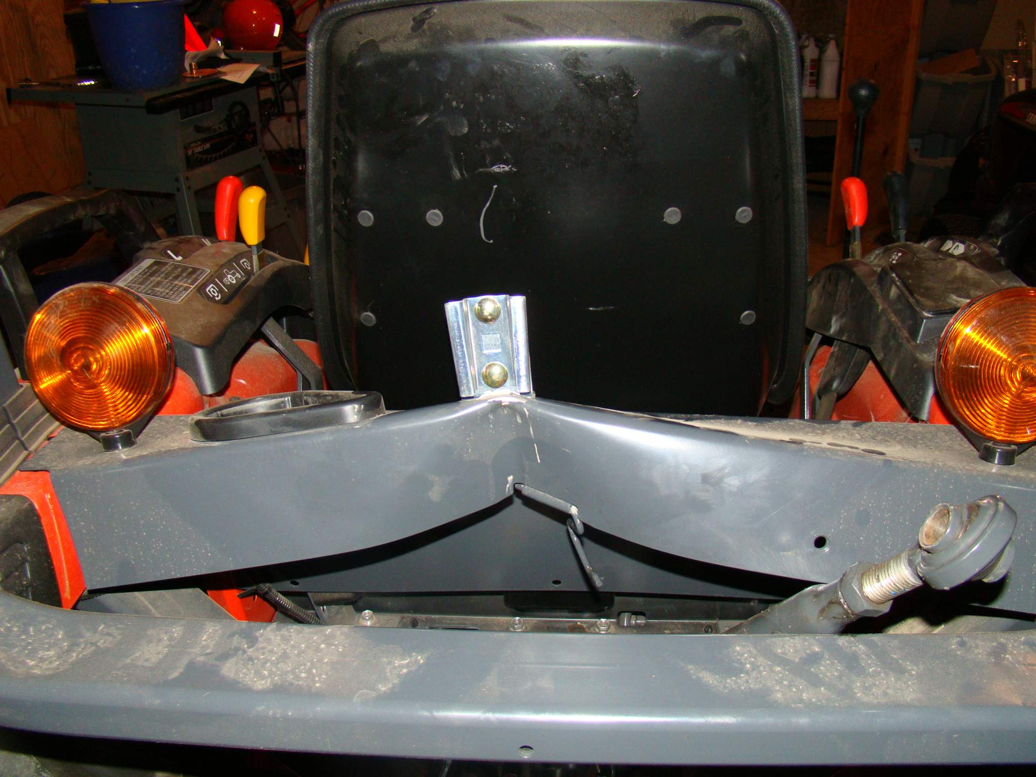

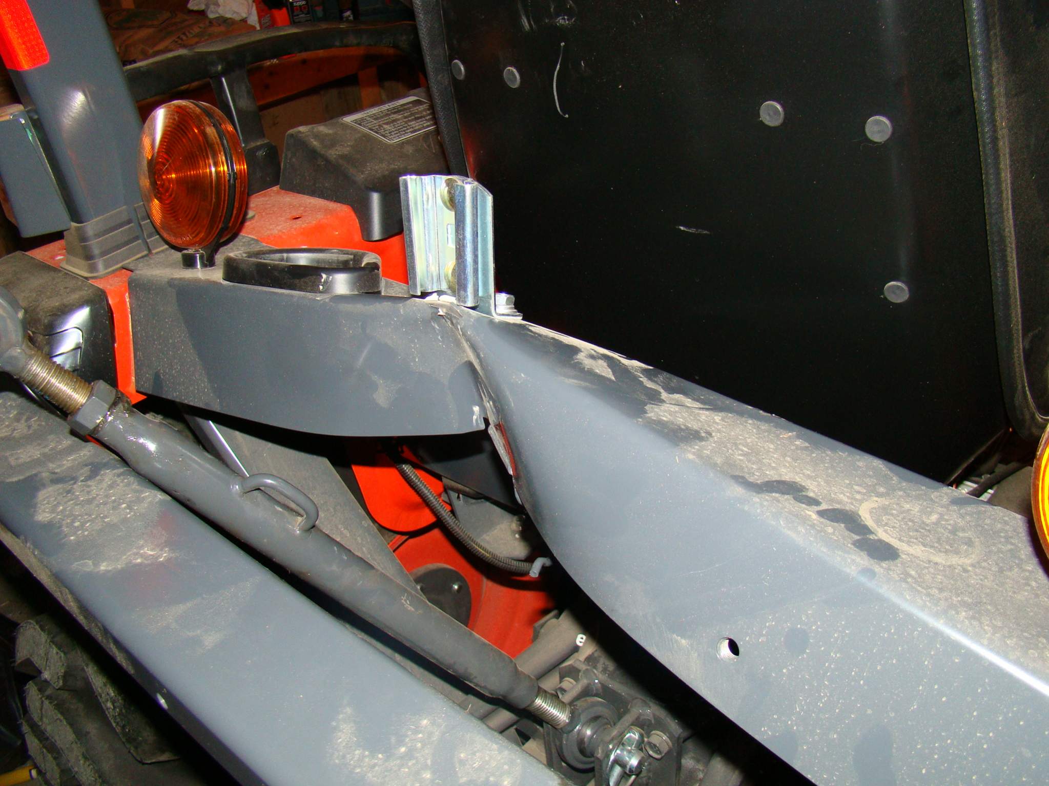

I was mowing under my son's playset with B3200 and the monkey bars caught the 3PT when I was backing up. Didn't let go until it bent that sheet metal piece beyond reasonable repair. Pretty big kiss for a tractor with less than 10 hours:mad:
Anybody have any replacement ideas or is my dealer the best bet. I hate to start half-a***** already but if anyone has good fabrication ideas maybe I could make something better (better cup holder maybe a light stand etc.).
Really my best bet is probably if kubota does replace and doesn't charge too much - Any online suggestions??

D**********!!!
That will ruin your day. :(
If it were me, I would break out the ol' Porta Power. Know a buddy that has one?
/ Repair pieces #5
Google it. you'll find out quicker than I can type. :)
Might be your best option for straightening it out without having to remove anything, and without beating it all to heck. Make sure your hypothetical buddy knows what he's doing, it does take some skill and experience to use properly, otherwise he could do worse damage.
Most auto body shops will have one as well, but obviously you'll have to get the tractor there as well as pay for the repair.
/ Repair pieces #6
Can the piece be removed? If so, perhaps you can find a sheet metal shop that can "break" a new piece for you. I will wager the dealer will want a lot for this part but a phone call to find out is free.
Or just say "what the heck" and go about your tractor work and think about it this winter.
In what state are you located?

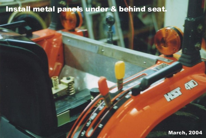

Well that's a bummer. I'll repeat what repete said :) about getting a sheet metal shop to brake a new piece for you. My B7800 did not have that piece, so when I built my cab that was the very first piece I did. I bent it myself using a vise and 2 pieces of angle iron (that exercise prompted me to buy a cheap sheet metal brake for the rest of the cab build). I'm guessing the genuine Kubota part would be rather pricey. Good luck however you go with it.

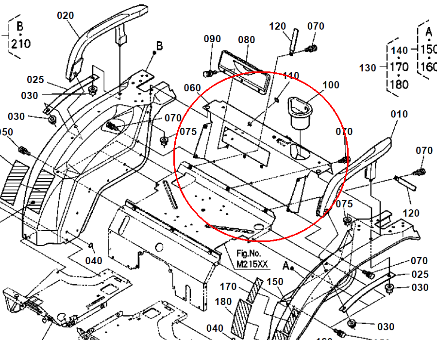

This is a pretty straightforward fix any decent body guy can handle, and without taking much of anything apart.
Look at the attached picture. Let's assume a sheet metal guy would make up this piece, with all of the correct dimensions, bends, welded-on captive nuts, etc., and it actually fits properly. It's going to take a fair amount of labor, and it isn't going to be cheap. Then it has to be painted. It will probably end up costing more than the new part from Kubota.
I would rather put the money toward fixing the "genuine article". And if that looked to be expensive, I'd still get the new part from Kubota. It's worth calling your dealer to get a price on it, so you at least know.

In case anyone was wondering (I am always amazed at the price of replacement parts) Kubota charges $130 for that piece but I found one that came off a new tractor (I guess the backhoe has a different set up so this piece gets removed) for $50. Can't really justify anything but buying the new one for $50.
BTW dealer told me this repair isn't uncommon and suggested removing the top link when not in use.
