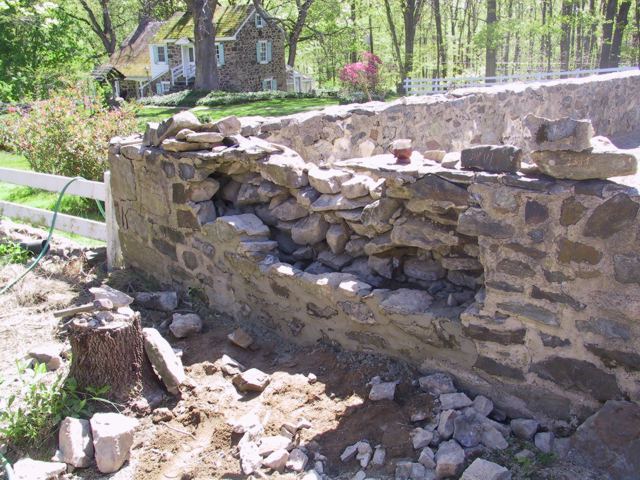

This part of the wall has been bugging me for 2 yrs now - we're putting in a goat pen on this side of the wall, and I figured they would knock down the rest of it eventually if I didn't do something about it.
   / Repairing a stone wall
#2
The wall was built as an inner and an outer wall, with rubble stones and dirt filling in the gap, and the top capped off. That stump probably didn't help, and the rest of the damage is freeze/thaw problems brought on by cracks in the mortar up top.

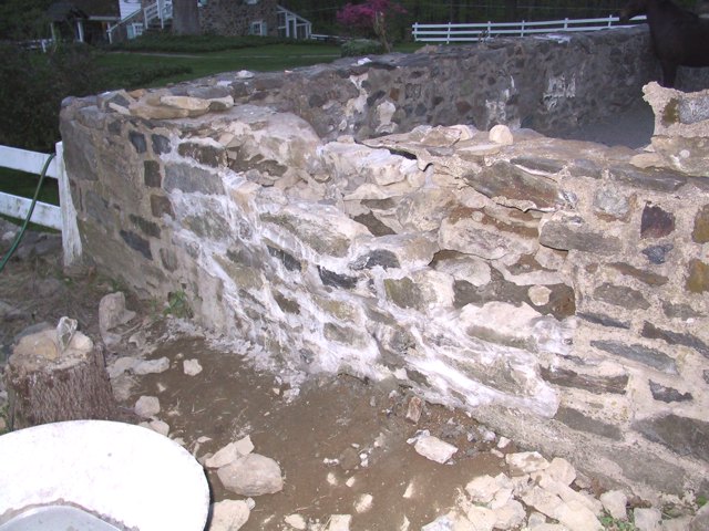

First I repointed the inside of the wall to hold it up (it's only bowed at little), then I tore the loose stuff off the outside. It's on the way back together here.
Getting there....

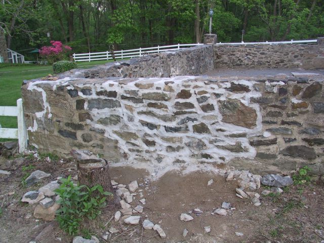

Done! I filled this section back up with stones and bags of dry concrete, then sprayed it with the hose.

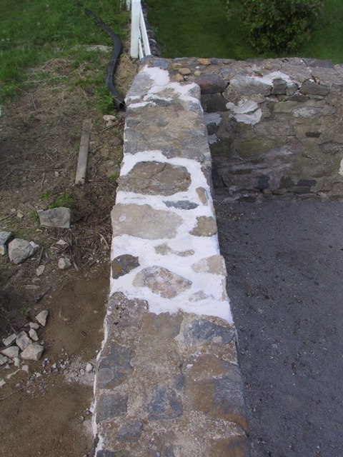

Last one - top view. My mortar color isn't quite what I'd like it to be, but I didn't have time to match it. It will mellow with time some.
