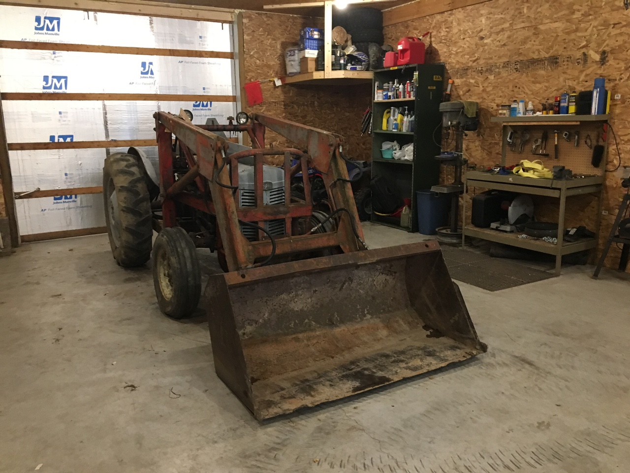

I own a ‘56 MF TO 35 with a loader and am considering a newer (preferably used due to cost) compact tractor. The loader for it is way too large and no amount of ballast fixes that, no power steering, no 4x4, and feel like it’s a ticking time bomb before more stuff breaks. I have 6.5 acres of property in Michigan with a mix of yard, field, and woods. I use a 5’ brush hog for paths in field and woods, 5’ box blade for grading gravel driveway and landscape projects, and loader for snow removal, landscaping, downed trees, large rocks, etc.
I’m open to different brands. I think around the 30-35 hp mark is what I want/need but feel free to debate that. I have looked at sub compacts but don’t think they could handle my 5’ brush hog and box blade well plus limited loader power and ground clearance. I’m also think going over 40hp is overkill in terms of power and size and the prices rise quick.
What I’m looking for help on is what would be a good replacement tractor for what I currently have. I would like something that: will handle current implements, is 4wd, cat 1 w/540 pto, loader, is reliable and will last a long time without issues, at the lowest price point possible. I am not loyal to any brands, I don’t care about fancy features, comfy seats, cabs, etc. I also do all of my own maintenance so something I can maintain. I have found JD, Massey Ferguson, Branson, and New Holland dealers near me. I sat on a MF 1735e that seemed nice and the area is flooded with used JDs. Can you guys recommend brands/models that you think would fit my needs?
Thanks in advance,

the large rocks and downed trees are the only obstacle i see for you regarding size/weight - you are going to be up over 4000 lbs with your unit including loader so consider that when looking at the 30+hp units
3515R - Branson Tractors is around 3000lbs and add the loader you are up around 3500 i would guess but looking for used items might be difficult for Compact tractors in that brand just due to the amount of them around vs a JD/NH or MF.
3 series deere are going to be a lil on the lighter side so you might want to look at a 4 series
Massey.......1735E sounds like a good fit for power/weight if you can find one of those I havent heard any horror stories on those personally but id do some digging just in case.
N/H would be harder to find also just due quantity used - something like the boomer 33 or 37 is the current model you could go with a workmaster but they are a shuttle not a hydro trannie
here is a nice kubota - Kubota L354HSTC 4WD 37HP Tractor, Cab/Air/Heat, Loader, SSQA Bucket - farm & garden - by dealer - sale
so lots of options!!!!
I use a 5 brush hog for paths in field and woods, 5 box blade for grading gravel driveway and landscape projects, and loader for snow removal, landscaping, downed trees, large rocks, etc.
A Kubota L2501 should nearly meet your requirements. It is is one of Kubota's largest volume current models and many are available used.
An L2501 is simple mechanically. L2501 will be one increment smaller/lighter than your TO35.
Bare weight of L2501 is 2,700 pounds.
Ferguson TO35 is about 3,500 pounds, bare tractor weight.
I'm open to different brands. I think around the 30-35 hp mark is what I want/need but feel free to debate that.
Due to the requirement that new tractors over 25-horsepower meet stringent Tier IV emission rules, which requires two stages of emission upgrades over older models, new tractors jump from 25-horsepower to about 33-horsepower with very few, if any, new tractors around 30-horsepower.
What I'm looking for is a good replacement tractor for what I have. I would like something that: will handle current implements, is 4wd, cat 1 w/540 pto, loader, is reliable and will last a long time without issues, at the lowest price point possible.
I am not loyal to any brands. I do all my own maintenance so something I can maintain. I have found JD, Massey Ferguson, Branson, and New Holland dealers near me.
SEARCYFARMS made a very high quality recommendation to you, but you dismissed it in your lack of product knowledge.
This Kubota L3540 was the last mid-30-hp Kubota produced before Tier IV emission controls became mandatory. You should give this 3,600 pound bare weight tractor consideration. It is a gooood price for that model. Difficult to find deluxe model tractors that are simple. This is an example of deluxe + simple. It will handle all your 60" implements with ease.
I don't care about fancy features, comfy seats, cabs, etc.
You will.
