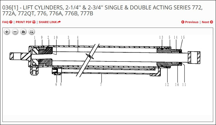

Hi,
I have a 1982 Ford 4610 3-cyl diesel tractor that came with a front end loader (Ford 776A Loader).
The previous owner damaged the two lift cylinders and they may not be repairable.
The OEM replacement cylinders are pricey from the dealership.
I would imagine you can buy brands other than Ford/New Holland?
If so, how would I know what to buy?
It looks like cylinders are sold by diameter and stroke, is that right?
I didn't notice the diameter or stroke dimensions on the Ford/New Holland branded part.
Is there a way I can find out the diameter and stroke so I can shop around for cylinders?
I am new to this so please forgive my ignorance.
Chris
   / Replace Ford 776A loader lift cylinder - what size is it? Aftermarket parts available? Ford 4610 #2
Photos of the damage would be helpful.
If you go into dealer website (like messicks.com) and enter the loader model No. you can find which parts are available, and it indicates either 2-1/4 or 2-3/4 inch lift cylinders.
It's a good start.

One cylinder is missing. The previous owner thought it'd be a good idea to use the loader to knock down an oak tree and rammed it so hard it bent the rod on the hydraulic lift cylinder. The second was laying in the pasture and the shredder hit it, tearing a hole in the cylinder.
The rod measures 1.375" OD. The Cylinder OD is 2". Measuring the length it looks like it's maybe a 30" to 36" stroke.
