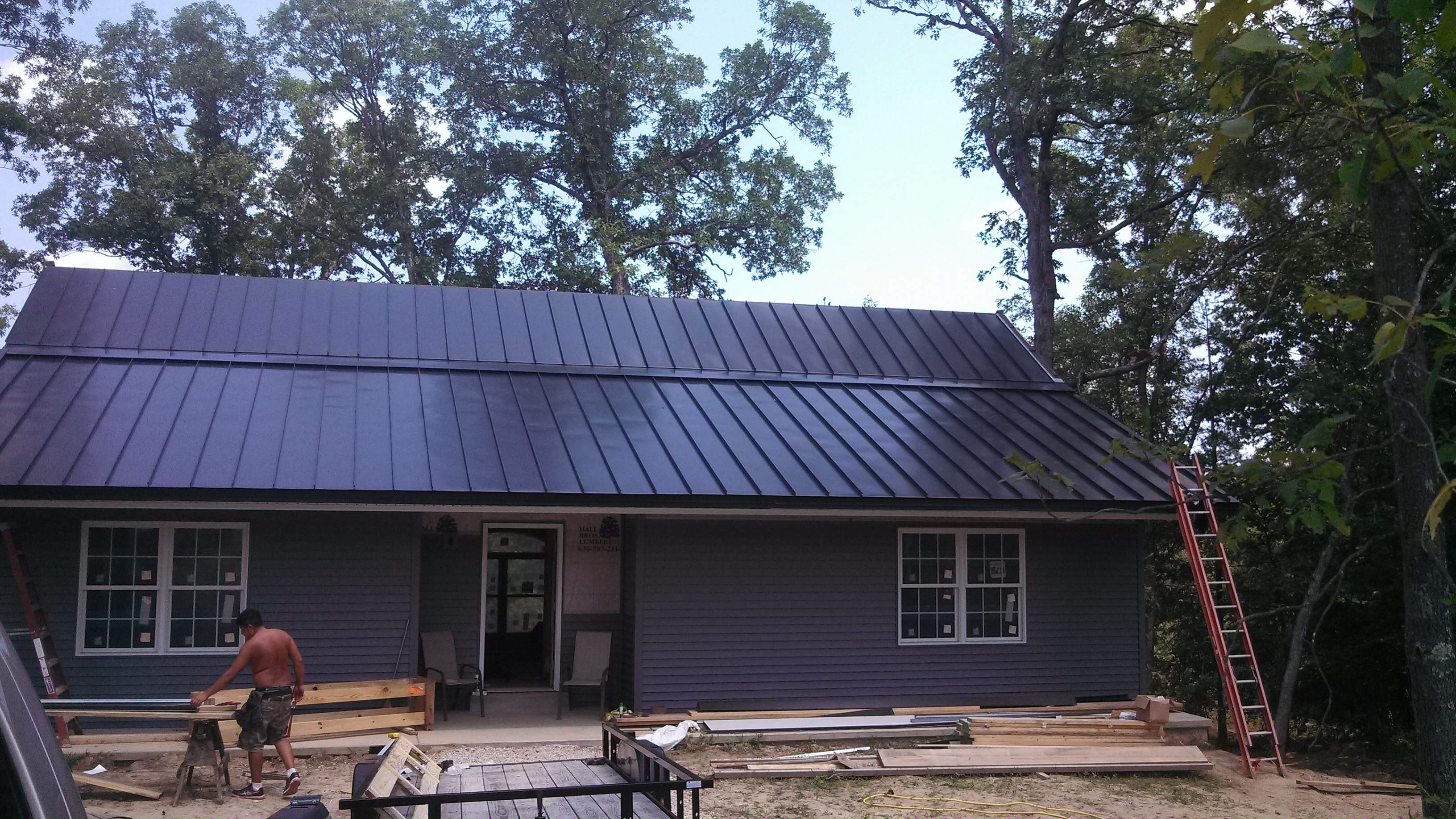

Here is pic of roof we just put on our new house last summer. Was going to go with a screwed down,"strong panel" type,but got talked into standing seam by my brother,real easy for him to spend my money. IMG_20130817_123650_496(1).jpg

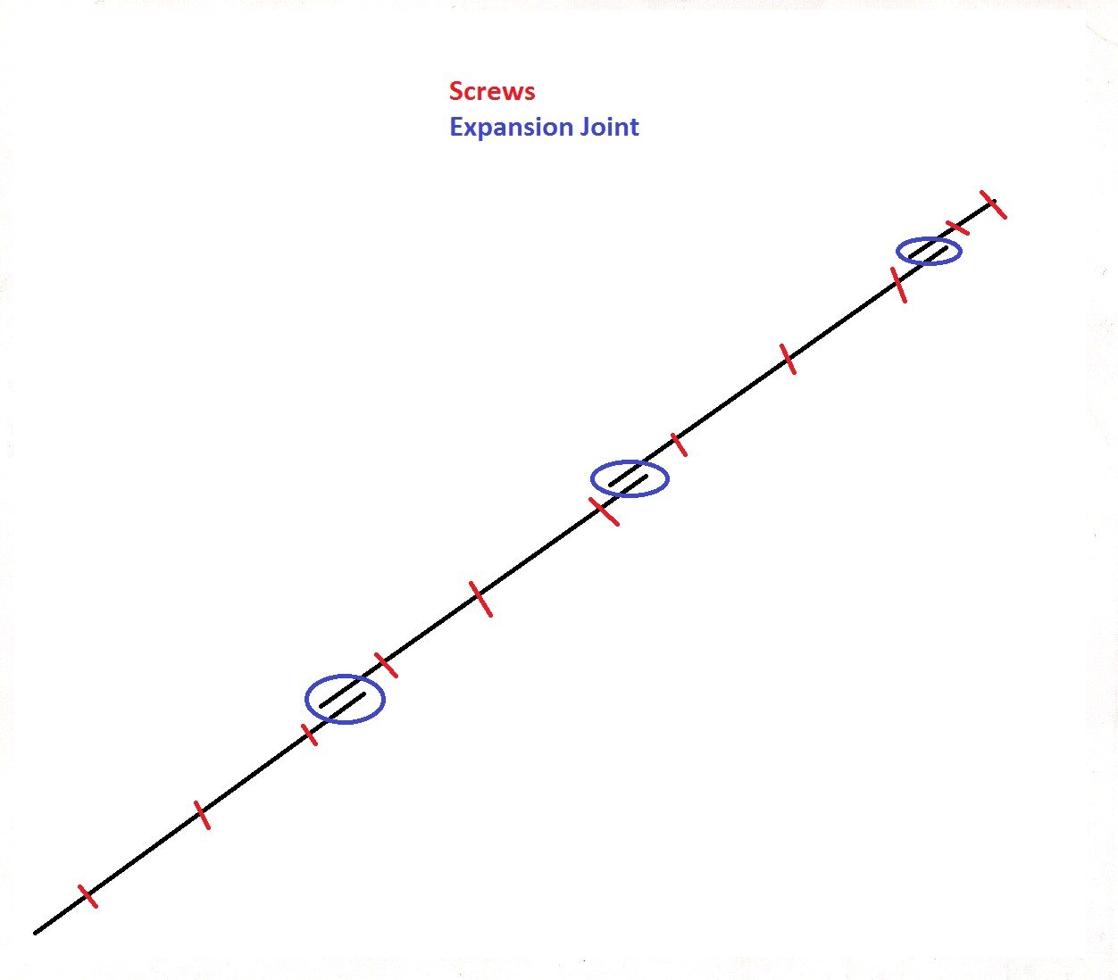

The main part of my barn is 56 feet wide with about a 4/12 pitch so that makes for some long sheet of tin. The purlins are a full 2x4 having been milled out of poplar from on site trees. Like already mentioned by others, the roof makes a lot of noise when it expands and contracts.
Who would have thought that the builder (and I use that term generously in this case) would have used only 3/4 inch screws to hold the tin down? Every time I get a leak, I replace the screw with longer ones. I don't know that I will ever get them all done, lol!
A friend of mine did that...... What happened when all the screws were replaced ????????? The long screws held.... The panels had elongated holes ripped in them....... The sheet rock on the ceiling got soaked with the next rain and fell .....
Up until now the screws just pulled and that saved the panels from ripping.... When steel wants to expand, you have to let it.... Trying to stop it just don't work.....
To save your roof, cut the 56' panel into 4 each 14' panels.... overlap 6" or so and refasten down... get some extra panels and add the needed length on the peak to fill the gap from shortening the panels...... AND DO NOT PUT SCREWS IN TO HOLD THE PANELS TOGETHER.... LET THE PANELS OVERLAP AND SLIDE UP AND DOWN WITH THE TEMPERATURE.....
