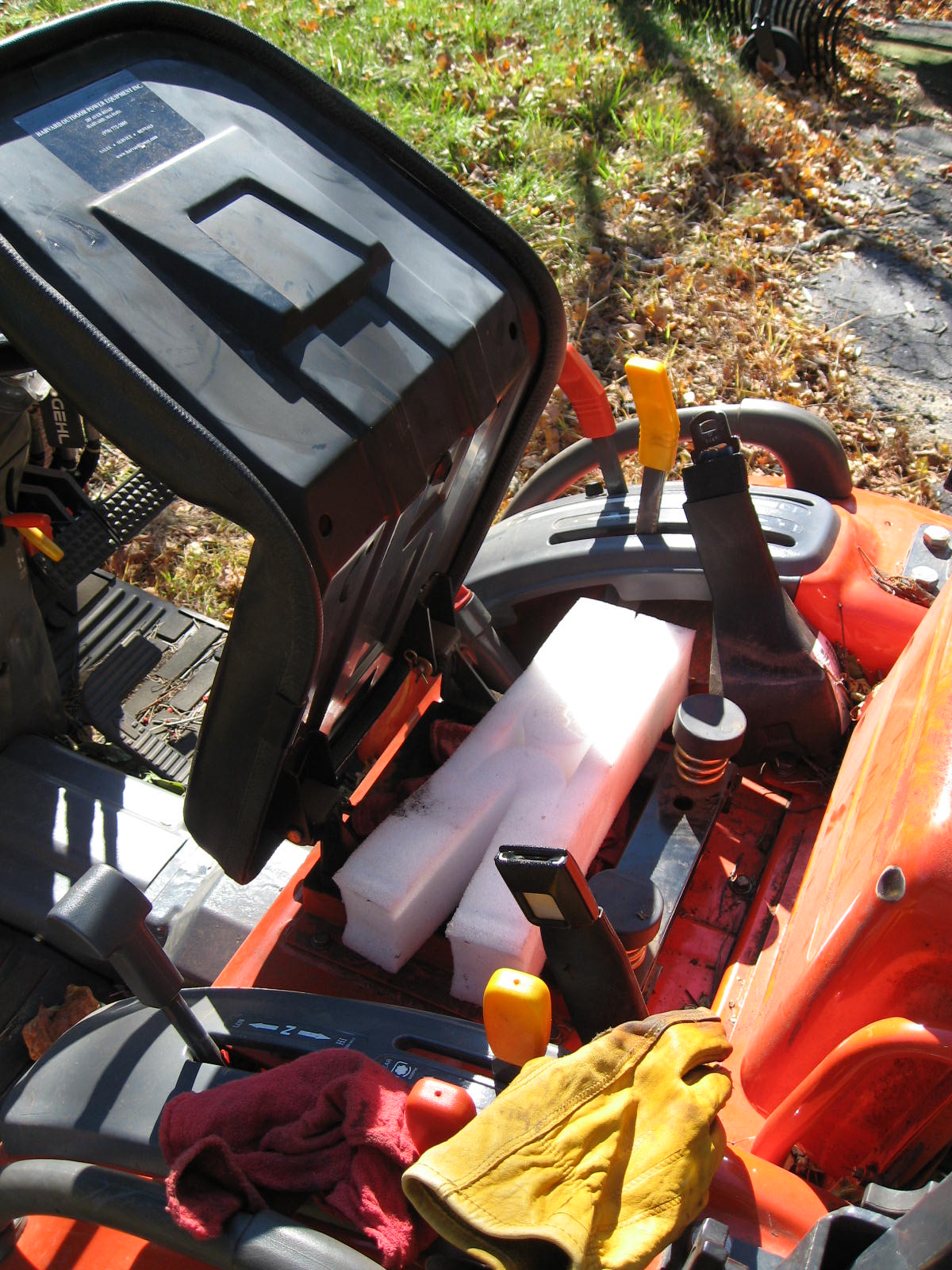

I have a 2004 Kioti CK20 (before suspension seat became standard). I am 6'5" and 230 so I bottomed out when traveling in bumpy areas. Problem solved by sticking a chunk of fairly stiff foam under the seat. In my case it just happened to be a handy used washing machine drum protector from U haul but the critical points are that 1) it was stiff and 2) it was almost exactly the same height as the uncompressed spring. See photo. Works well and is cheaper than buying the new Kioti suspension seat for $600.:eek:
