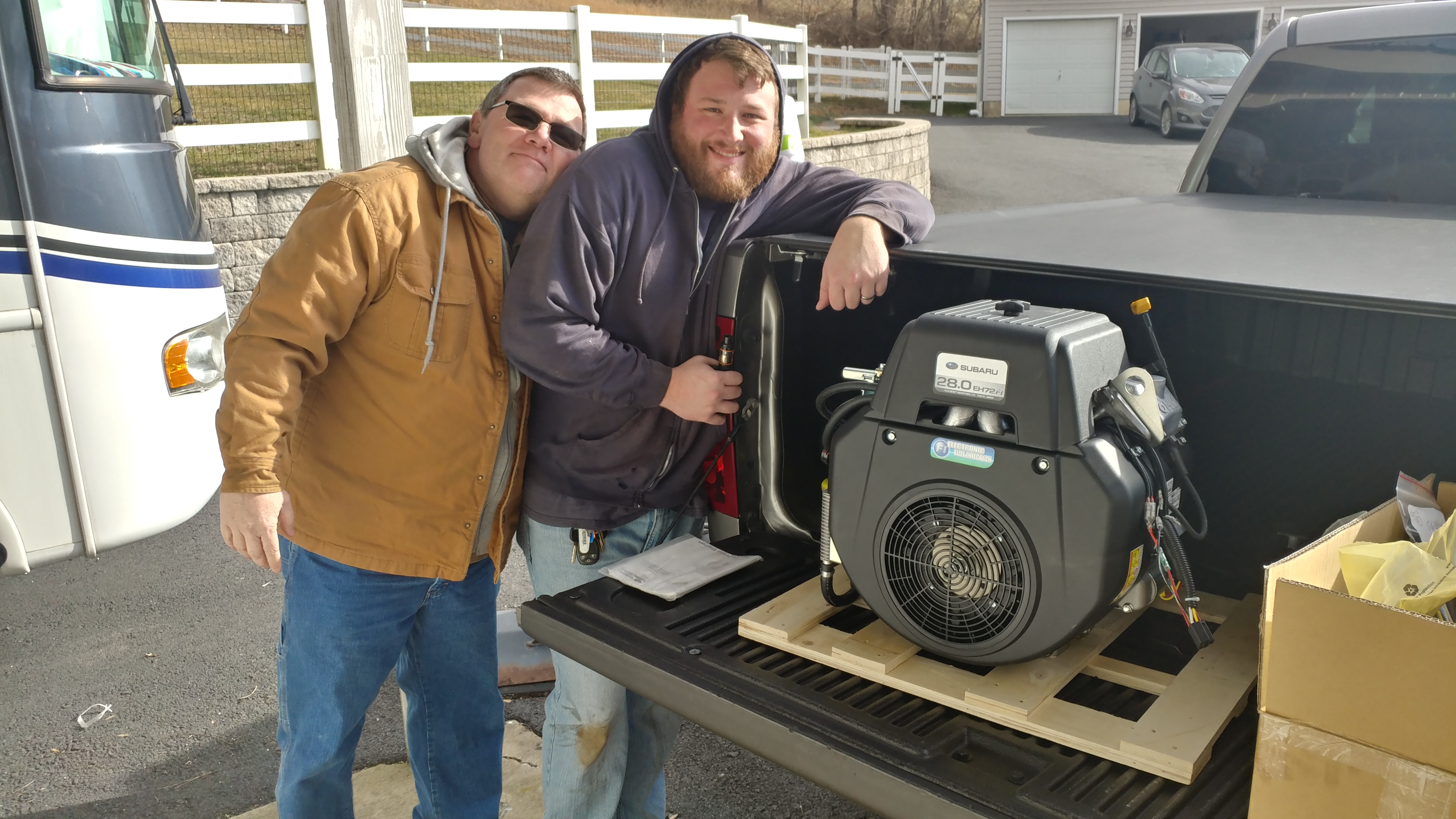

Replaced my Robin 25 HP Because I wanted to be one of the boys...

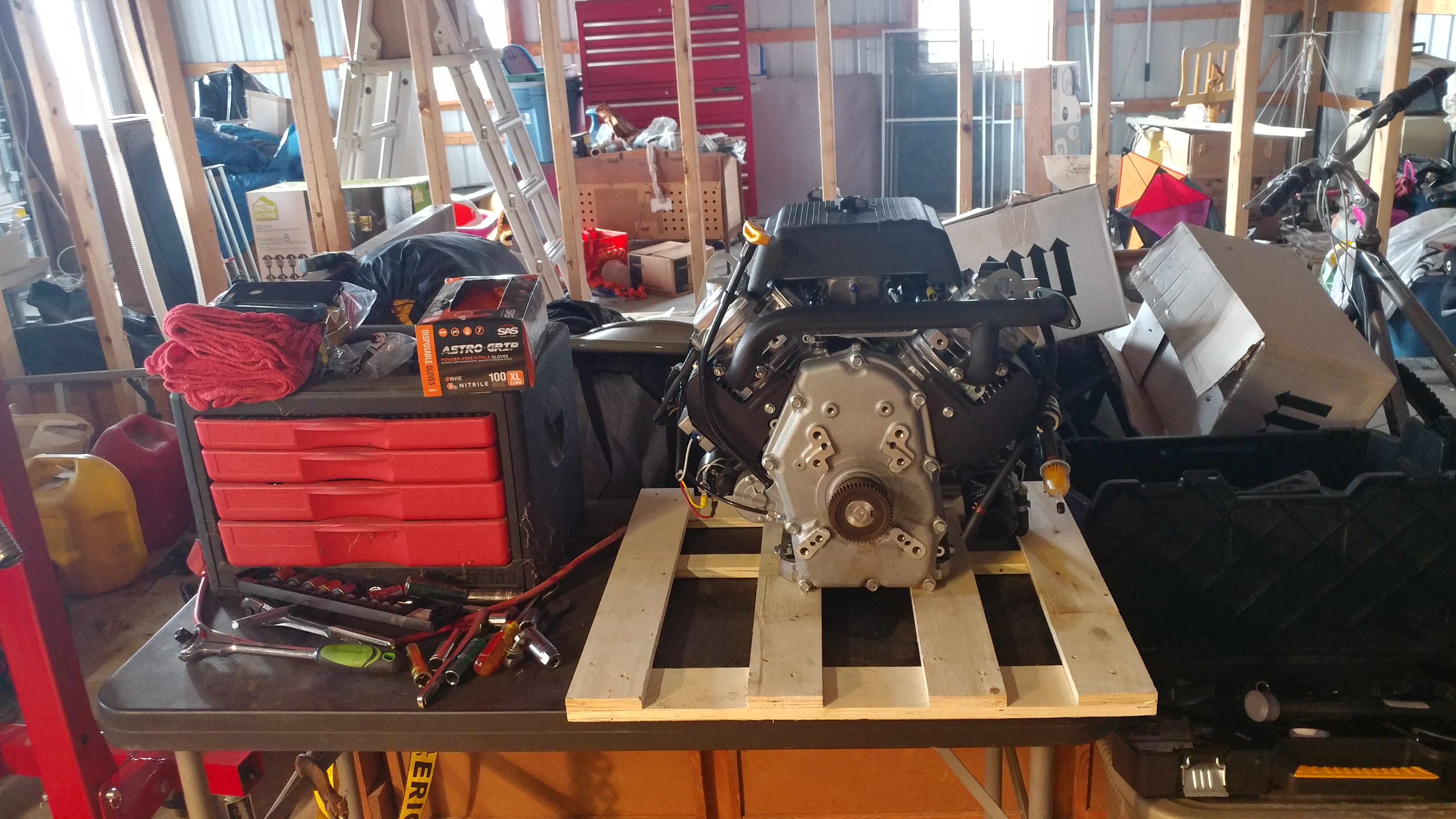

After a fair amount of reading on here about the 28 hp EFI engine and seeing the it was pretty much a painless swap out, I decided to replace my Robin 25 hp that came with my 425 with a new Robin fuel injected 28 hp engine. I was hoping for two things, 1. easier starting in cold weather and 2. a few more hp that would enable me to mow easier on the slopes in my south-central PA yard.
I spent a little time on the phone, (ok, more than a little...), with Kent and then called my local dealer Wes Stauffer Equipment LLC in Ephrata, PA to place the order. Wes is a great guy and I have been buying parts from hims for the past 5-6 years. Always gives me a great deal.
I ordered the version with the larger crankshaft to match the 25HP engine, labeled "AB Normal" in the 425, and it was... Robin makes two versions, the 1-7/16 crankshaft version is the one I ordered which is a direct match. This meant that the geared coupling could be reused from the old engine and Wes would cut the shaft to length and mount it for me. Since I don't have a portable metal Bandsaw, I took him up on it.
I also ordered the Robin muffler kit, heavier version for $179.00, some heavy duty fuel line and 1-SS flexible exhaust.

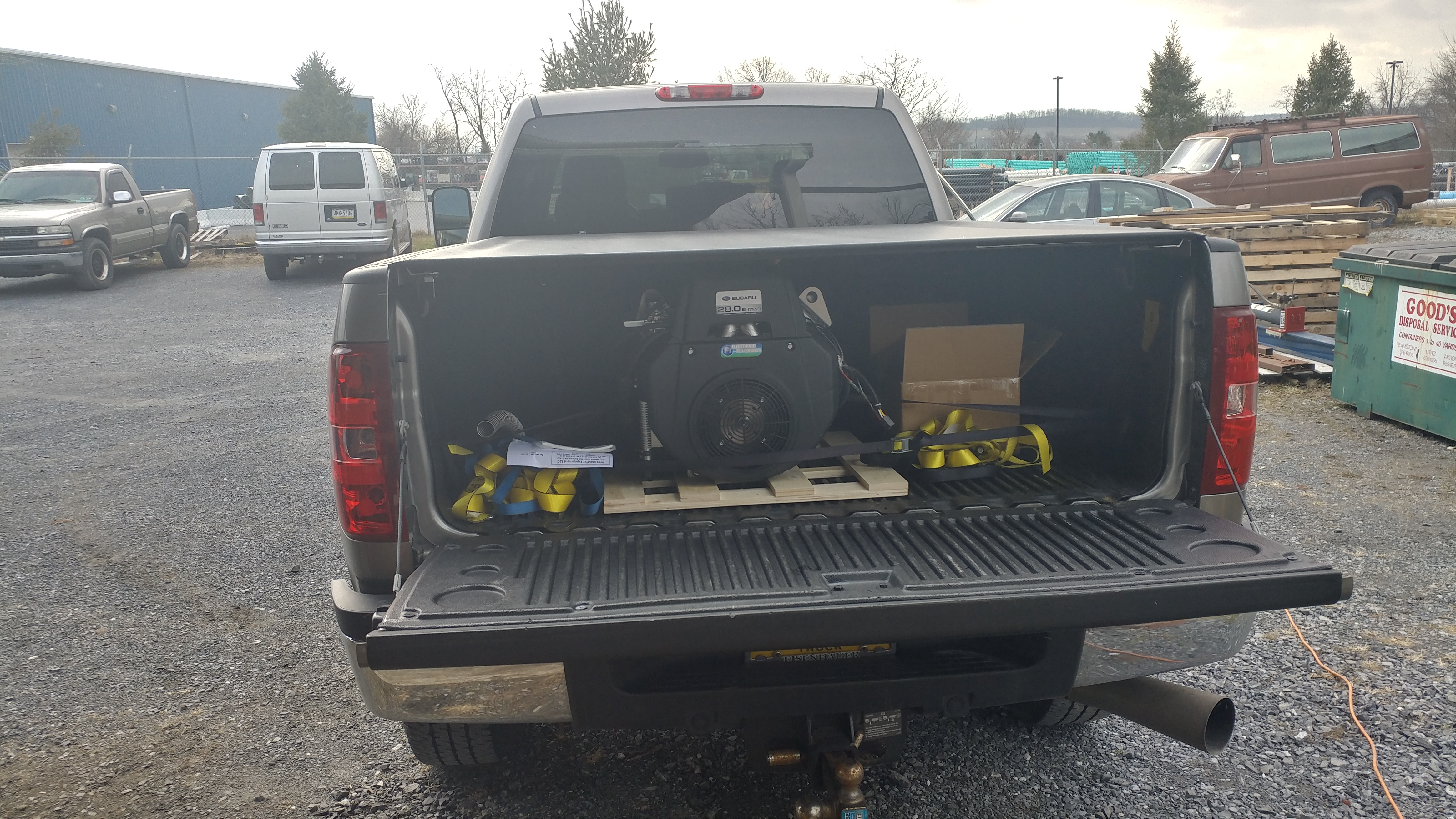

We pulled the existing "AB Normal" engine out and took it to Wes. A week later he had my new engine ready to go. My brother in law, nephew and I took the truck over there and picked up the engine.

We carried the engine into my shop, (you guys remember when I built that, and place it on a work table.

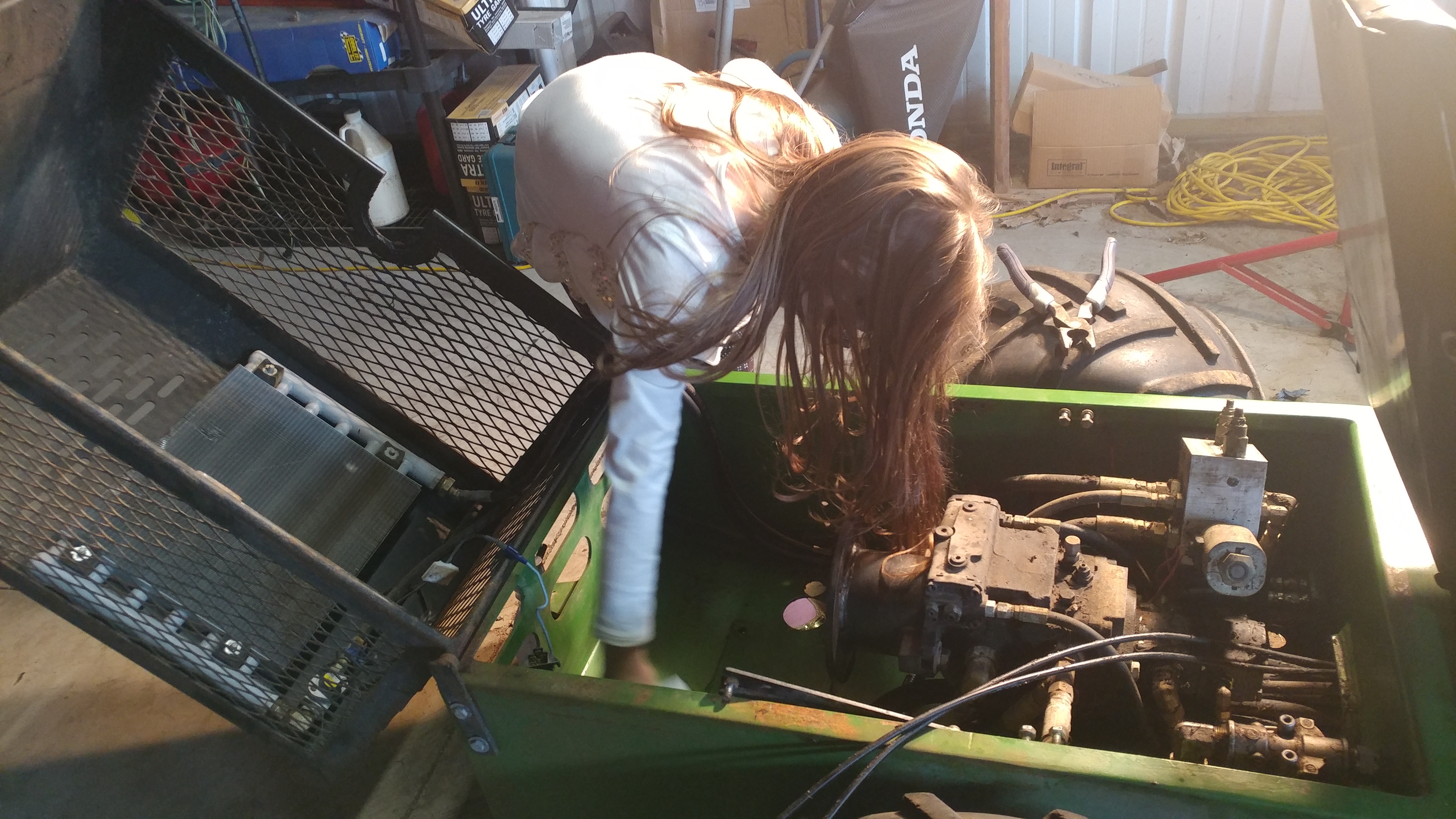

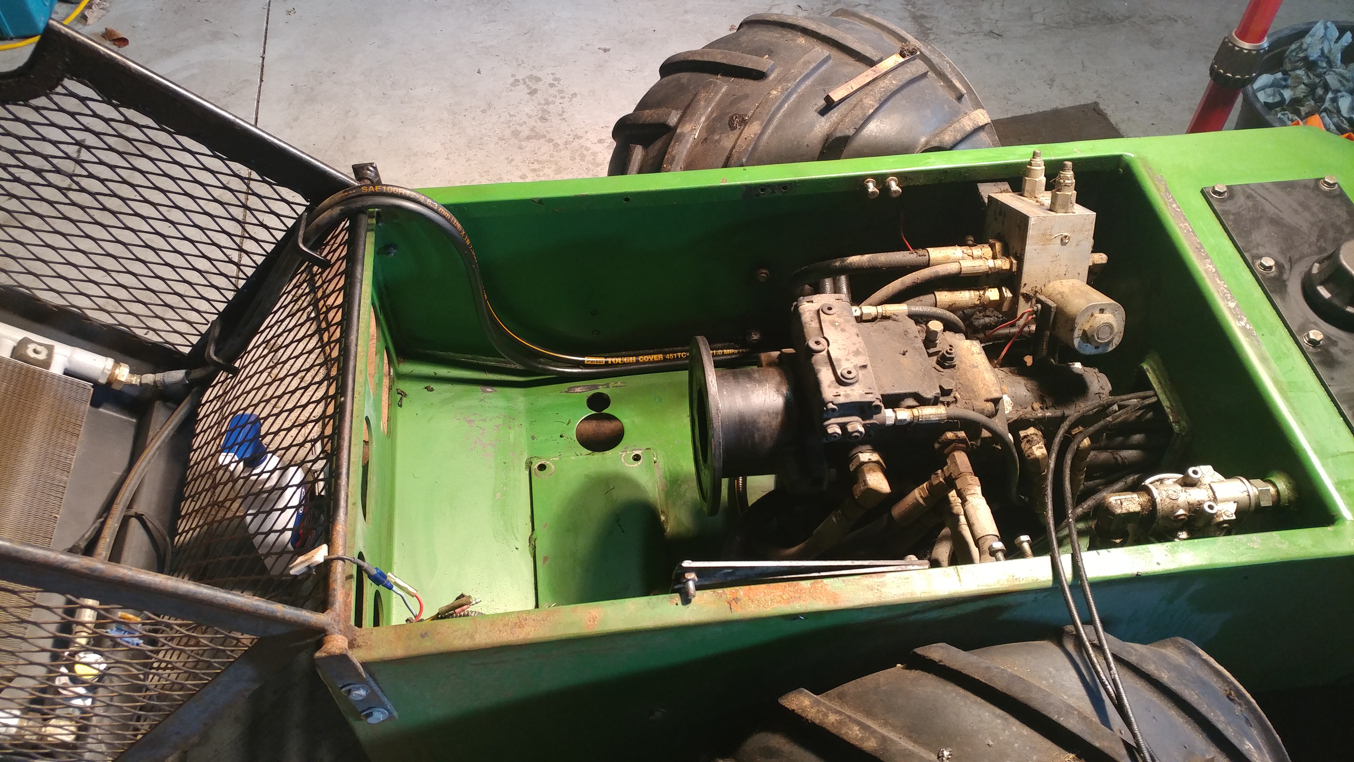

Then our two assistants helped us to clean out the engine compartment, or "Tub" as my grandson called it.
Assistant #1
Assistant #2
End result...
(of course they had a little help from cousin John...

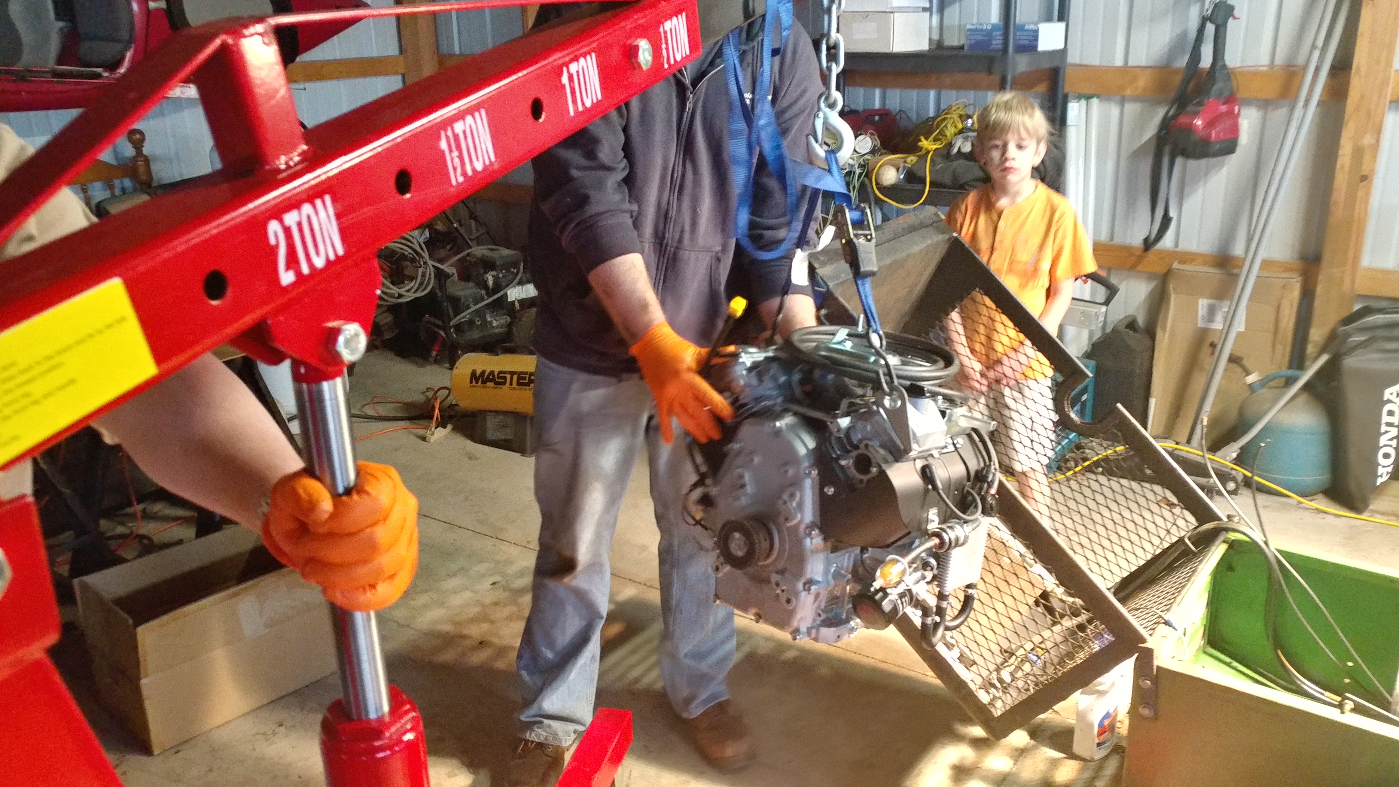

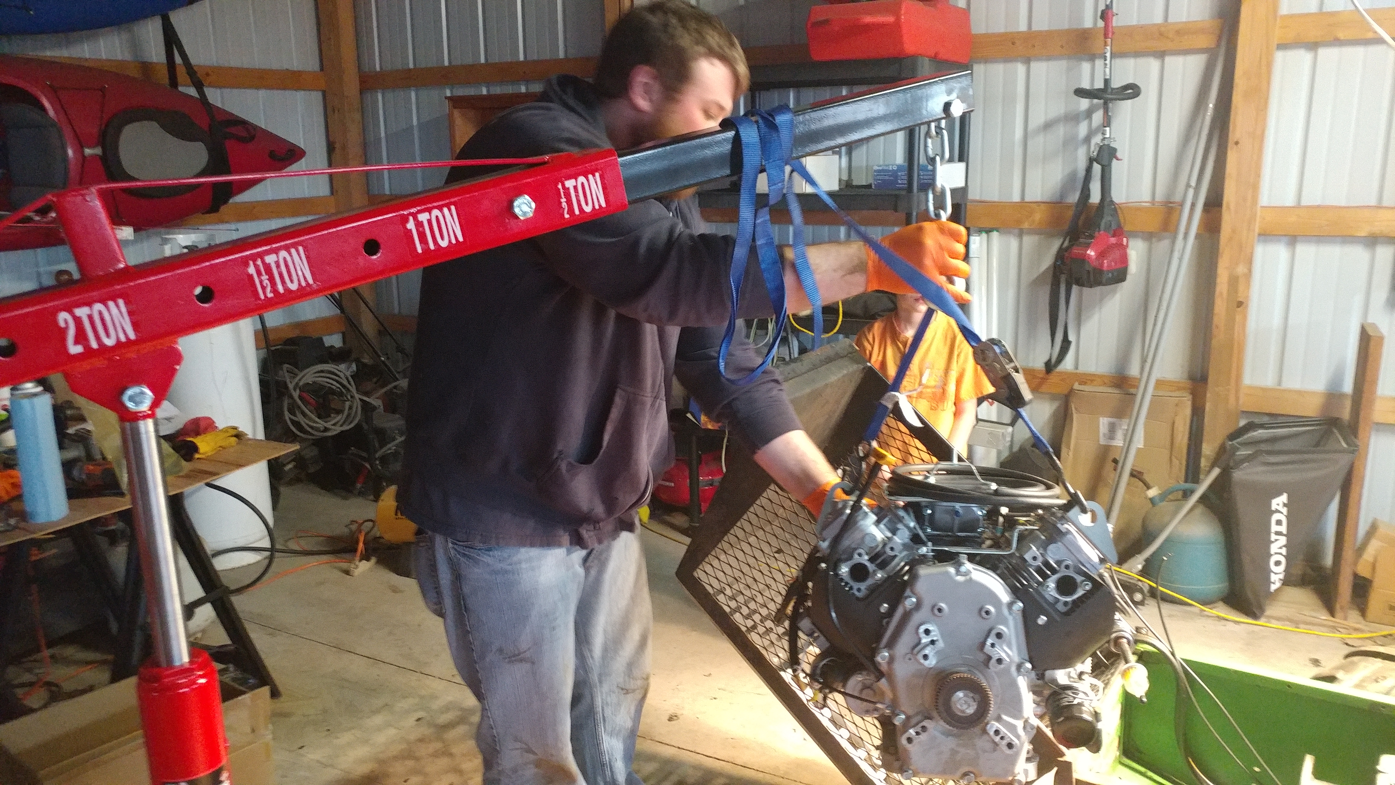

Before installing the engine, we wanted to install the longer fuel line purchased at the dealer so we could easily route in around the other side of the engine to minimize vapor lock.
We then dropped in the new engine using an engine lift from cheapo Harbor Freight taking care to align the coupling properly with the pump.

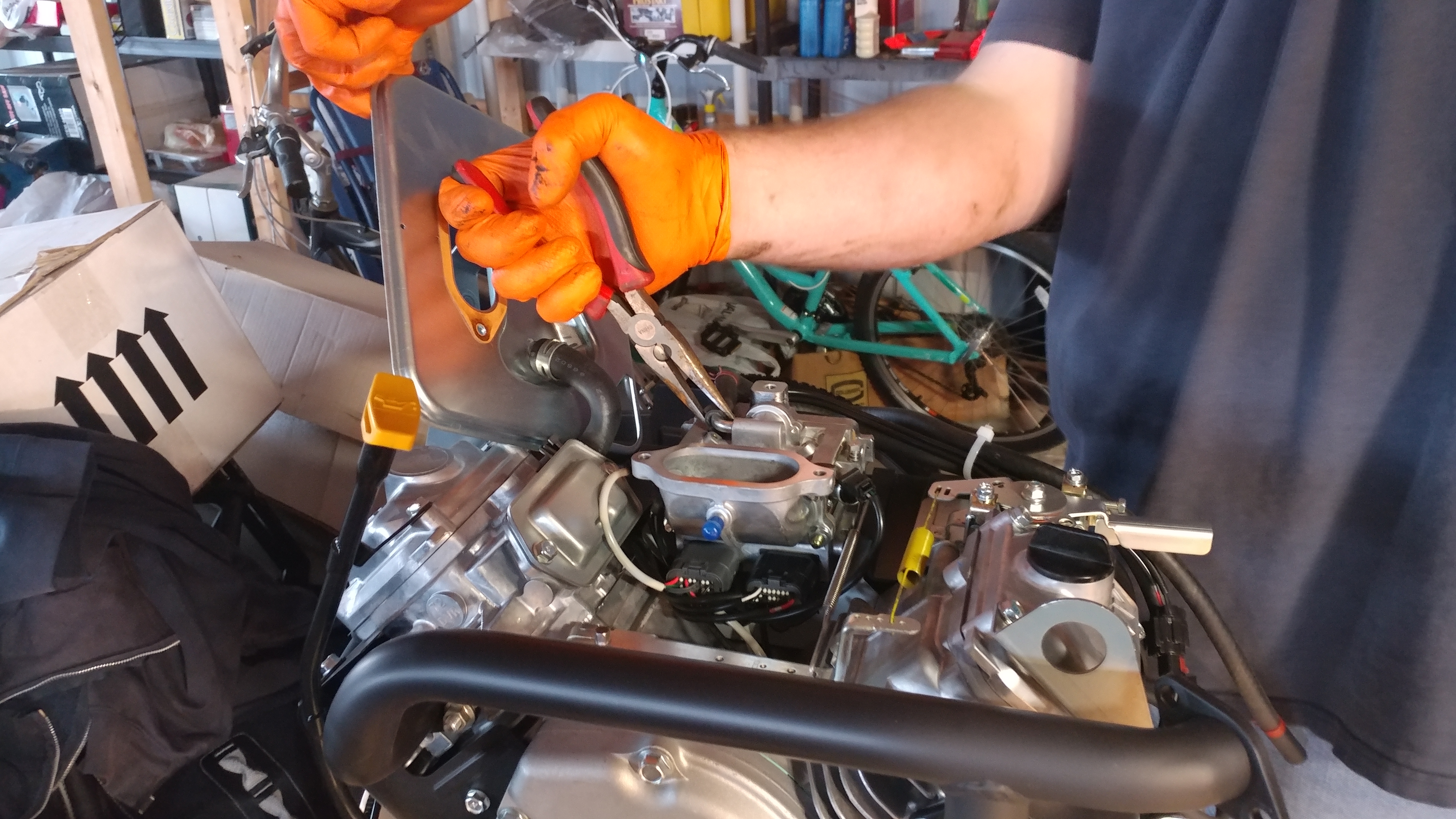

It pays to read the manual before doing too much. This is how we learned of the temperature cut off.
