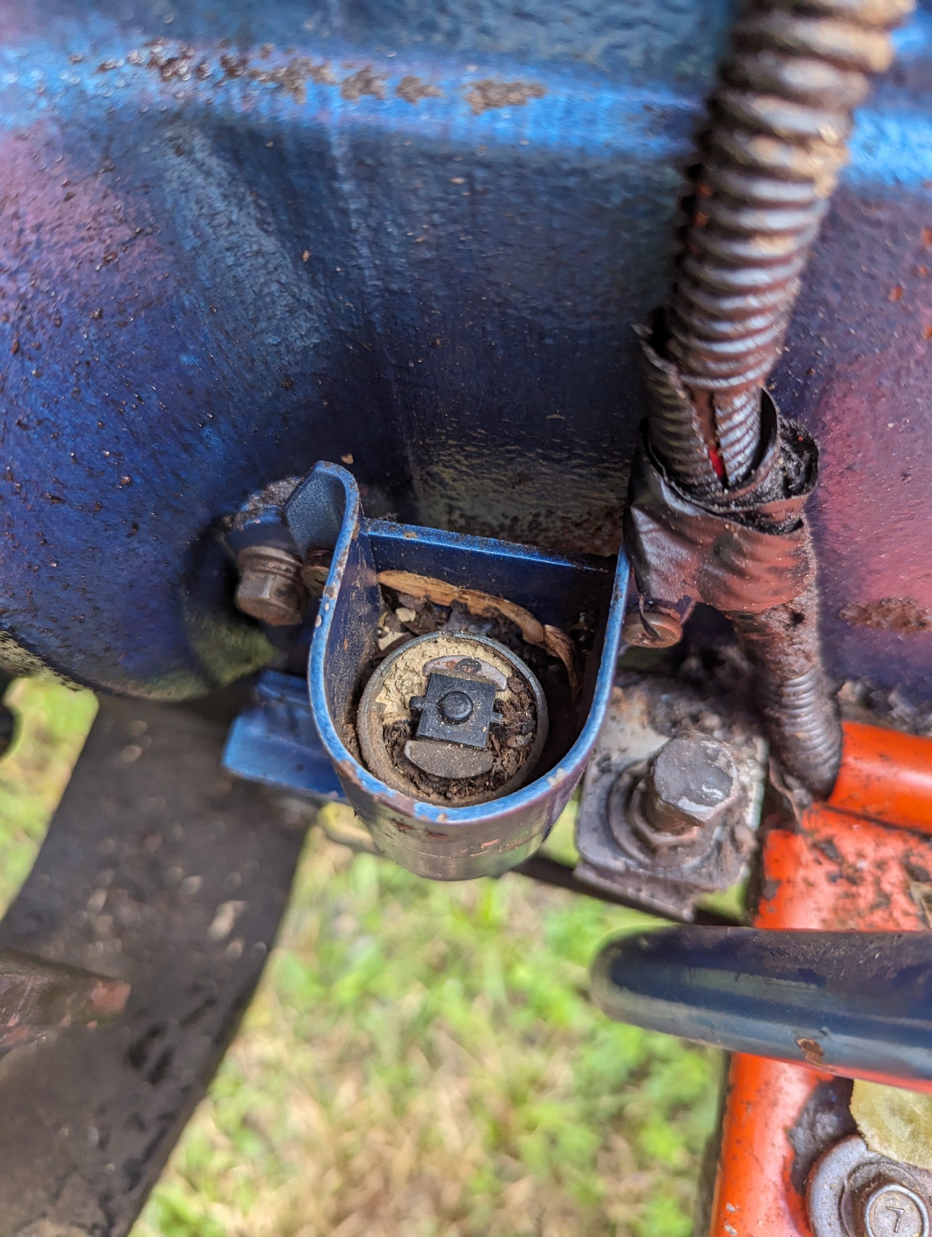

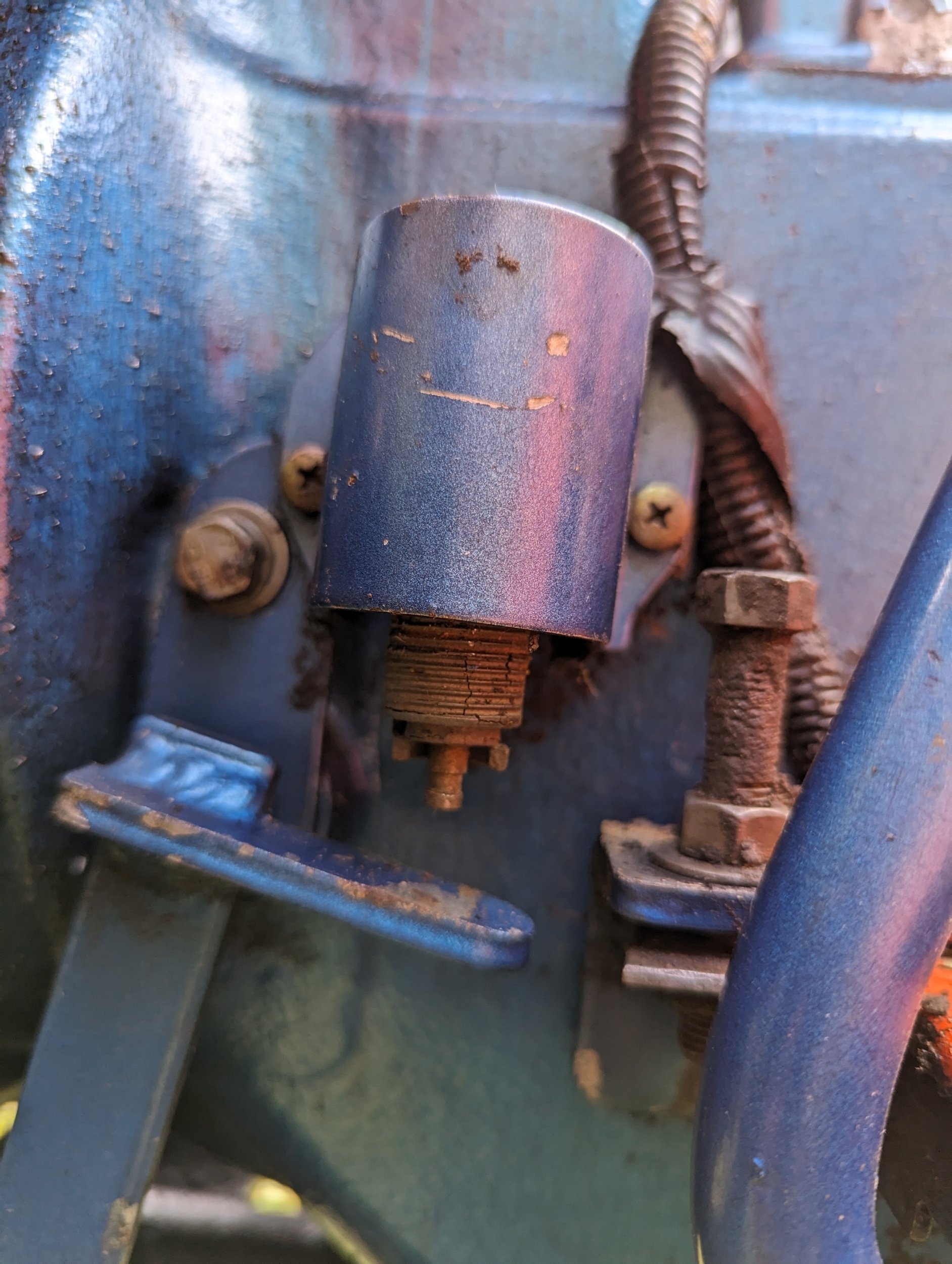

I noticed that on the clutch there is this contact, which does not make contact, not sure what it is?

Looks like a switch to make sure that the clutch is disengaged so that the tractor is not started in gear?
So when you pulled it with the truck, did the motor turn?
   / Replaced starter still issues
The motor seemed to turn, I had it in gear and out of gear and the wheels did not lock.
