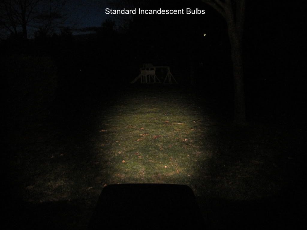

The photo and test session started with taking beam pattern photos at night of the standard original equipment incandescent bulbs. Figure 2a shows the results of the standard bulbs installed in the Wheel Horse and is the baseline for this comparison. The light beam pattern seems adequate for yard work and the light color is warm yellow, typical of halogen incandescent bulbs.

I next noticed the much larger beam pattern that the Trilliant® bulbs provided. You'll see in Figure 2b below that the Trilliant® light beam pattern extends both farther and wider compared to the incandescent bulbs in Figure 2a. If you study Figure 2b, you'll notice the landscape behind the swing set and three trees to the right that are visible; you can't see these details in Figure 2a. The bigger beam pattern is very beneficial because it illuminates more of the work area ahead and makes it less necessary to have to steer the tractor to the left or right to see what's in that direction.
Figure 2a: OEM Incandescent Bulbs
