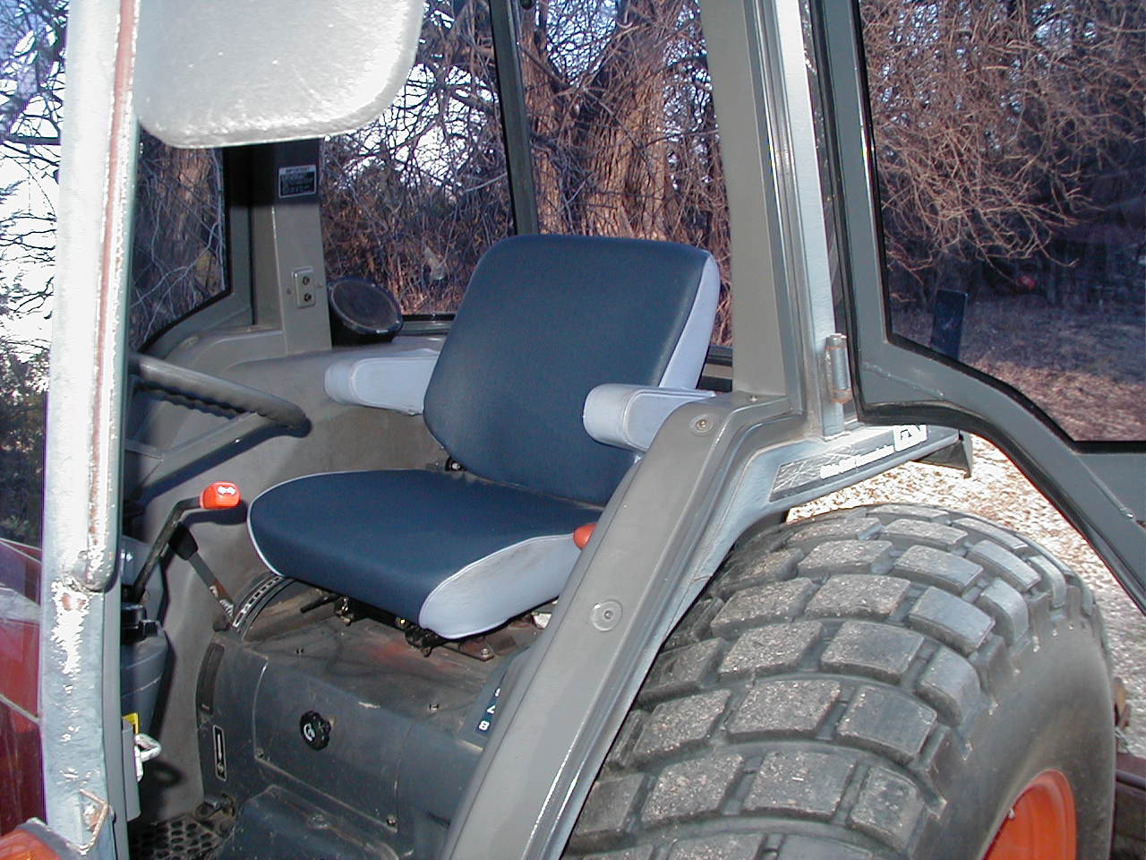

I put this in my L4200 a long time ago, it is a reclining Deluxe Kubota seat I found on Ebay... But I did need to mount it to the stock suspension base that came on the original seat.
It is toooooo comfortable I love it. KennyV
Can't beat those seats; tried the aftermarket ones and couldn't find a comfortable one.
