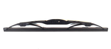

Hey All,
My rear blade is cooked and not doing it's job. A lot of my use is with the snowblower, and it's been windy during the winters leaving my using it more than I would have thought.
Anyways, when I looked the part up, bills had them at a very high price imo.
Does anyone know a blade I can get at O'reillys or Autozone etc.. that might fit instead? much rather pay $20-$40 and no shipping.
Thanks in advance, I sure appreciate any help on this!

It looks to me that it is no more than an automotive style arm and blade.
If I were in your shoes, I would measure the existing arm and blade and go to COSTCO or NAPA or an auto parts tore and see if an arm and blade of the same length will fit as well. Take the existing arm and blade with you.
I doubt Mahindra makes their wiper arms and blades.
Good luck.

That's what I was hoping to hear. I'll take it off tomorrow and make the rounds. Half our local stores just closed in the last month, I'll have to call around and make sure they are still open!

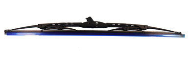

I've replaced just the rubber insert for around $6 each. Trico 47-600, 700, 800 fit 6, 7, 8mm wide metal carrier. Cut them to length with a wire cutter. Used them for 25yrs now. They last as long as oem.

Measure the width of the plastic part of the rubber blade; I got tired of trying to find refills and got them on ebay. 6mm inserts 26" long for busses were .99 a pair, cut to fit. I got six sets so I'm set for a long time.

Yes, you can get replacement blades at most any auto parts store. I've replaced mine twice since I bought my tractor. Just took them off and brought to auto parts and got new ones.

You'll find it, and at the lowest price @ rockauto.com
Example: I bought 2, 28" wipers for my MH from rockauto.com for $3.49 ea.
