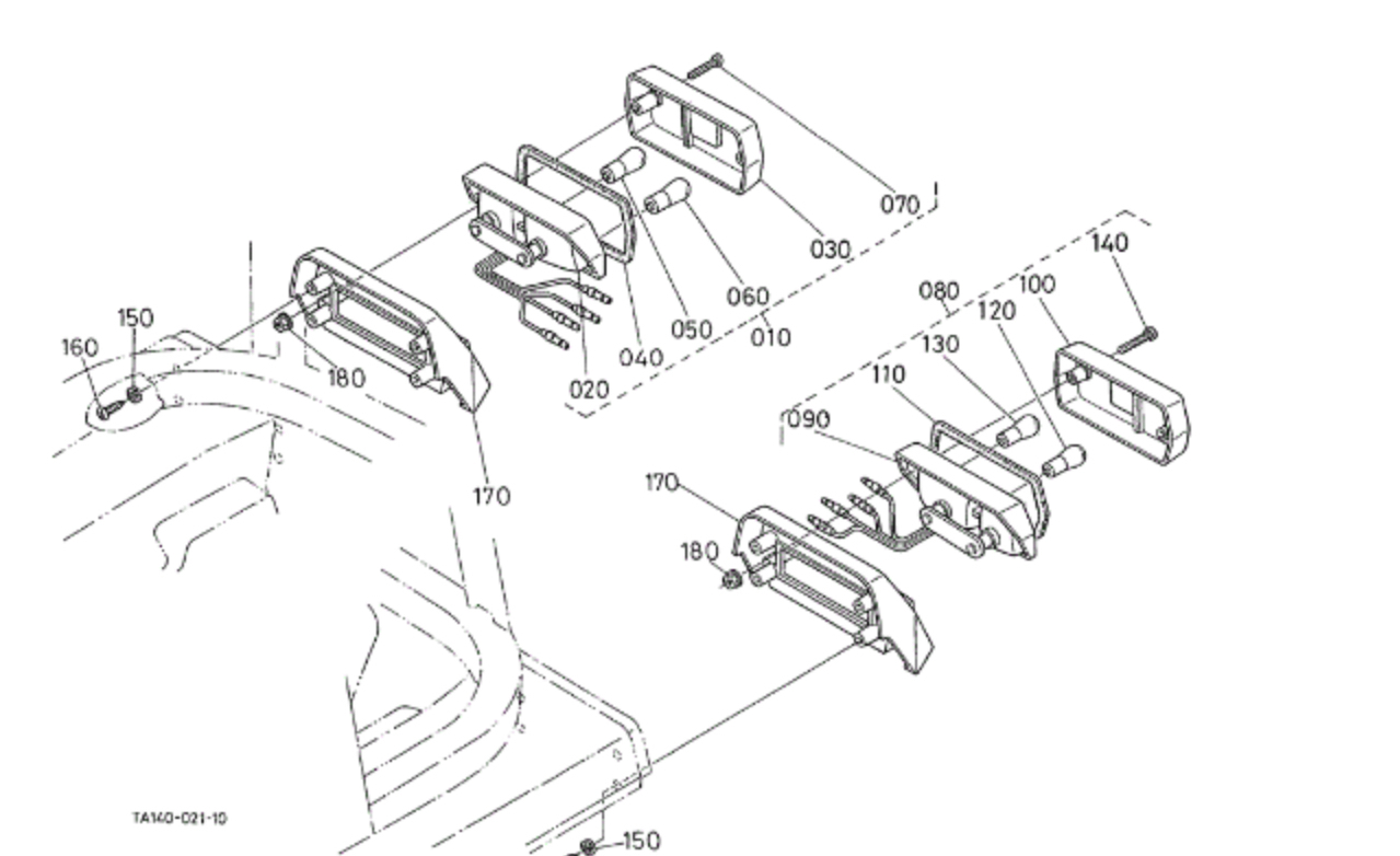

How do you replace the tail light bulb in a L3710D-HST-C Kubota? We can't get the light off to replace it.
   / Replacing bulb in tail light #2
If you are talking about the round flashing lights that are mounted on top of the fender, they usually have 2 lenses that snap on and off. One for front and one for back. A flat head screwdriver will typically do the trick. Just look for some sort of insert hole at the edge of the lens.
Hope this helps!!
   / Replacing bulb in tail light #3
If you are referring to the other rear set of lights, maybe they were modified by a previous owner because the parts diagram just shows 2 screws through the lens, and likely standard automotive type bulbs.
