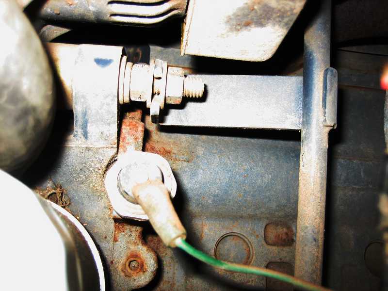

3. The lower alternator mounting bolt has 2 nuts on the end (photo below). These tend to "lock" the bolt, so you can't just loosen it by turning the head. Instead, loosen the nut on the right (which holds the dipstick brace) a few turns, then you can either loosen the second nut or loosen the bolt via the head. The alternator should now be movable.

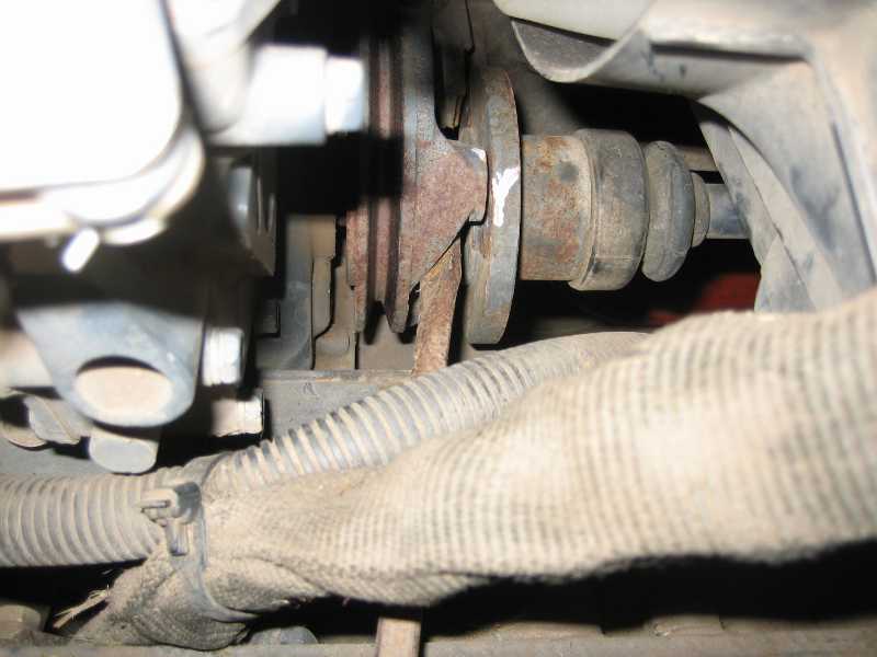

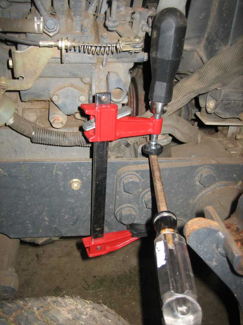

6. You're going to be loosening 3 bolts that hold the driveshaft to that pulley. The problem is, when you apply torque to the bolts, the engine crankshaft may turn, making it impossible to break the bolt loose. My solution was to wedge a hefty screwdriver between the openings in the driveshaft hub. Since I was working alone, I used a clamp to secure the screwdriver to the tractor frame. (Maybe if I had a helper, they could have just held the screwdriver.) You could also clamp a piece of angle iron to the frame so it engages a tooth of the flywheel at the front of the engine.

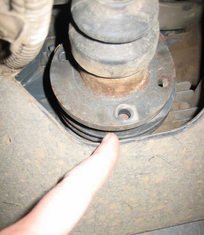

7. Put on your goggles and lay on your back under the tractor. Look forward toward the engine and you'll see an access opening in the bottom chassis pan. The driveshaft attachment is shown in the photo below. There are three bolts with 12 mm heads holding the driveshaft coupling to the engine. (In the photo the bolts are already removed and I'm pointing to one of the three attachment holes.) Loosen and remove the first bolt you can see. Then come back up, remove the screwdriver locking the hub and rotate the engine 1/3 of a turn. I don't recommend "bumping" the starter to do this, I found it easy and safest to just rotate the flywheel by hand at the front of the engine. Relock the driveshaft hub, crawl back under, loosen second bolt, and repeat for the third one too. Then take the screwdriver/bar off because it will get in the way.
8. The driveshaft which runs backward from the hub can then be compressed by pulling on the shaft by hand (don't pull on the rubber boot or it might tear). At this point, I got help from my wife. I held the shaft compressed, and asked her to yank the belt free through the opening between the driveshaft and the pulley.

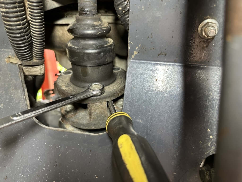

4 - On the drive shaft, I found an easier method that doesn't involve using a clamp or having to move back and forth from under the tractor to reaching in from the top. First, for turning the shaft, I used the torque from the wrench to turn the shaft. I put my wrench on one of the bolts on the drive shaft connector and turned it - but instead of turning the bolt, it turned the shaft. That's what I wanted. Then I put the screwdriver in so the shaft wedged in the connector and against the edge of the opening to access the connector:
Again, in case I wasn't clear above, I put the wrench on the bolt and turned it. That turned the drive shaft until the bolt was easily accessible, then, as the rectangular metal "post" on the connector came around, I put my screwdriver in so it wedged between the edge of the access opening and the connector. That held it in place. I was able to do something similar when reconnecting the drive shaft. The wire looms there may be from my modifications for adding work lights on the back of my tractor, so they may not be on your tractor.
