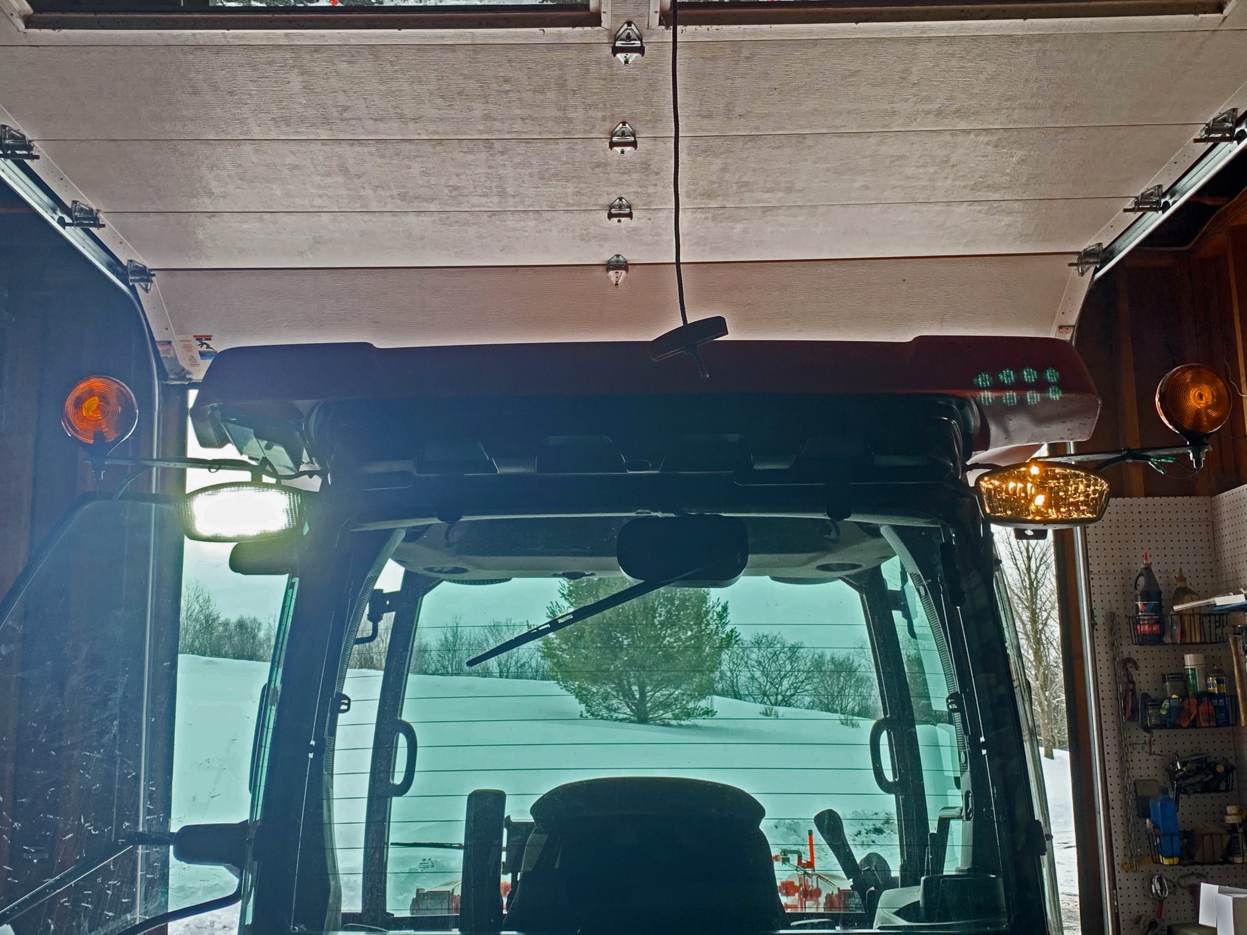

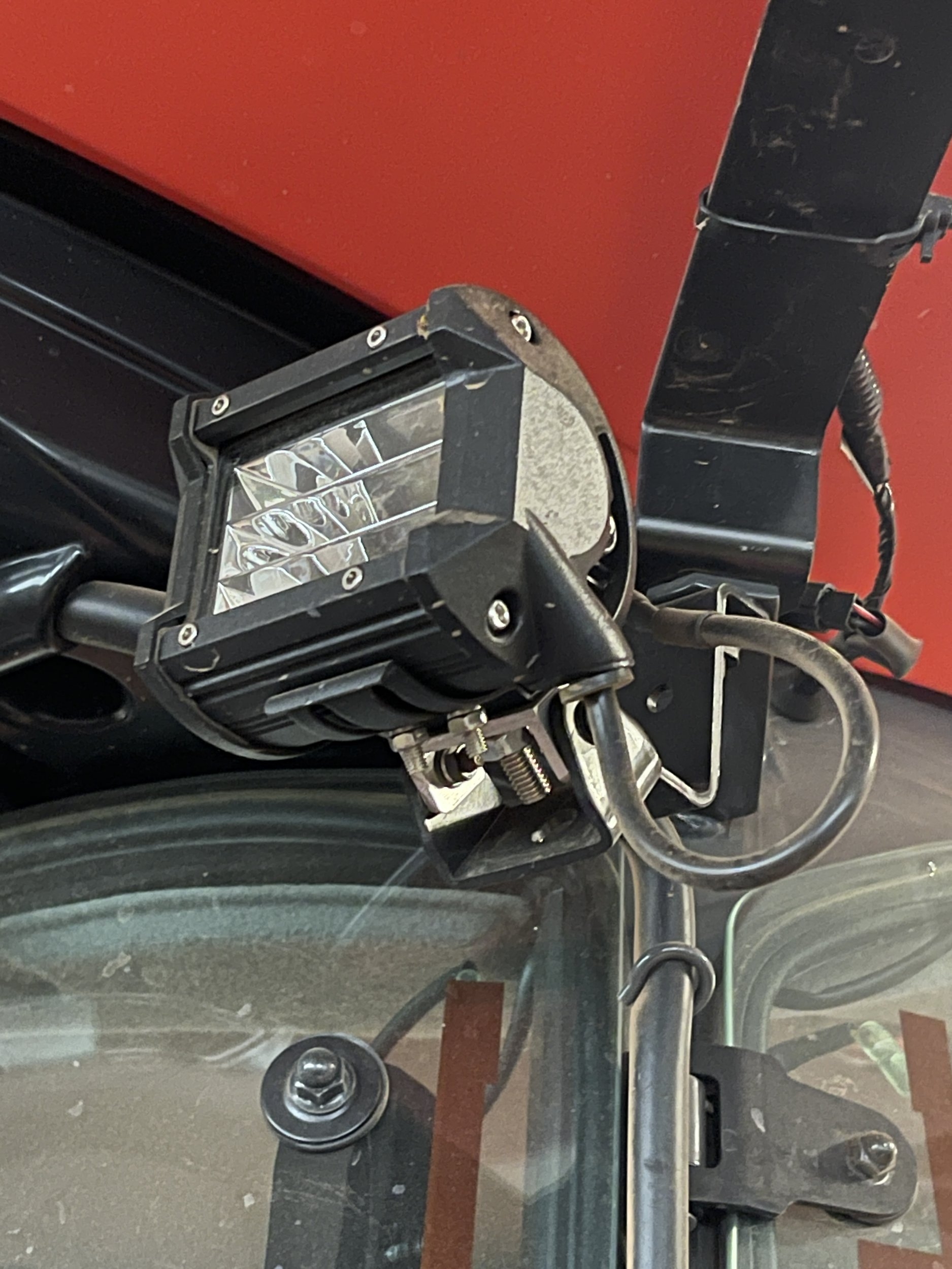

I put (4) 55w cab mounted led spot / flood lights on my L4060, and they turn night into day. I bought them on Amazon for maybe $20 a piece 6 years ago and they have been very reliable.
Not quite plug and play, as I had to solder the connections and slightly bend the OEM bracket.

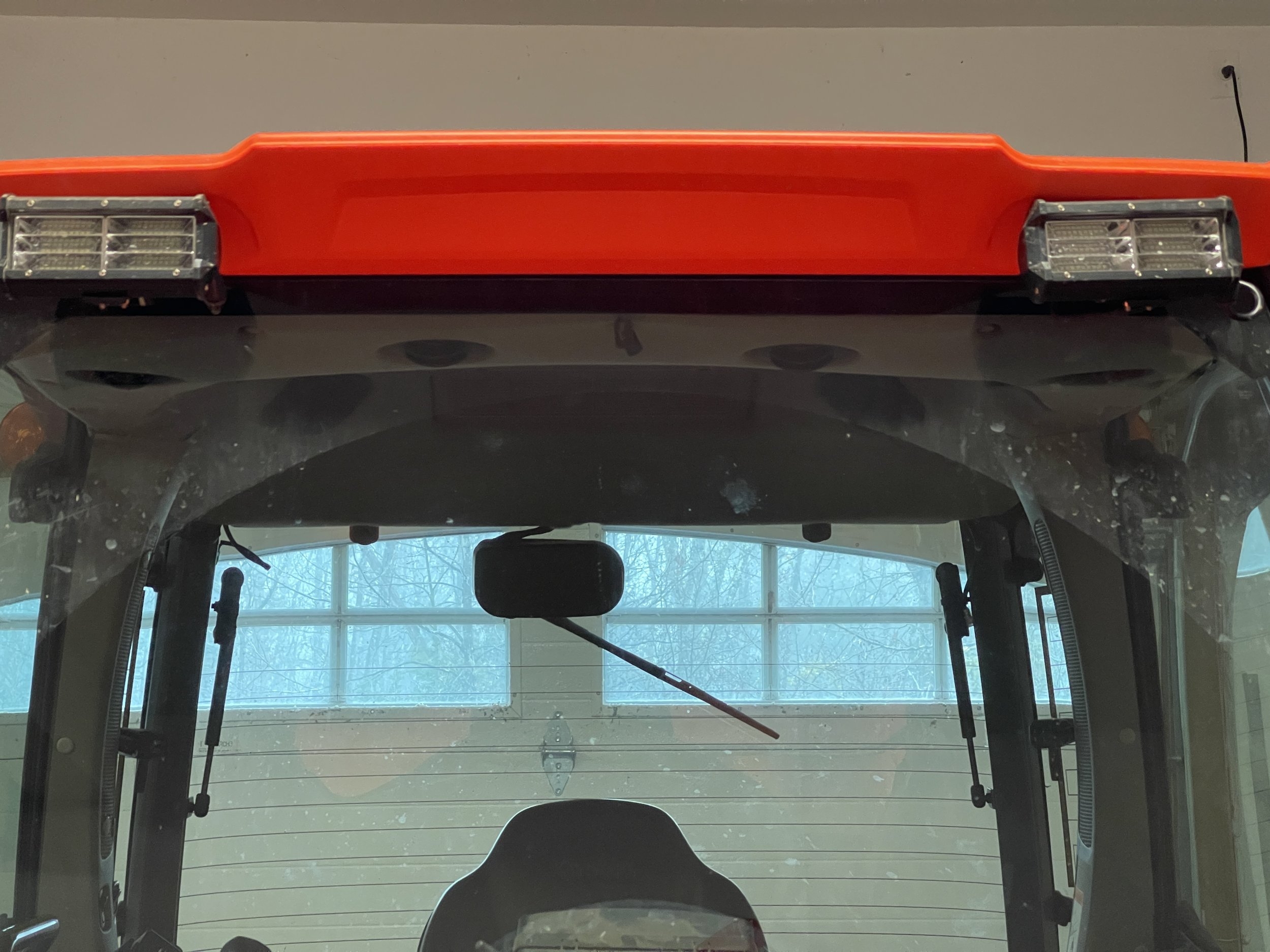

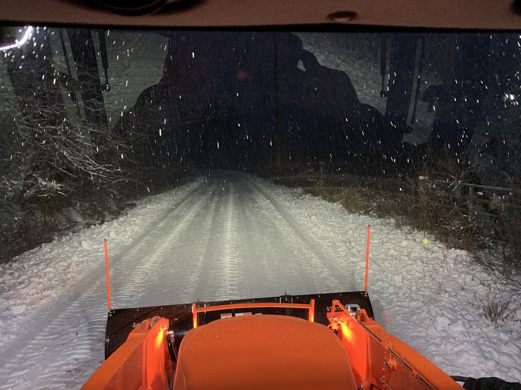

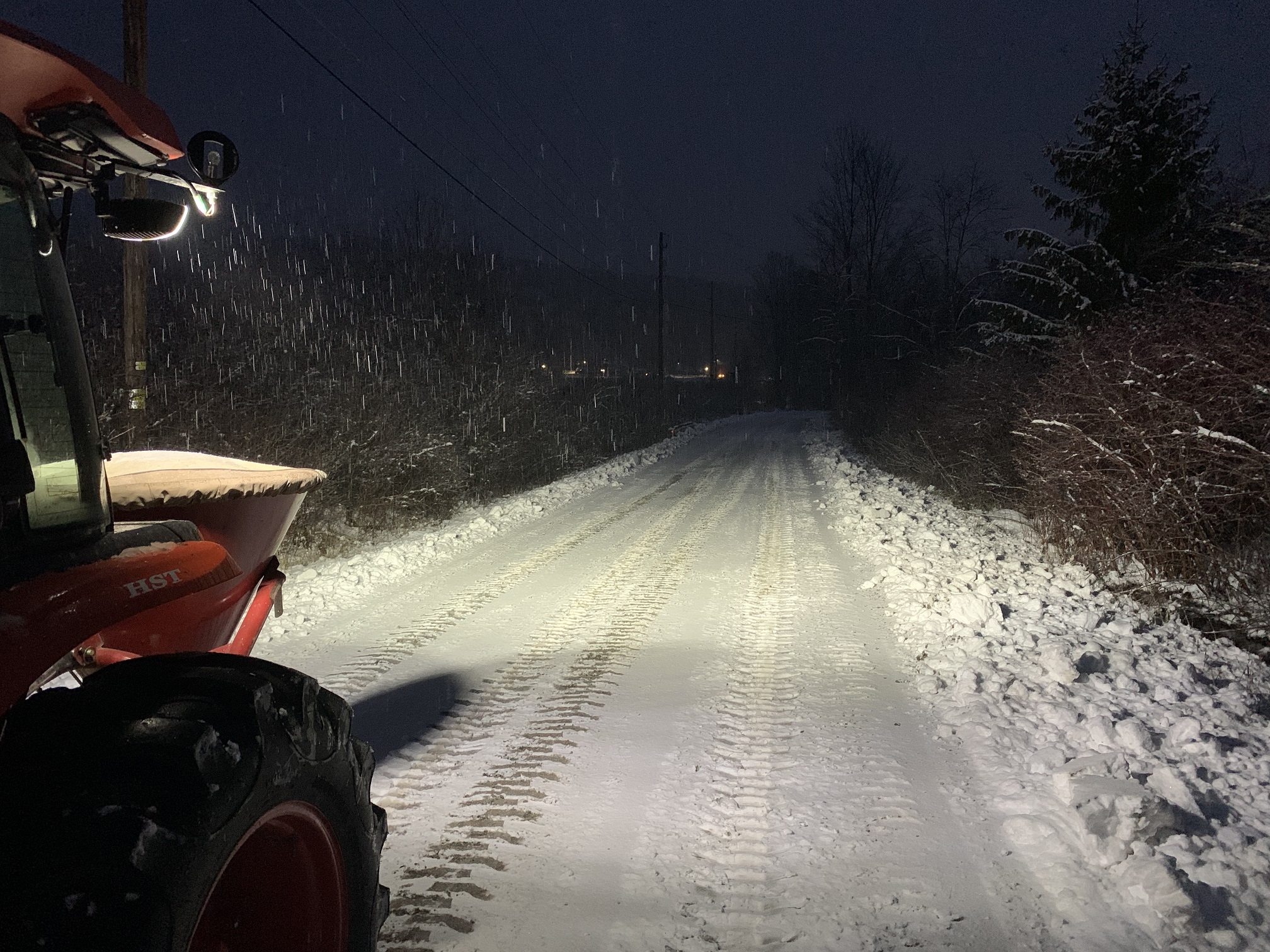

The Tiger TL3240 LED lights are a direct plug & play replacement for those woefully inadequate Kubota OEM work lights. Rather than fool around with changing mounting brackets & connectors, I bit the bullet and bought four TL3240's for my L6060HSTC. It took about 20 minutes to change all four. I got them on sale through Amazon for $79 each. That was back in 2020 though. I see the price has gone up considerably since then. To me anyway, it was worth every penny.
They throw 5 times the light using less than half the current of the OEM Halogen lights.
I do a lot of night plowing and the LED's make a huge difference:
I could easily have purchased cheaper lights and done the mods myself, but at this stage of life, my time is more valuable.

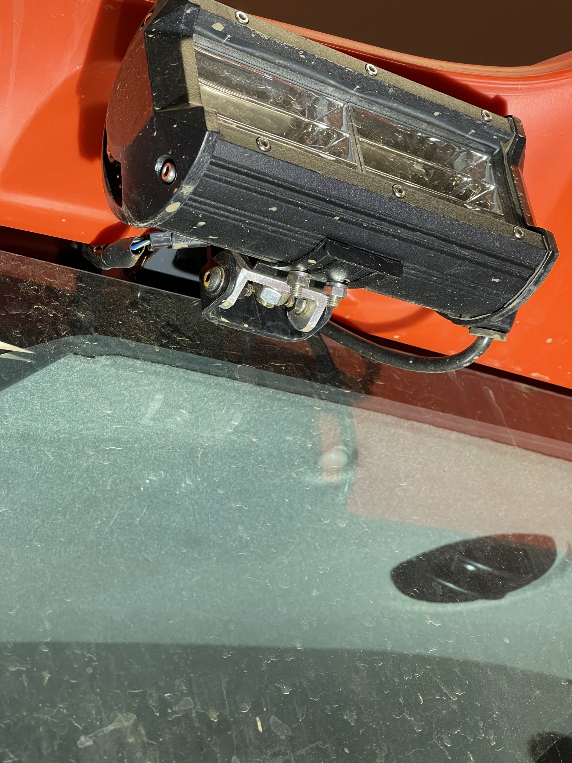

This is probably one of the most common modifications you'll see. You will find plenty of less expensive LED choices on Amazon and eBay. I did mine a few years ago. I think the fronts are roughly of the same wattage as the previous poster. With regard to current draw, LEDs always draw lower power than halogens for similar or greater
lumens. I used aluminum C channel to fashion new bracket adapters(doesn't rust, easy to cut and drill). Otherwise,you just need to do some 12v wiring in order to put on new waterproof connectors.
   / Replacing L6060 OEM lights with LEDs #7
I used aluminum C channel to fashion new brackets (doesn't rust, easy to cut and drill). Otherwise,you just need to do some 12v wiring in order to put on new waterproof connectors.

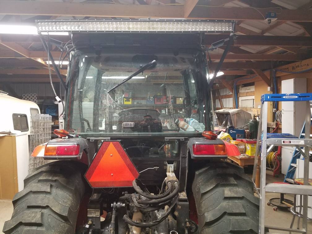

My light bars are overkill. To much effort to weld up heavier brackets & put in a new fuse panel with all the wiring. The time i do something similar some pods are going in with stock brackets & wiring.

plus one for the tl3240 tiger lights. got mine from larsen lights I did just the back because they are a little expensive at about 100$ but I regret it. I should have gotten all four because now the back is well lit but the front sucks.
totally plug and play. took longer to figure out how to get the OEM connector to unplug than to install the lights.
