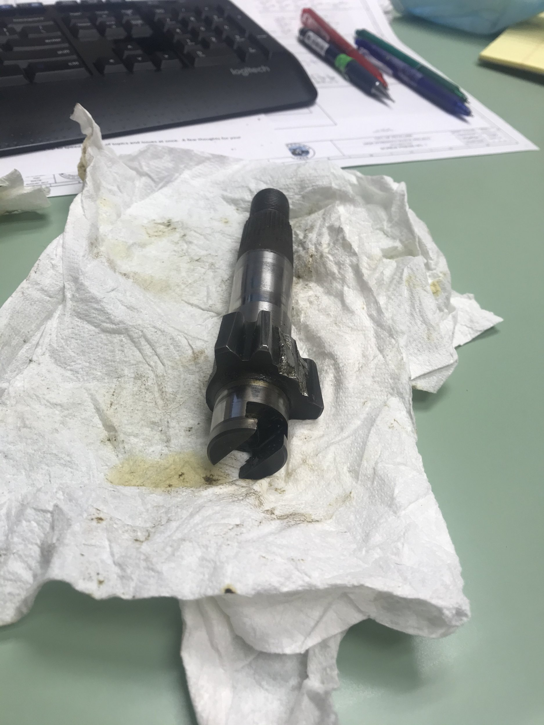

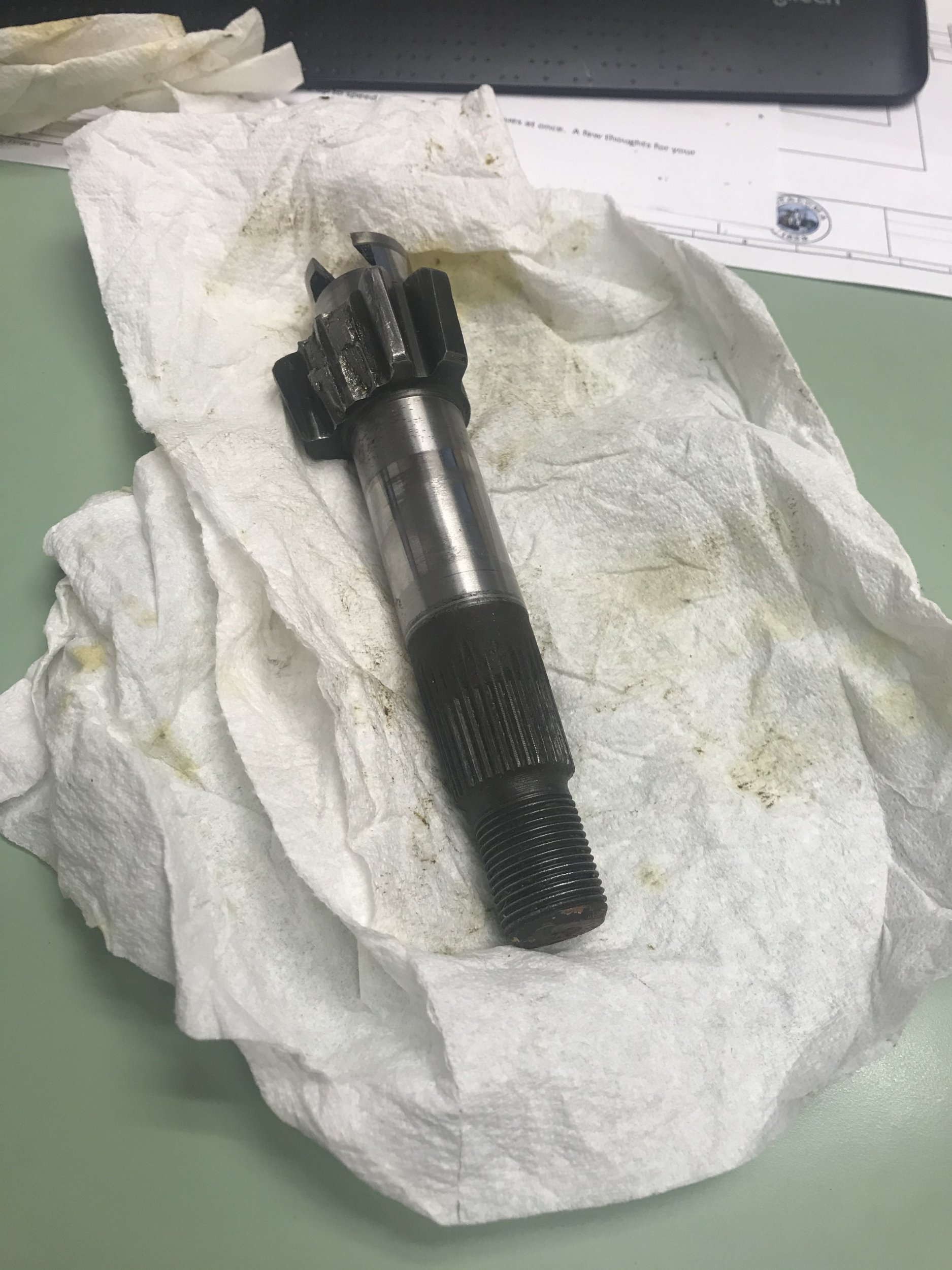

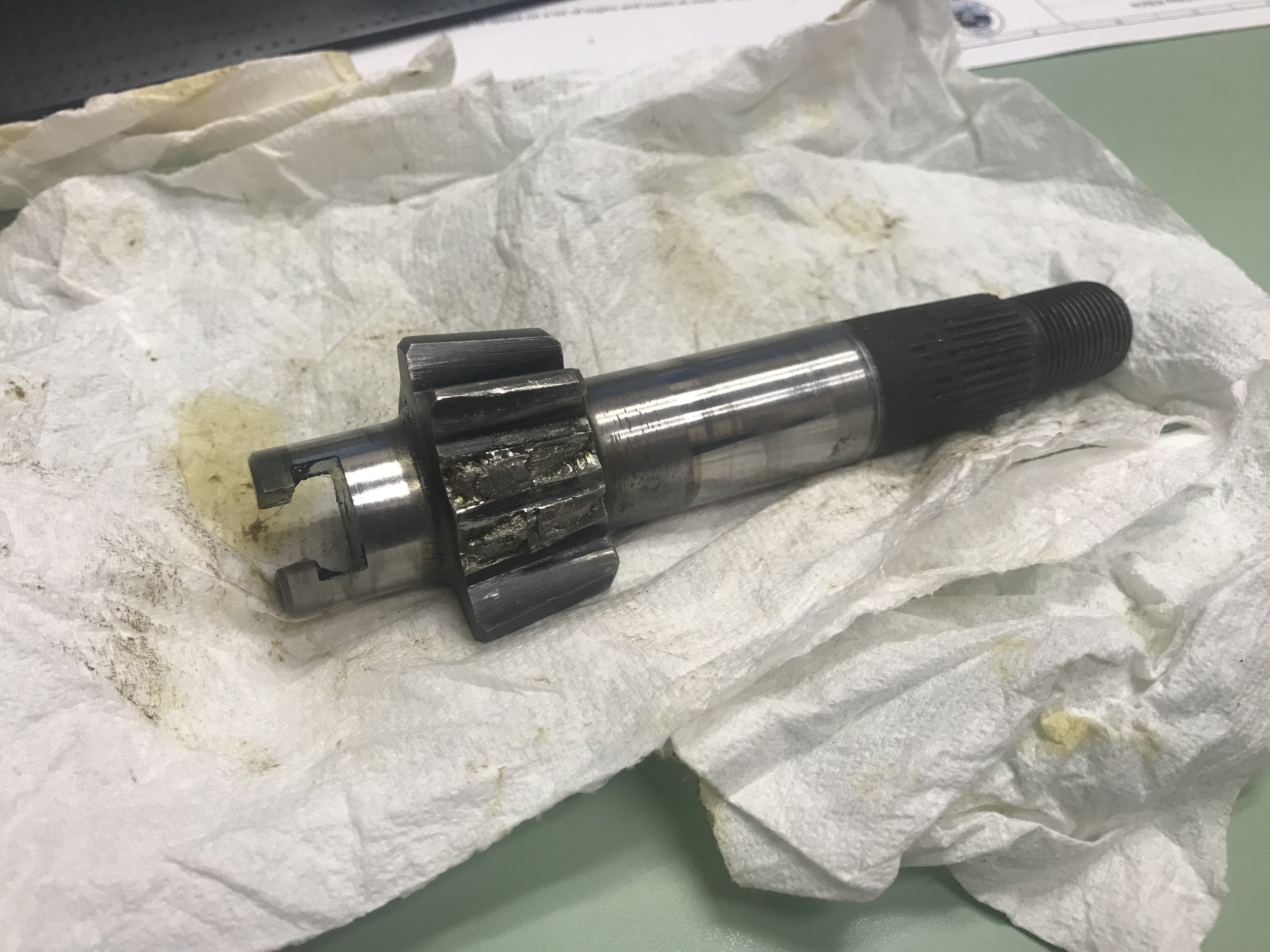

Hi All,
I recently bought a Yanmar 1300D (4x4) red hood with a broken sector shaft (two interior gears are sheared off, see attached pics) thinking it would be a simple enough part to replace.... I was sorely mistaken! Would really appreciate any suggestions/insights others with more experience might have to offer.
Basic issue: Several tractor part companies offer a "replacement" sector shaft for the stated model of my tractor, which look very similar, but the shaft that they stock is narrower in diameter than the one that broke on my tractor. They suggested that perhaps since it is a 4x4 that it was manufactured with a heftier shaft. I cannot seem to find a premanufactured shaft, even from other make/models, that have same dimensions.
Any suggestions on where else to check and/or has anyone successfully swapped out the whole steering box on this model with a steering box from another make/model? If so, what did you use? In addition to pics of the broken shaft, I also attached a dimensioned sketch, for what it's worth.

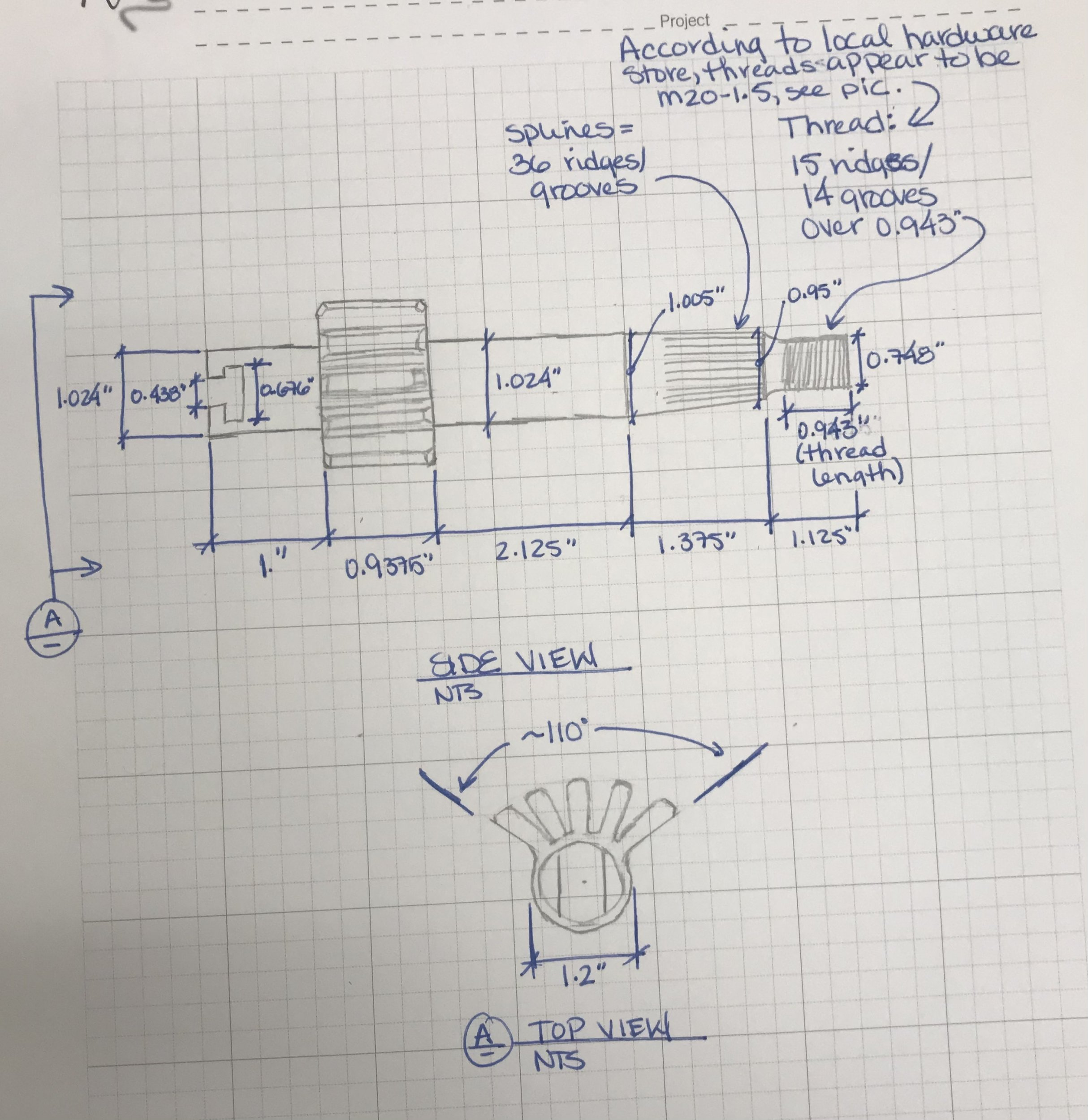

I really like your drawing. :)
As for the dimensions, Yanmar did/does everything in METRIC. And most machine shops can do CNC metric really easy too.

Thanks, Winston! I'll give them a try. TBH, it looks like the same one listed on other sites, with the usual list of compatible model numbers. I think the issue is the 1300 Red is listed, but not the 1300D (and it's my understanding from this new world of Yanmar language I'm learning that "D" stands for 4x4 - which might be part of the problem I'm having, no one seems to list parts for the 4x4 model). But please correct me if I'm wrong on the "D" interpretation!

Generally, except for the front axle and transmission output, the 'D' (4x4) versions are identical in nearly everything. Your steering box might be unique - but I doubt it.
   / Replacing Sector Shaft on 1300D Red Hood
California, thanks for the clarification. If that's the case, then I don't know what the heck is going on. Maybe a prior owner swapped out the steering box at some point?
   / Replacing Sector Shaft on 1300D Red Hood #8
Could be a Frankensteinmar. A unique tractor assembled from whatever was in the bin that a VN refurb factory bought from a scrapyard. With a few components made by by a kid who was handed a file and told he has a week to fabricate an unobtainable part. :eek:
Ok, that's worst case. More likely, if that steering box never appears in the YM1300 Parts Manual then it came off a very similar Yanmar and can be replaced when you figure out what it came from.
Worst (most expensive) case, there are CNC shops that can fabricate anything.
