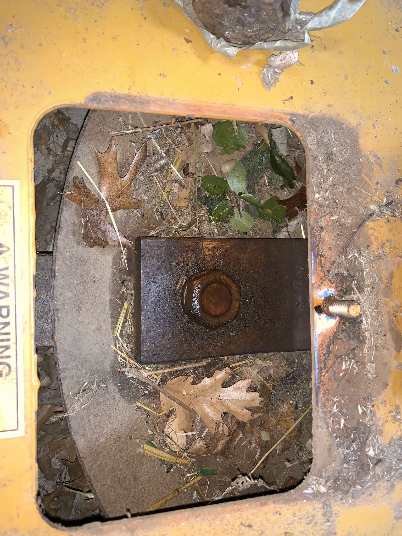

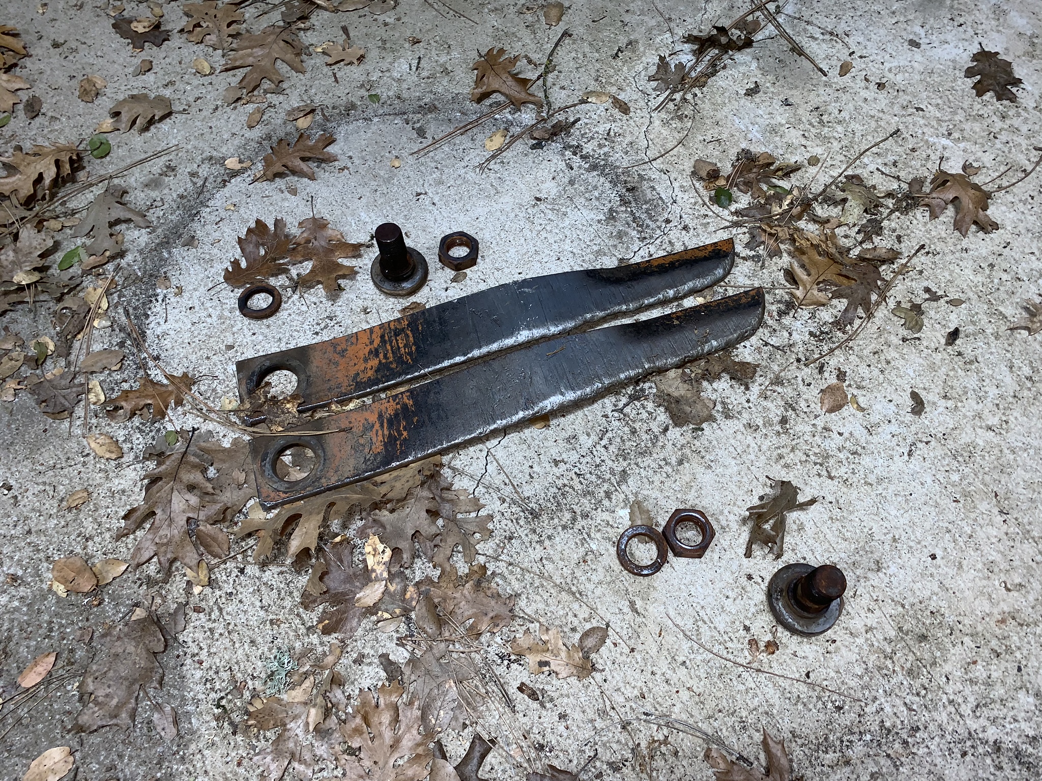

A stitch in time saves nine. First I am no expert. My problem was a Woods BB 60 mower that was neglected and needed blades attended too. I searched the Web for advice. I appreciate the shared knowledge , but was looking for more specifics. Here is my contribution to the knowledge base from my quest.
First, Blaster or the equivalent is a great product. The nut was soaked over night.

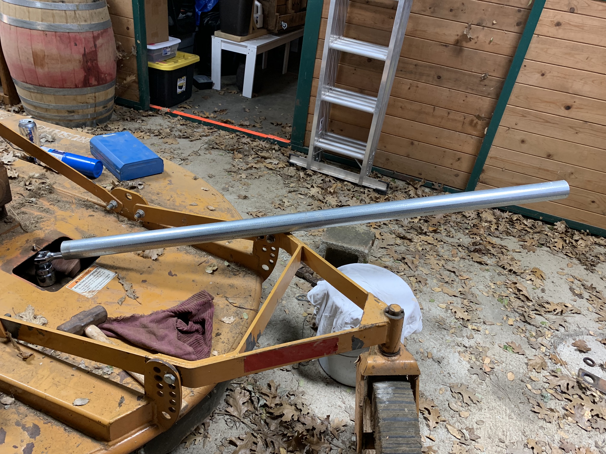

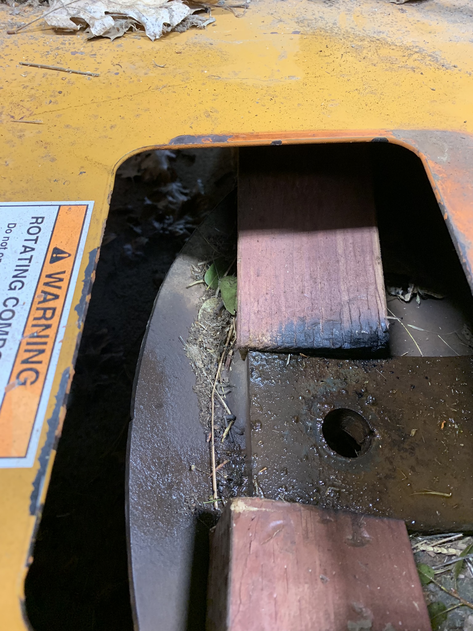

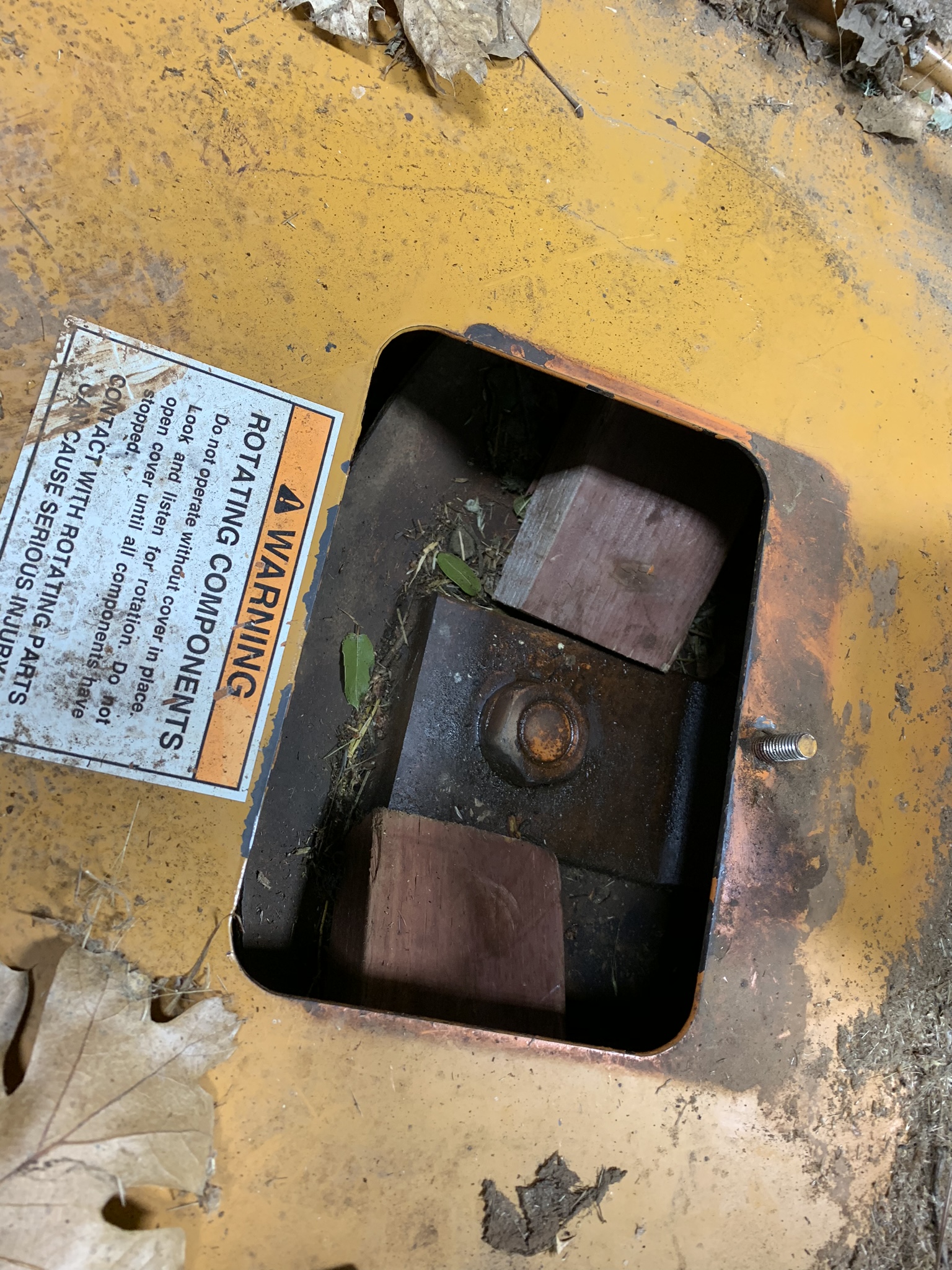

The most helpful advice is to secure the blade to negate the spin when using breaker bar to remove bolt. I found placing two 2x4 cut to length to wedge the support bar

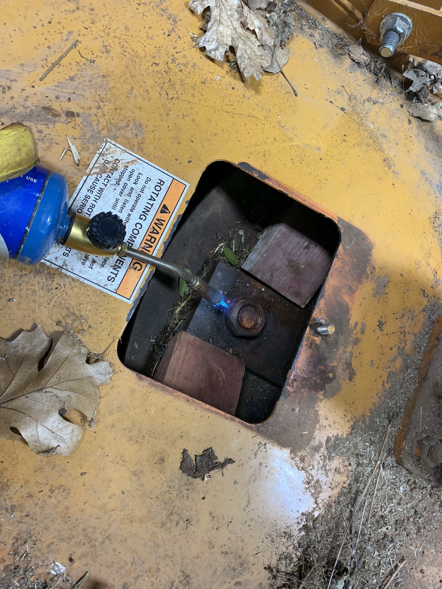

Heat the nut, a good 15 min
Maximize torque

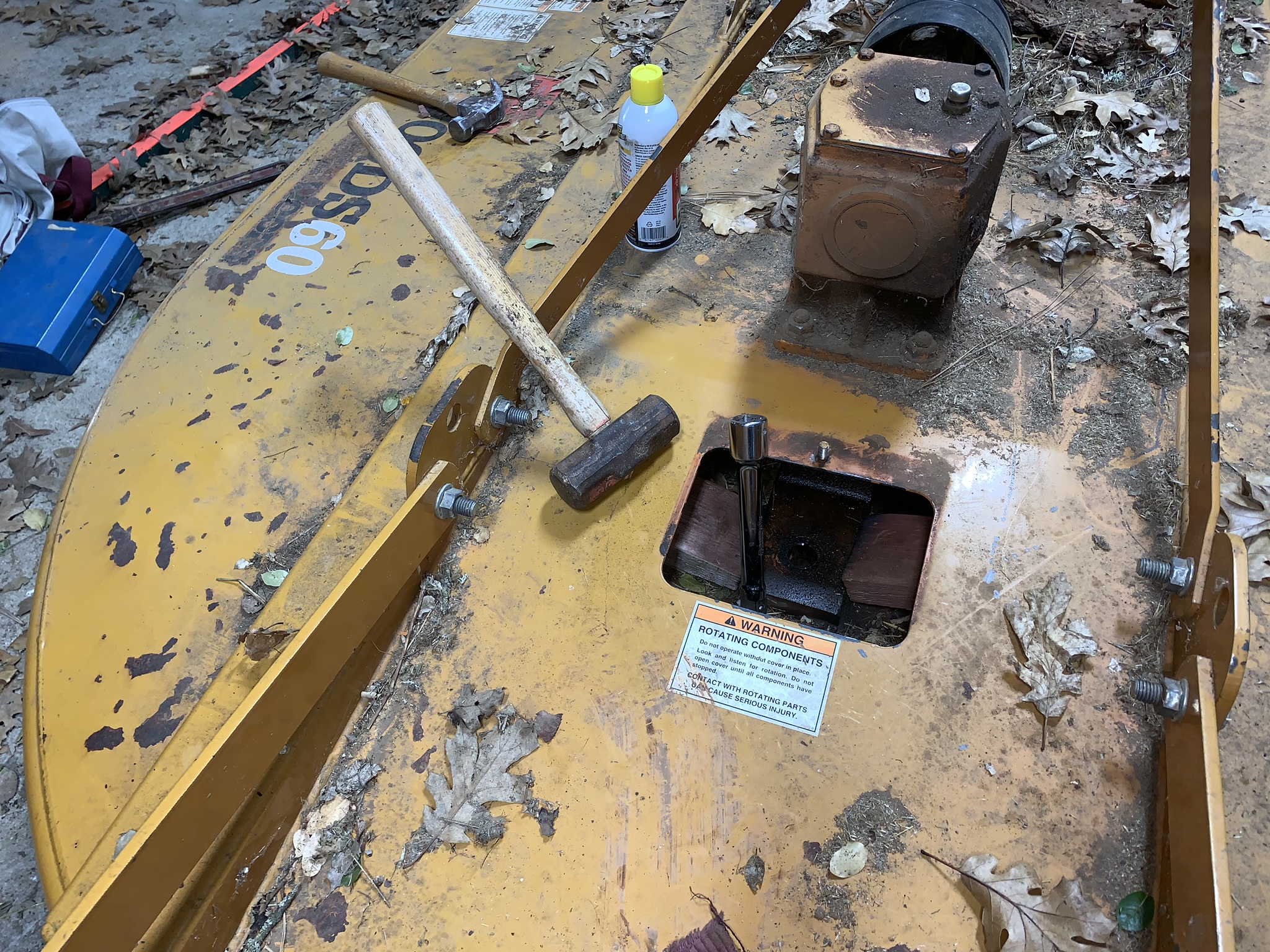

Apply more Blaster and clean build up around pin. Used hand sledge and appropriate rod to remove pin
Voila

Consider in the future investing in a torque multiplier wrench. Was what all heavy equipment and truck tire people used for decades.
Torque Multiplier Lug Wrench, 1:78 Ratio, Heavy-Duty at EZLugWrench.com - YouTube
They easily generate over 1,000 lb-ft of torque.
When looking for one pay attention to their internal gear ratio. The higher the ratio the more power.

Ummm... I could have used that last year for a neighbor's mower blade that we couldn't get off with 450 ft/lb air tools (average homeowner variety). We ended up just replacing the whole spindle. Tried heat, pbBlaster, bars, etc. All to no avail.
Looks like a good tool to have around.

I picked up a a 4:1 torque multiplier for $10 at local flea market... Similar to one below... Good to 1000 ft-lbs with max of 250 ft-lbs input...
Also be sure when tightening nut you meet torque specs, think someplace I read some go as much as 350 (+/-) ft-lbs...
