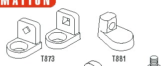

I went out to check the fluids on my TC25D this morning and had to use a piece of wood as a pry bar to get the hood opened! /forums/images/graemlins/shocked.gif There I found the battery a 'cottage cheese' mess. /forums/images/graemlins/frown.gif I had cleaned it off last fall, so over the winter, during the few times I used the tractor, this occurred.
I decided I will replace this original, gassy /forums/images/graemlins/mad.gif, battery with an AGM battery from BatteryStuff.com. Based upon the size of the battery area, it looks like there are two potential replacements. Measurements are LWH in inches.
An 8A22NF at 9.38 x 5.50 x 9.25. Post type T881
An 8AU1 at 7.75 x 5.13 x 7.25. Post type T873
Orig. battery is 8.80 x 5.25 x 8.63.
The 2 problems will be;
1. The original battery has posts whereas the 2 replacement batteries do not. See attached picture.
2. The taller battery will require longer hold down J bolts.
Has anyone replaced the battery in their Boomer?
Are there adapters that would allow me to connect the original cables to the new battery or do I have to replace the cables too?
Where can I get the longer J bolts?

   / Replacing the Battery on a TC25D
Thanks to all who replied! /forums/images/graemlins/smile.gif
tc35dforme
<font color="blue">They have a reverse post ( type 34R I think ) that fits well.</font>
The 35D is Class III Boomer, so there's room for a 34R. My Class II only has 5 5/8" inches between the rear (closest to the radiator) lip that locates the battery and the hood latch mechanism at the front.
I checked all the batteries at the link you included and none of the Optimas will fit, since they're all 6.8" wide. /forums/images/graemlins/frown.gif
